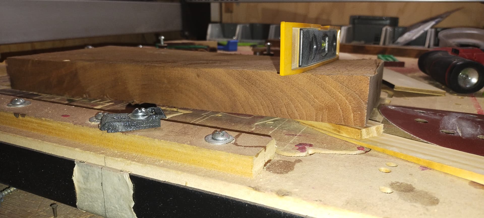

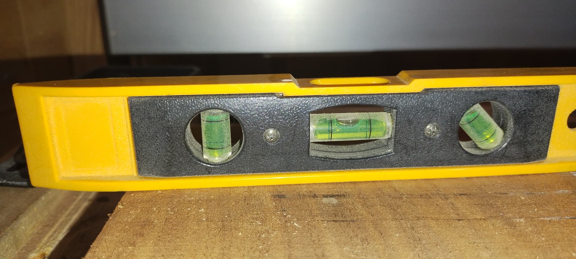

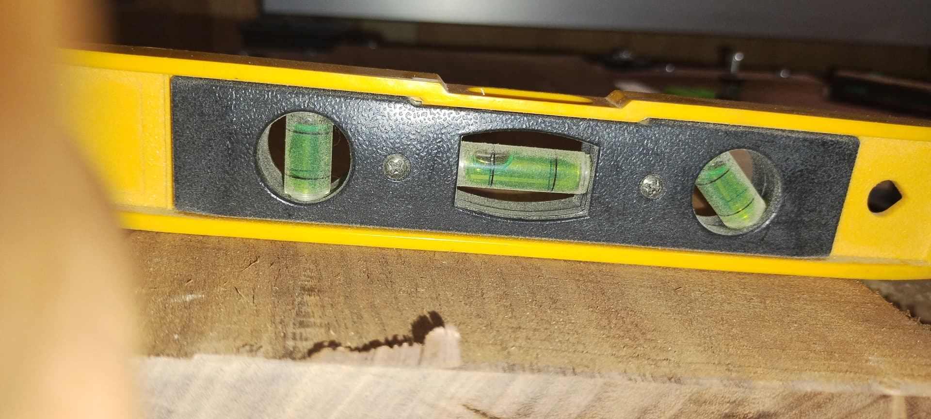

Hey guys, does anyone know of any tricks that can help me try to flatten a crooked board? I’ve never really done it before, but have watched a ton of videos where people try to shim it out to level it up, but with my board, I can only get it level on ONE side. I go to the left, get it level, shim the right, but the right is not level. I go to the right, get it level, shim the left, then the left is not level. Is it possible the board is just too crooked? Any help or advice would be appreciated. Thanks

basically, shim, remove wood from one side, flip, remove from the other — try to remove the same amount from both sides.
Aaaaah, I think I see what you are getting at, don’t try to get it perfectly flat the first time. I will give it a shot. Hey thanks
Bondo!!! I put squares of 2" tape on the spoilboard & a blob of bondo on each square. Gently press the board onto the bondo & let it harden. Machine the top, flip, machine the bottom.
The big thing is the first cut you make will determine the plane of the final board, so orienting it so that the minimum amount of material is removed will help to maximize/preserve the final thickness.
Think a u shape as a cupped board, if you clamped down on one side or the other of the rounded side, then the other would be way up in the air, and when flattened, there would not be much left.
Good point, I usually try to start with the cupped side down, or just visually balance it when setting it down. If it’s twisted, try to balance the 2 opposite corners that sit above the table, as it rocks on the other 2 corners.
