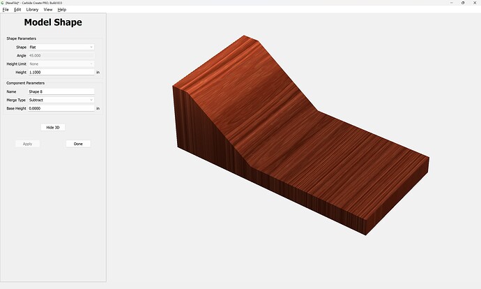

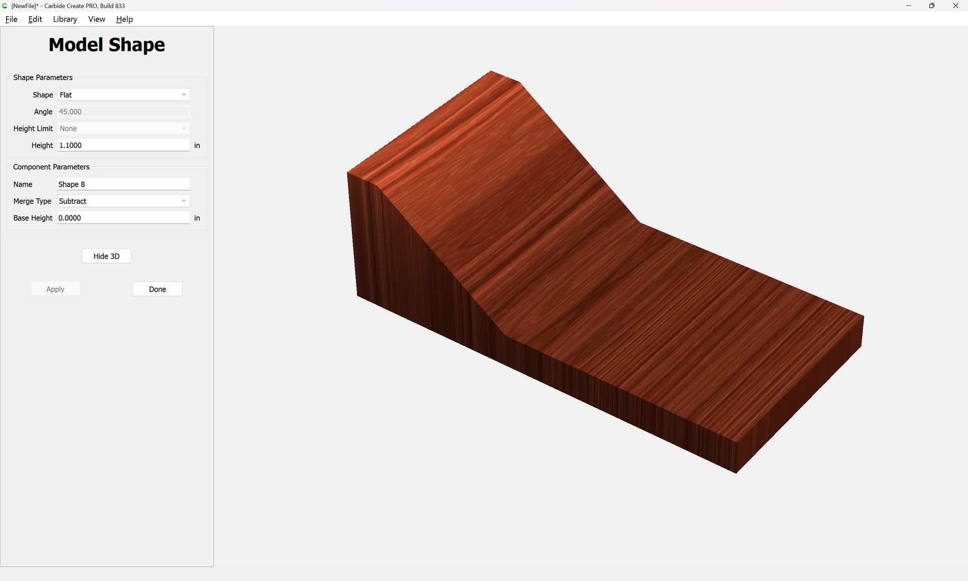

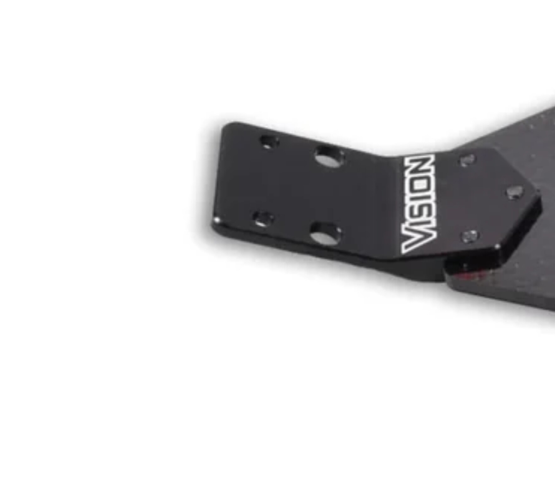

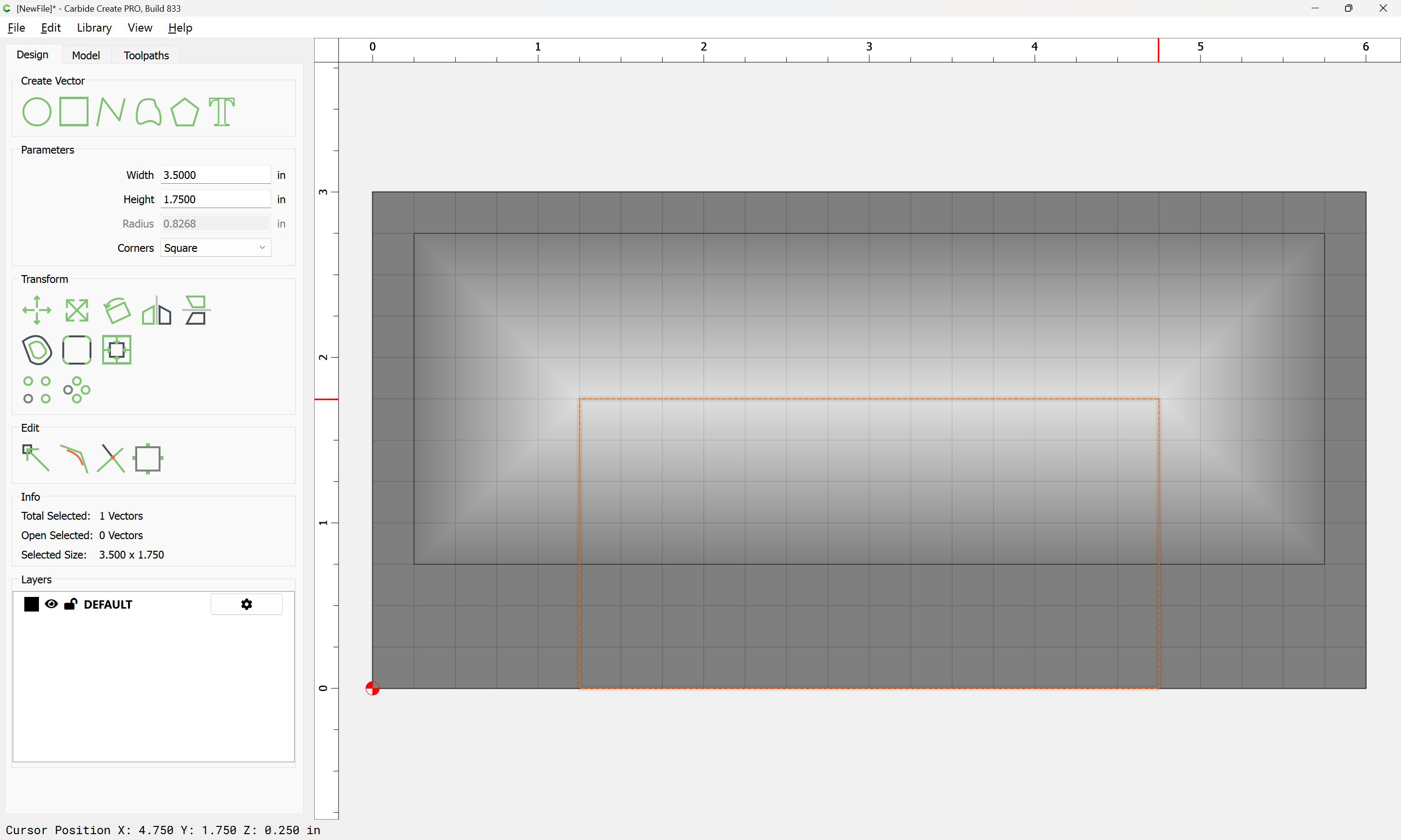

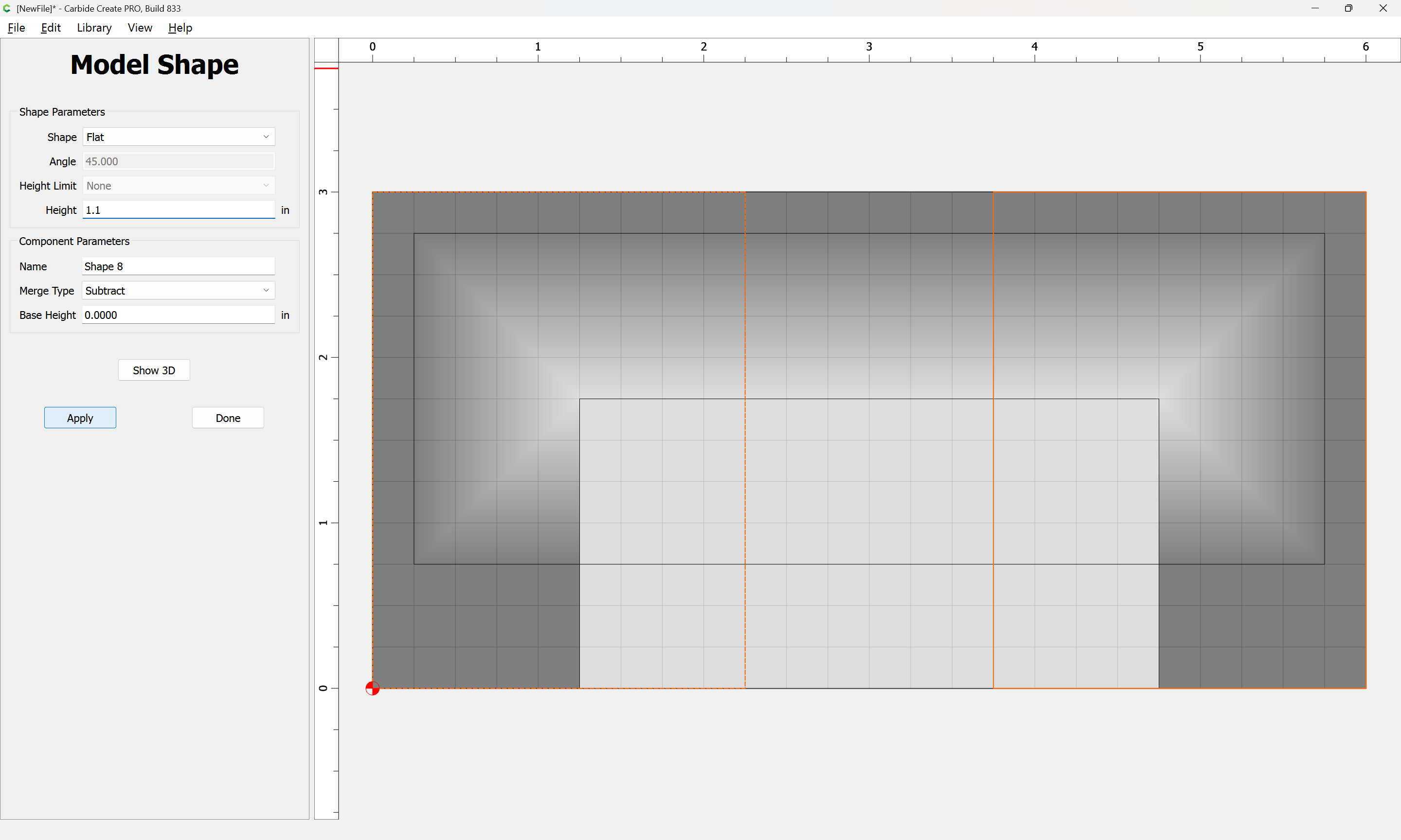

Hello, I’m wondering how to accomplish making this angle. I basically am milling out a flat chassis but have to provide this kicked up ramp part also all in the same piece (The one I have pictured is bolted) (mine will be all one I hope lol) how would I accomplish doing that? Using carbide create pro
What are the dimensions?

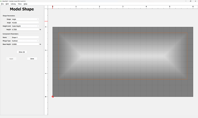

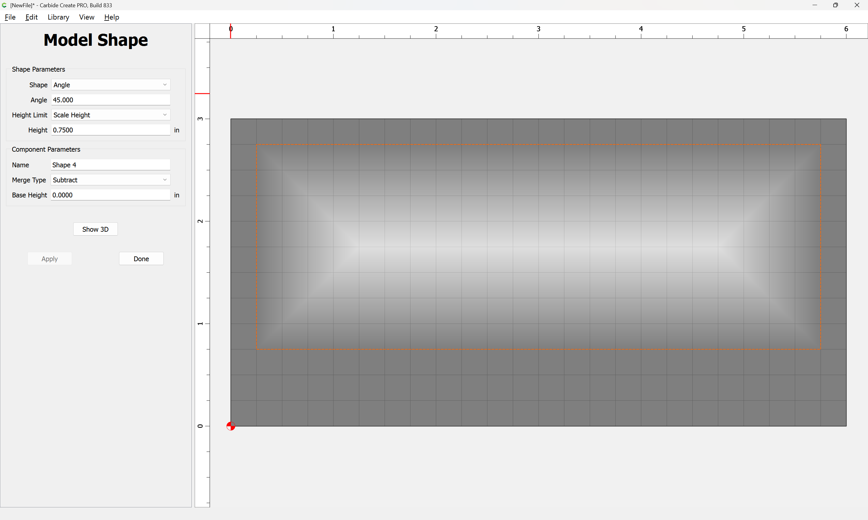

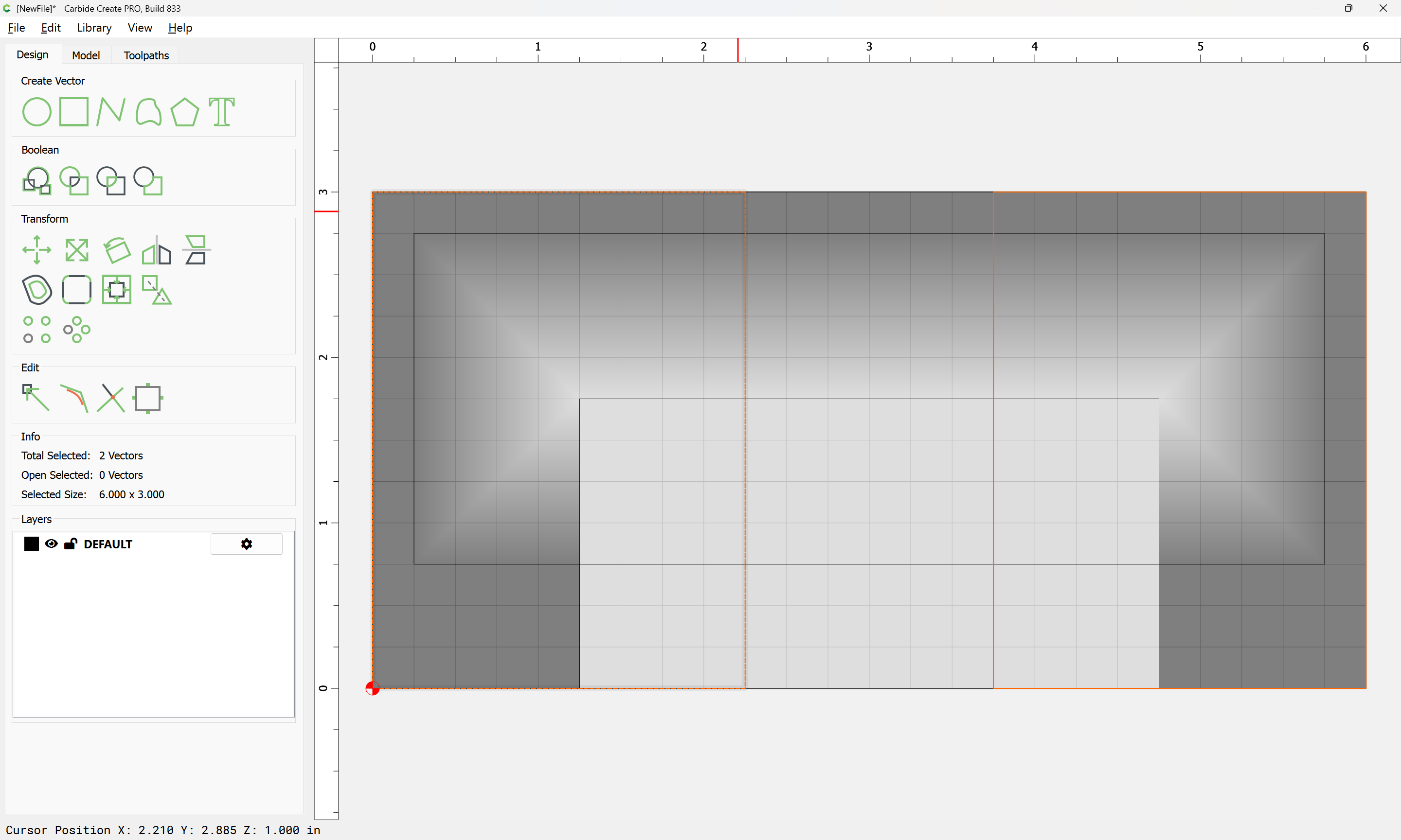

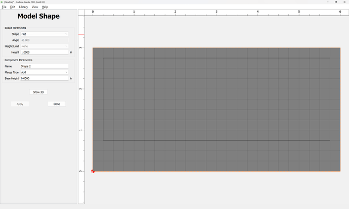

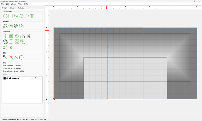

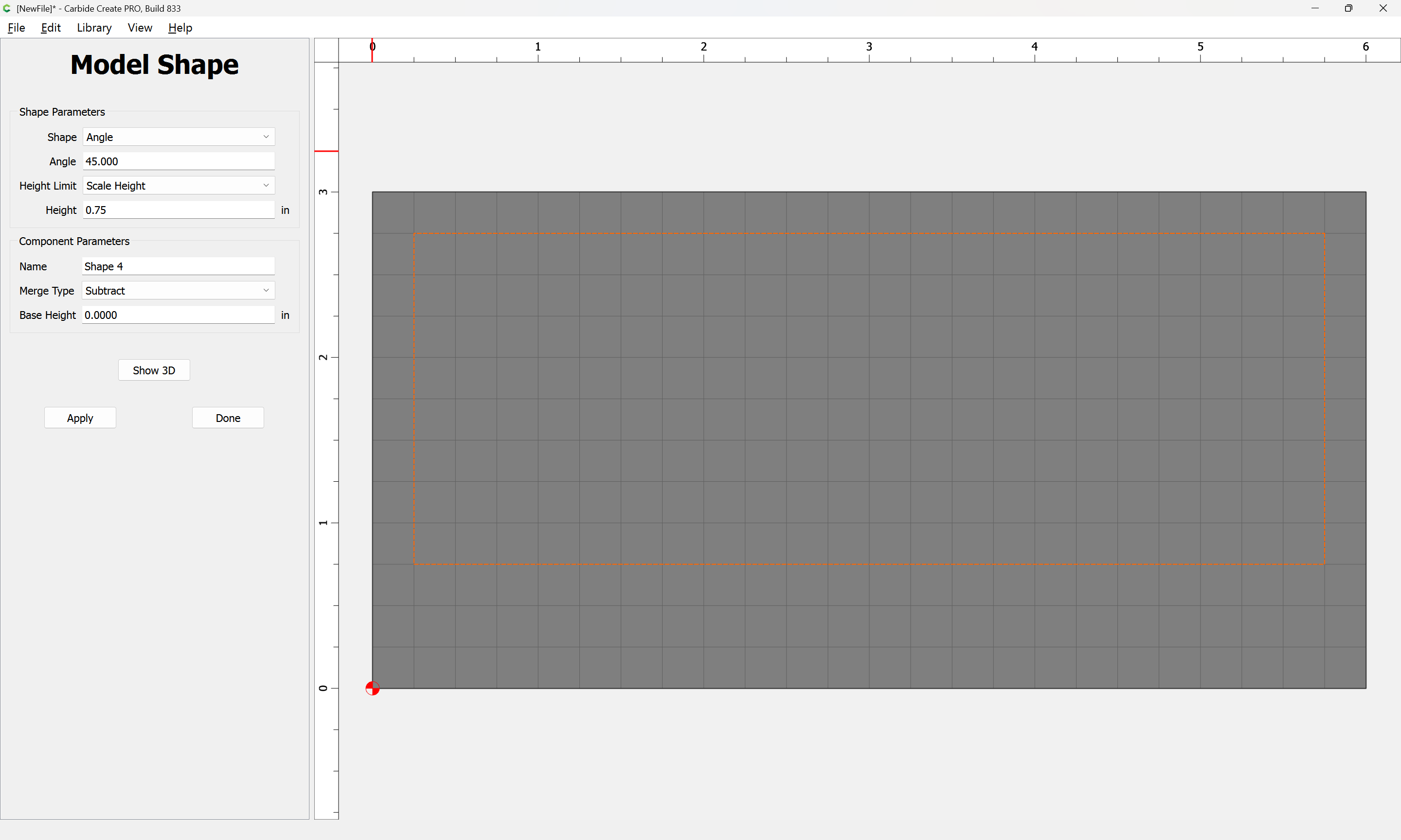

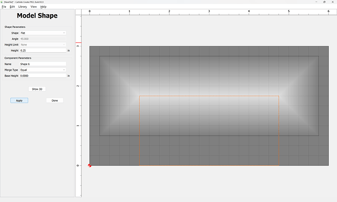

For ramps/angles you have to draw the geometry for modeling the angle twice as wide:

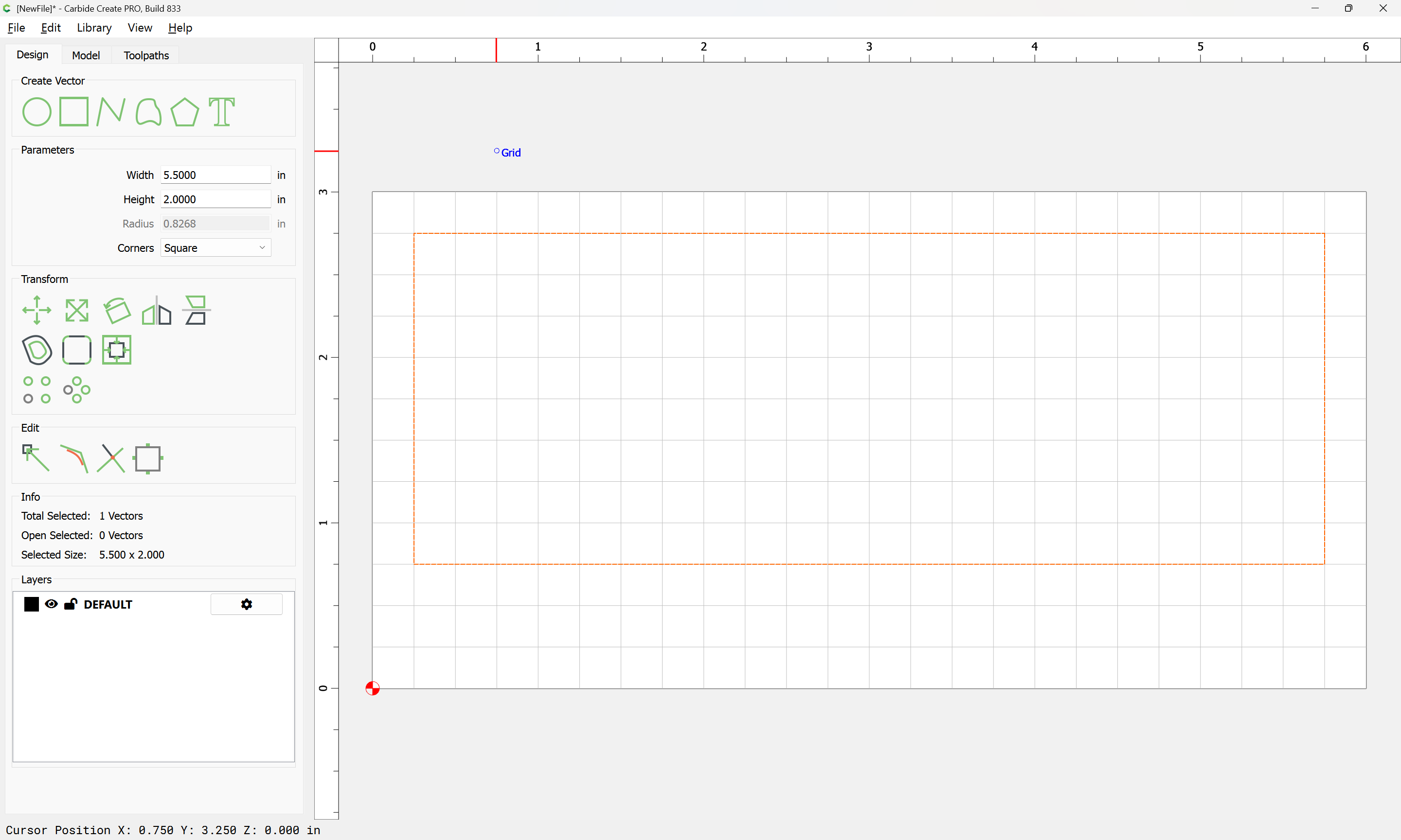

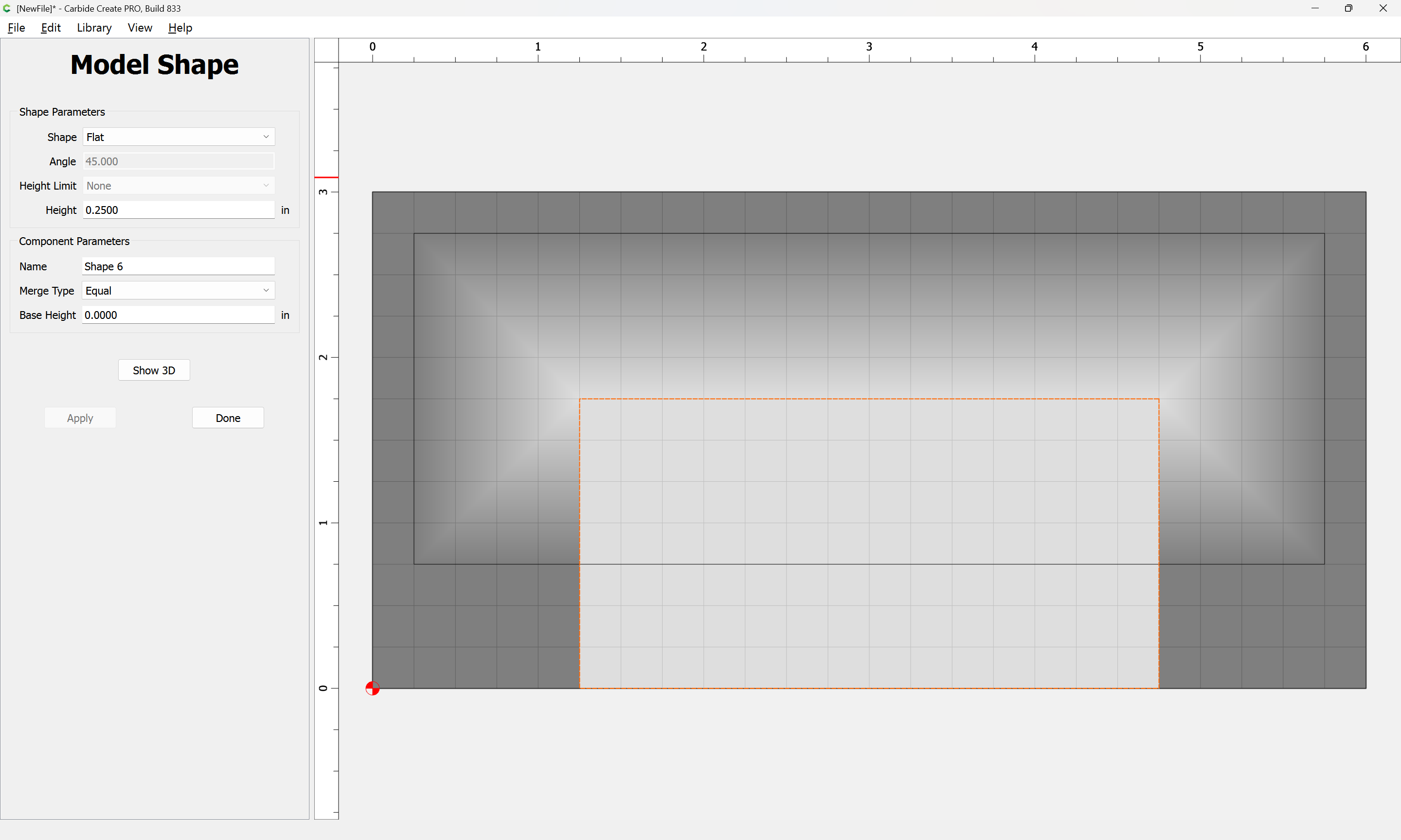

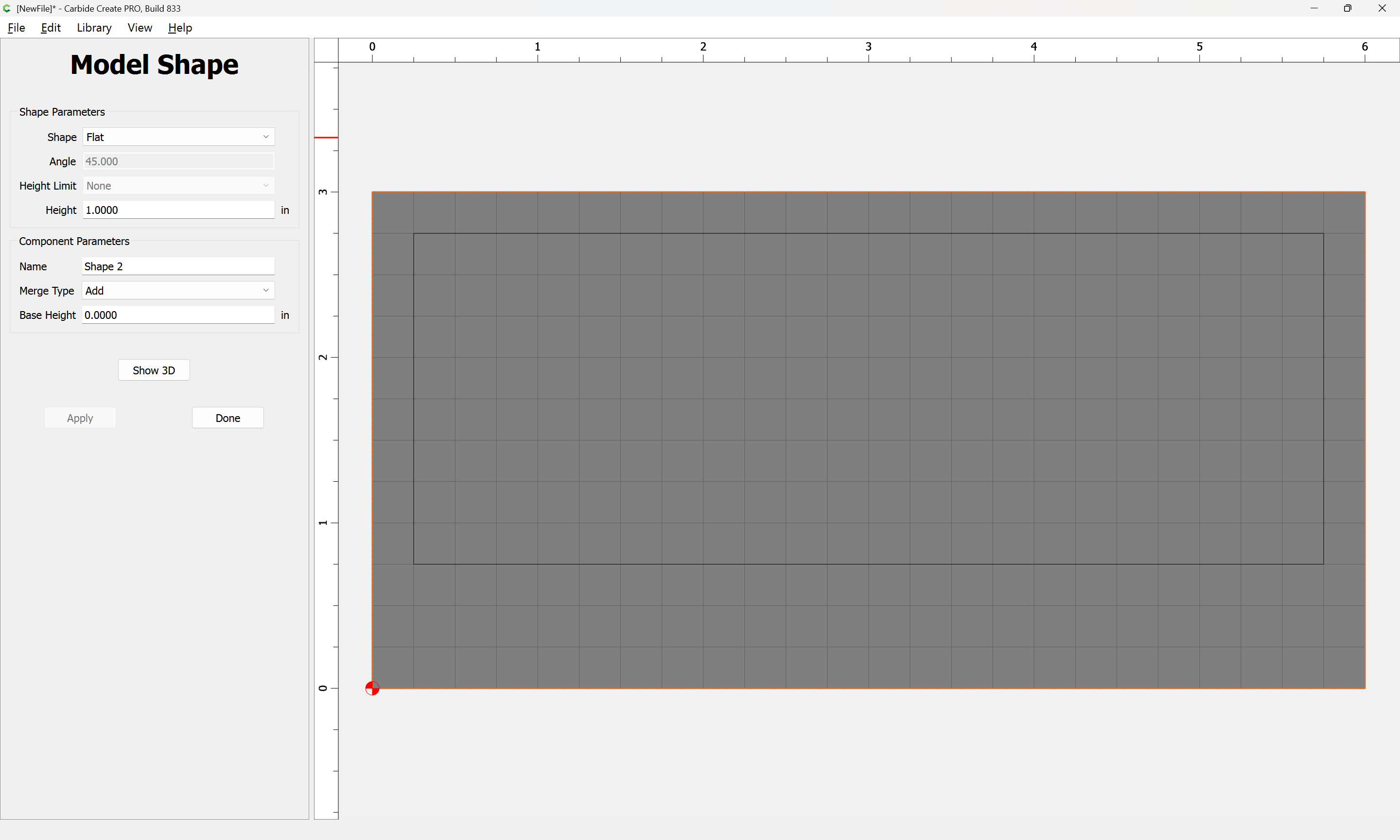

Then model in the flat region:
Then remove what is not needed:
Will you are always on it! Thank you for that! Is there a good video on YouTube or something I may be able to find that explains this better? I am kind of following along a little bit but still don’t fully understand
Upload the file where you are stuck?
