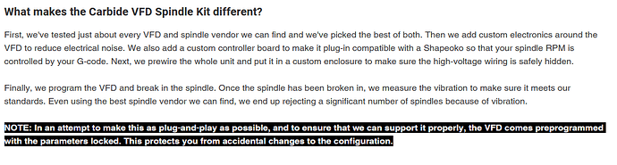

I successfully set up the VFD spindle and can control it with carbide motion. On the spindle’s electronic box there is a screen and buttons, but the setup guide for the VFD makes no mention of how to use it. When I try to key in the desired range using the buttons, the number returns to dashes if I use either the “enter” or “run” buttons.

EM60G1R5S1
C3D locked the VFD with a password. You will not be able to manually control the VFD without changing some settings and said settings are locked behind the password.

They stated it on the page.

You paid 3x more for a well tested, tuned and fully supported VFD vs something $200ish that is a wildcard. I know there is always the ‘possibility’ of doing more with anything but what’s the real probability that you were needing this in your day to day world?
The reason this is done is because people who don’t know what they are doing tinker and end up creating customer service tickets because they are inept at what they did, or at worst, hurt themselves. With the bar always lowering for new people entering fabrication I can generally see what they were thinking. I am also sure the ‘right to repair’ slant will echo around here but I doubt it’s an issue with repair–just control. Really though, worst case the password I believe is 4 numbers. 20% of passwords like that can be cracked in the first 20 tries. This isn’t a hard thing to open up, just warning if you do and things go sideways you paid more to hurt your equipment and it’ll definitely be unsupported at that point. :smiley:

If you ask support, it is likely that they will give you the password.
