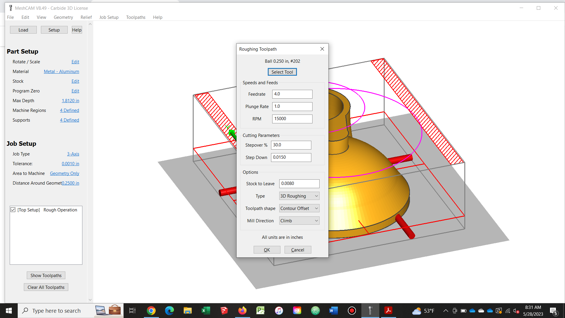

What CAM tool are you using? What feeds and speeds and tooling? Cutting what alloy of aluminum?
Please post your .mcf file if using MeshCAM.

Aluminum is 6061- T6511. I have learned through trial and error what works with the aluminum. I originally started with the defaults in Meshcam when selecting the material “aluminum/metal” in the software but quickly found out that was not even close. I feel like I have that figured out enough to move forward, but then this result. Always some “hiccup” or error message, and never a clear, objective item or process to change to correct whatever happened.
I am using Sketchup to design and export to 3d file. then Meshcam, then Carbide Motion. I have not shut down my machine yet, or closed Carbide Motion, in case there was a way to diagnose something while it is still open and on. But like I keep saying, I have yet to have any direct reason for these failures so i don’t hold out much hope there.
screen shot attached of Meshcam setup, also will upload mcf file.

Carbide: First thing noted is that you are leveraging a 1/4 inch ball mill for your roughing. I think the only time I’ve used 1/4 tooling on aluminum in the nomad has been for facing stock with super light passes. I think it might be worth leveraging 1/8 tooling because the nomad doesn’t have the torque to run 1/4 tooling. Replacing the 1/4 with 1/8 endmill for roughing, you’ll need to change defaults for meshcam. I think they were probably populated with the nomad 883 pro. Pulling the default feeds/speeds for aluminum in carbide create (which I usually find to be a good starting point for feeds/speeds), I get (in inches) .062 stepover, .008 depth per pass, 10 for plunge rate, and 20 for feedrate, with an rpm of 24000.
