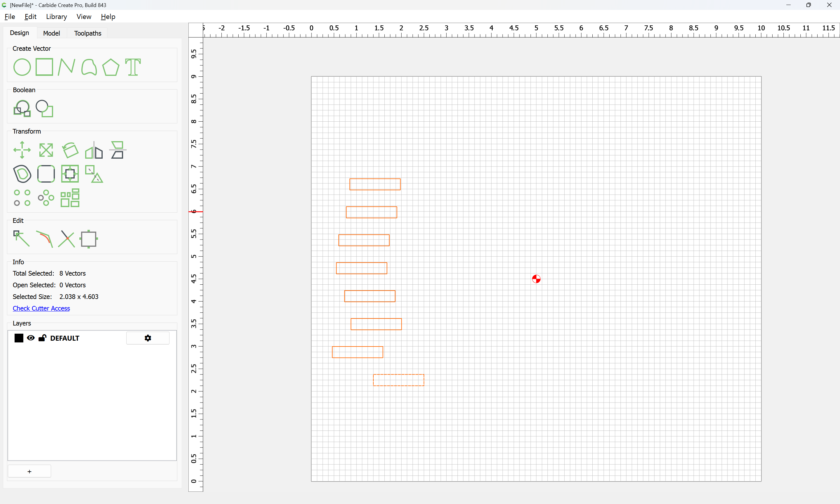

I am trying to figure out how to use the align tools
Can someone send me a link to watch a video on aligning boxes to cutout for a jig?

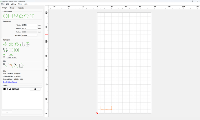

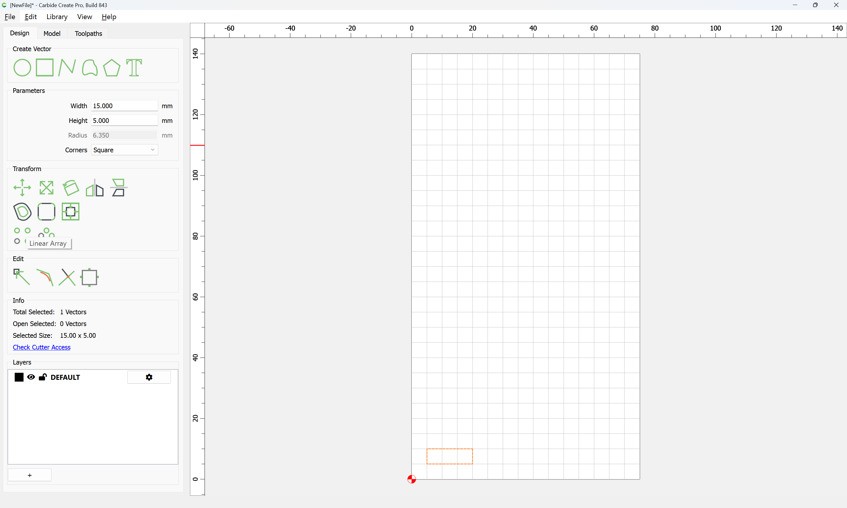

I need to make 6 rows evenly spaced

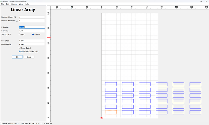

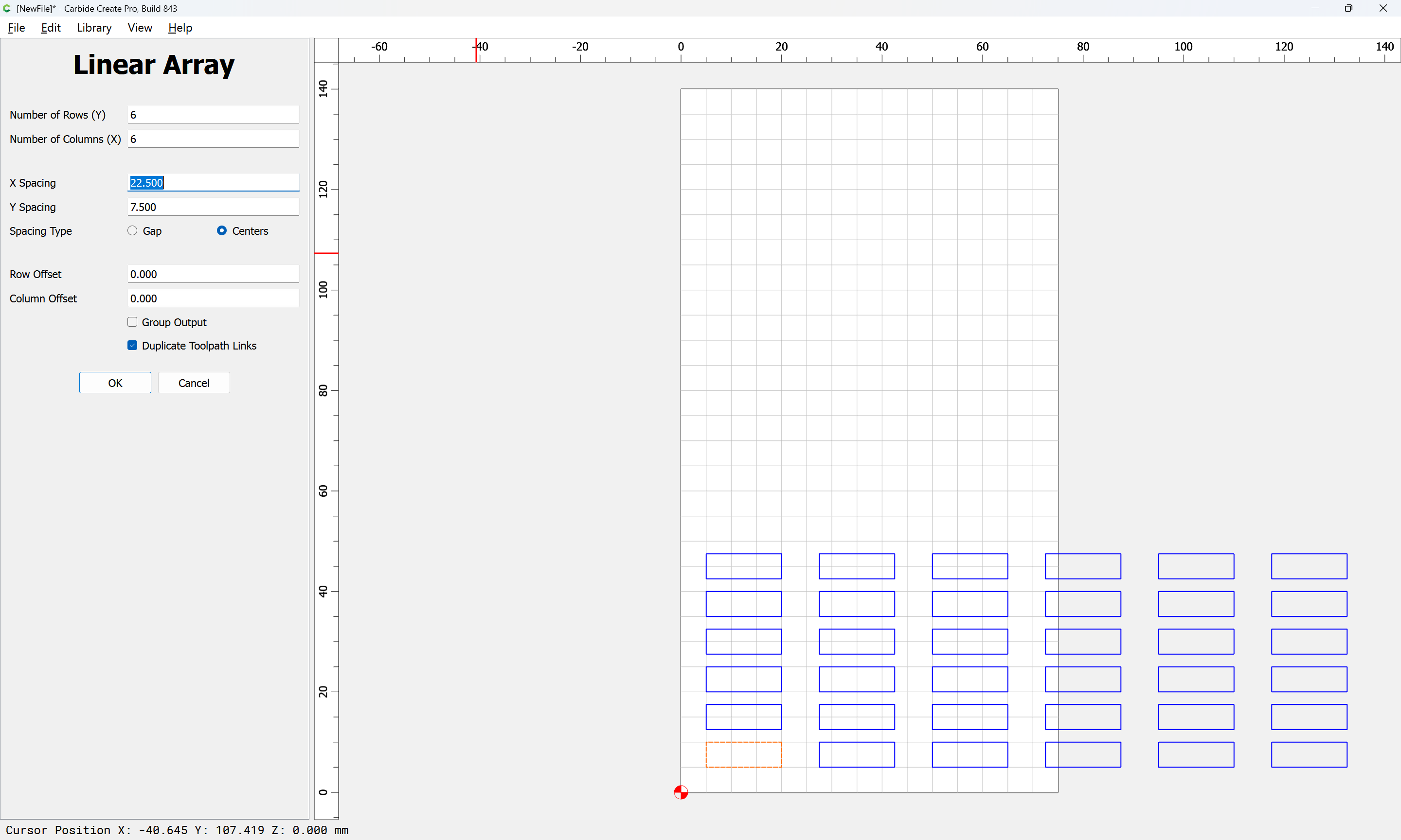

Why not use a Linear Array?
Thank you! That’s what I was trying to figure out

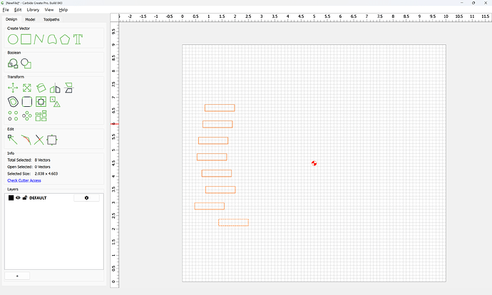

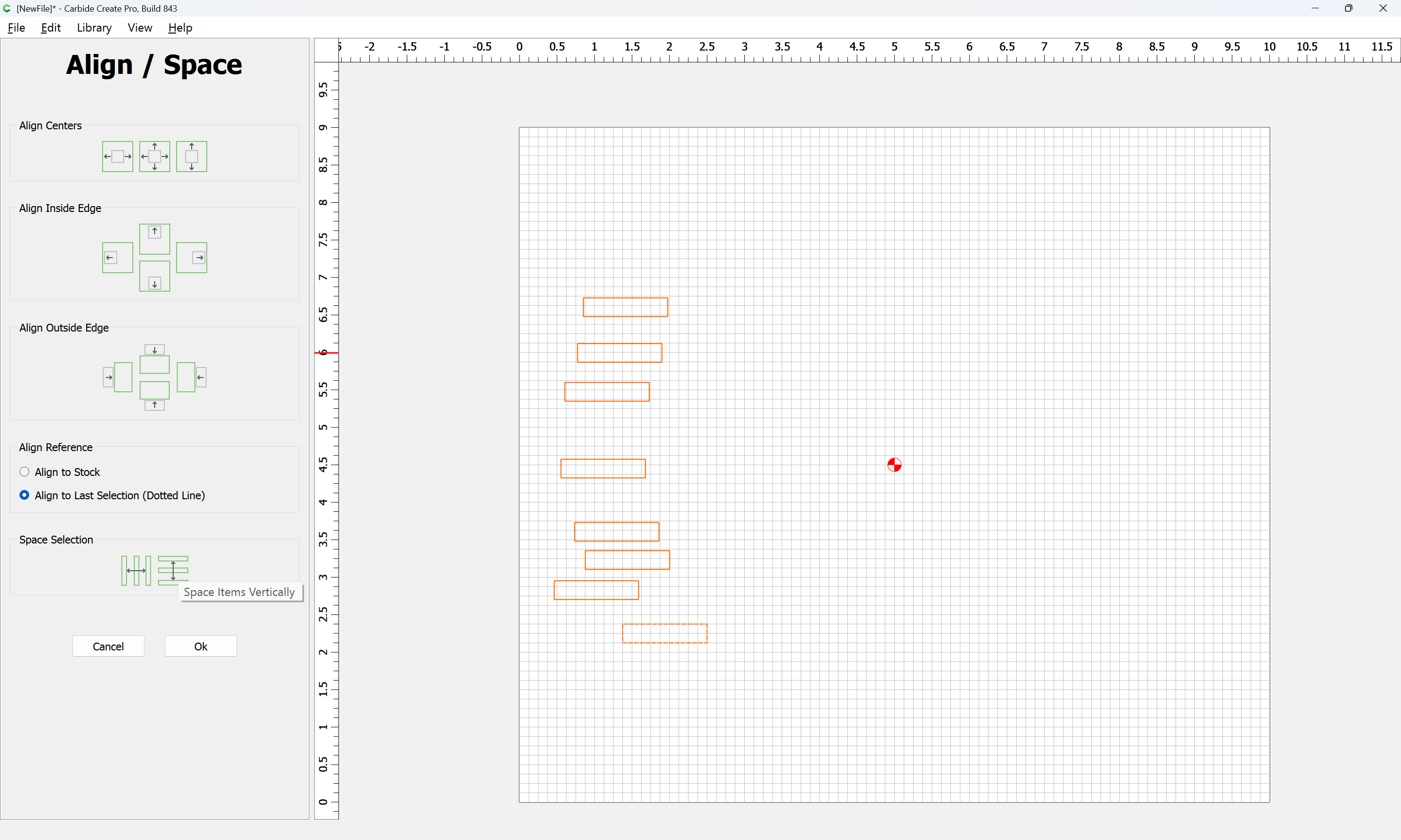

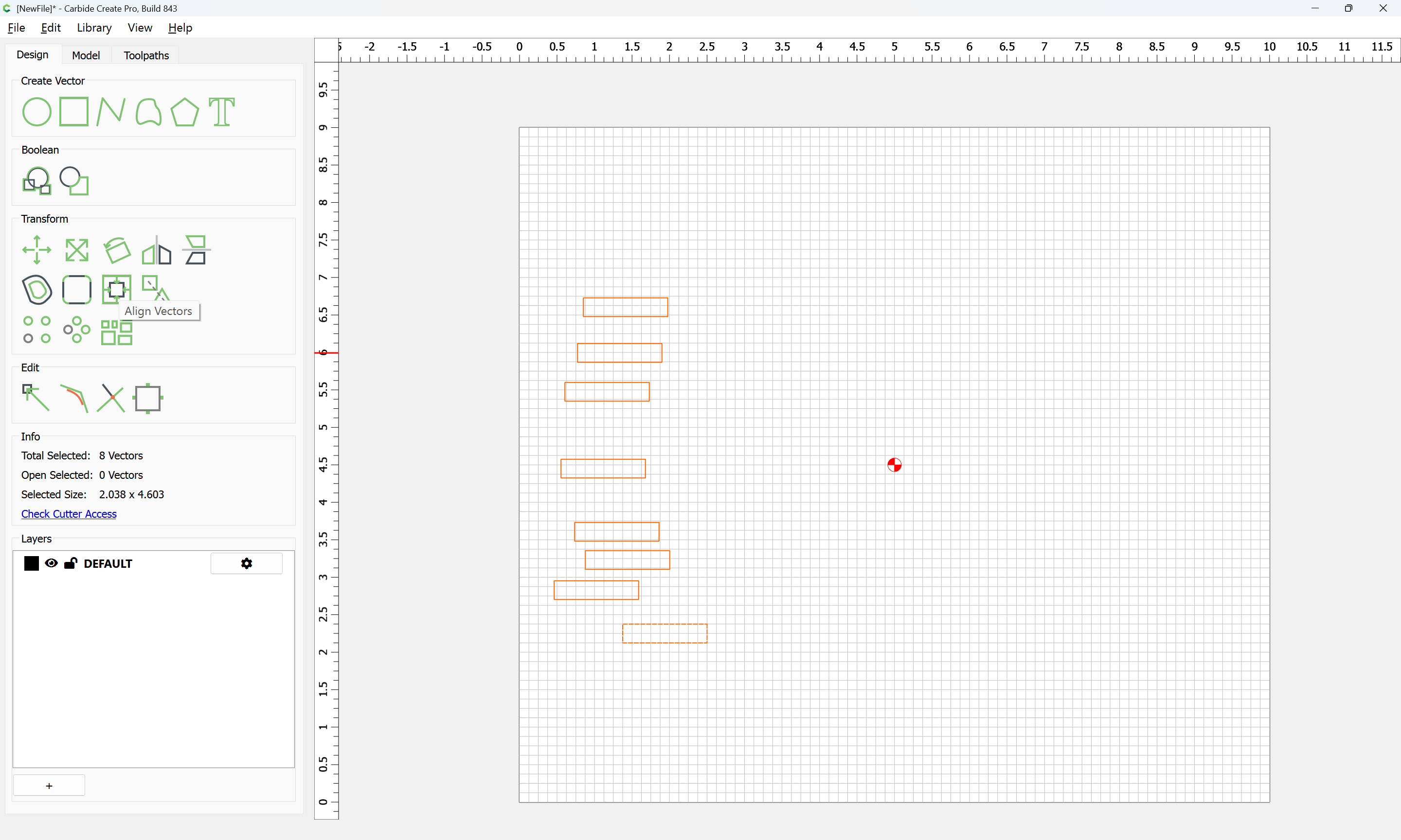

BTW: This is the menu that Lightburn gives for their “Distribute” function…does exactly what is being discussed:
It is in the Align Vectors command:

I used the Linear Array and that was perfect. Thanks!!!

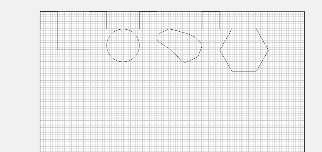

One “trick” I have used for spacing is to create a square the size of the required spacing and align the vectors using the align tools.
The squares at the top are all 2"x2" and the other vectors are spaced out using the boxes as a reference.
I aligned them using the alignment tools
