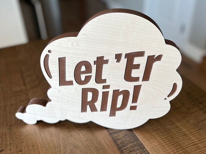

I made a bathroom sign
Yes, I bought this expensive equipment for fart jokes :joy:

What are you using to get the crisp square corners (such as on the exclamation point)? I was under the impression I’d need to use the laser for that.
I am going to guess before the owner replies that an Advanced Vee cut was done. It downloaded the picture and blew it up. Although a very shallow pocket it looked like a vee cut around the letters.
Lets see if I am right.
Yes sir that is correct. An advanced v-bit cut with an Amana v-bit and an Amana shank. It works fantastically! Sometimes I cut deeper, but I chose a shallow cut this time around.
Ok, didn’t think of a shallow v bit, thank you both!

What’s that material? Looks like a veneer on a thick phenolic backing?
It’s just solid 3/4" hard maple that I cut, then painted the outer edge and the lettering.
