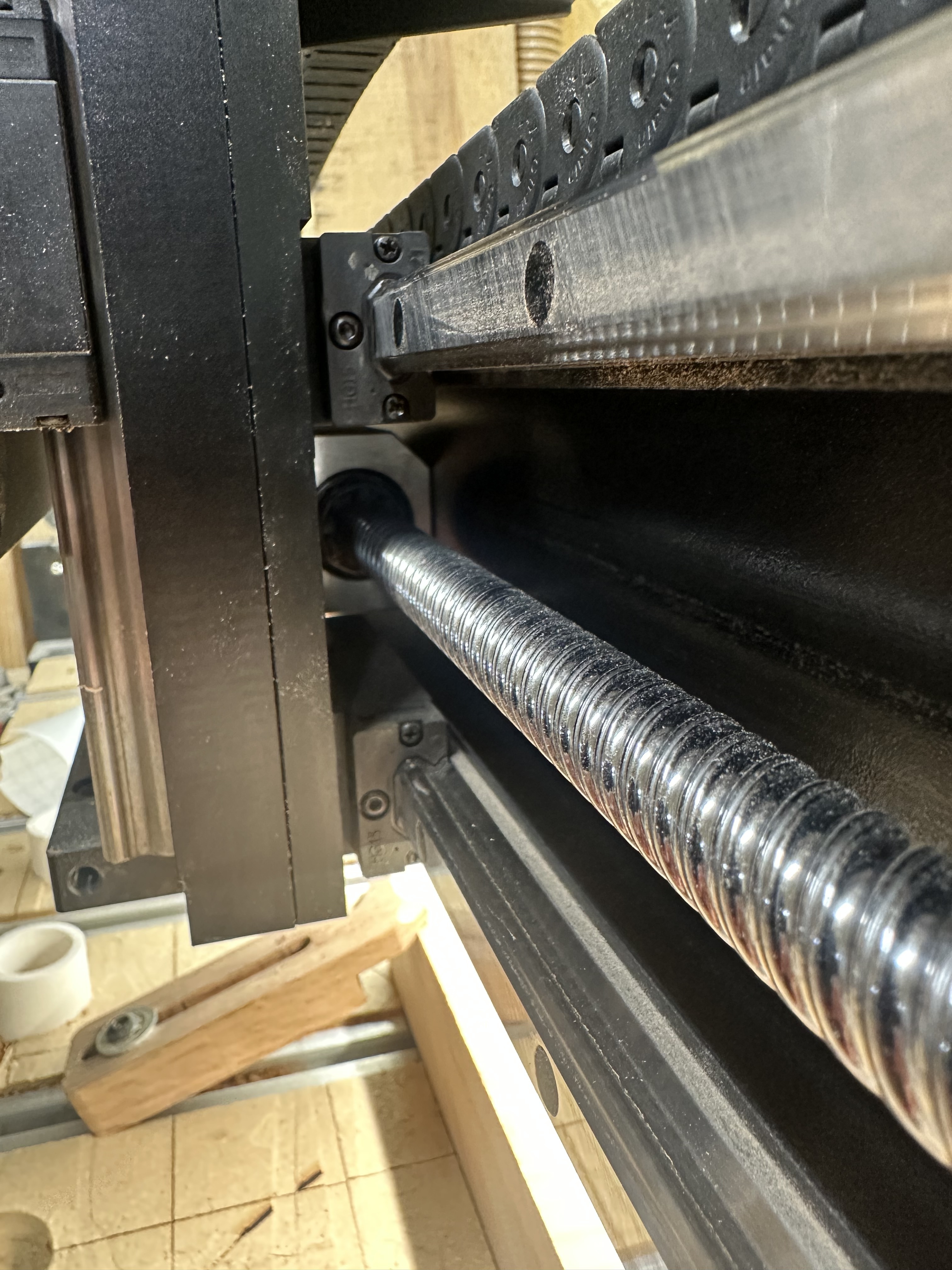

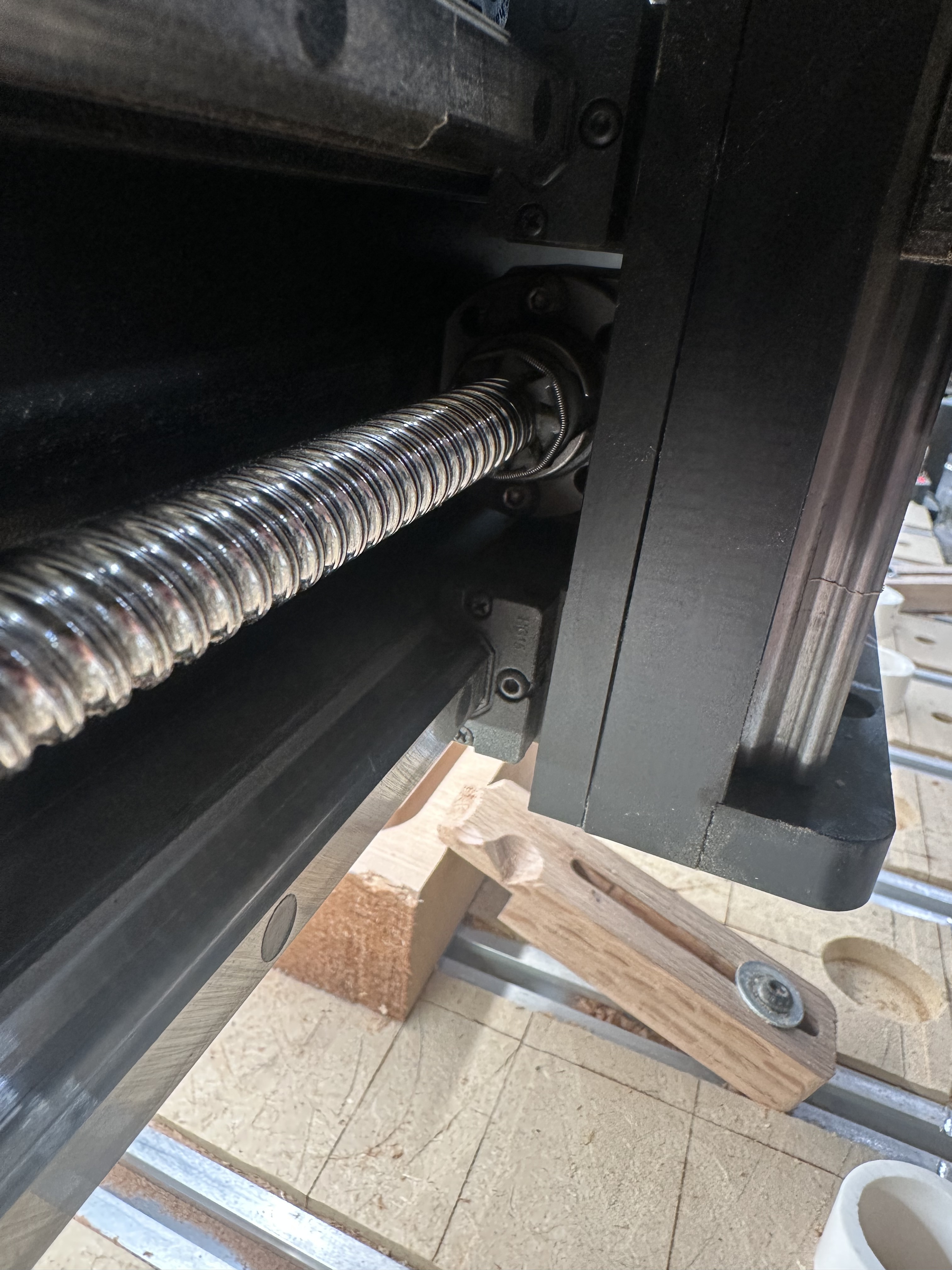

I was in the middle of a project, had already pocketed out a large section, ran a cleanup path with a different bit and then ran an end mill profile path. When I switched to by v bit to run the tool path at the bottom of the pocket it got stuck and stopped moving left and right. I shut the machine off and have tried to trouble shoot it but with no avail. I need some help!!! I cannot jog the machine manually to the left and right more than 3 mm but can front and back with the mdi override. I’ve attached a picture and have a video of what it is doing but it won’t let me upload it. Any ideas would be great!

I have re-initialized the machine multiple times but have to shut it down Bryce it won’t move from the center of the gantry. I tested the limit switches and they will all activate, if there was interference wouldn’t it effect more than one axis and why start in the middle of a toolpath?

To me the sound of the movements sounds strained. Have you maintained the linear bearings with appropriate lubrication ? Also the ball screws.

I don’t know why anyone ever thinks it’s the linear bearings, these things are fairly bulletproof, if I was to guess I would say defective stepper or stepper driver damage. The odds of the ballscrew seizing in 2 separate directions is insanely low.
First instinct would be to unplug both y axis steppers and hook the x axis to the Y axis and see if it functions

If you were able to do this and it still has this issue would be more likely to be a ballscrew issue. If that was proven to not be the issue I’d eat my shorts because the linear bearings can function with 50% of their bearings (obviously not at full capacity but to freeze one is not easy I install these for a living)
