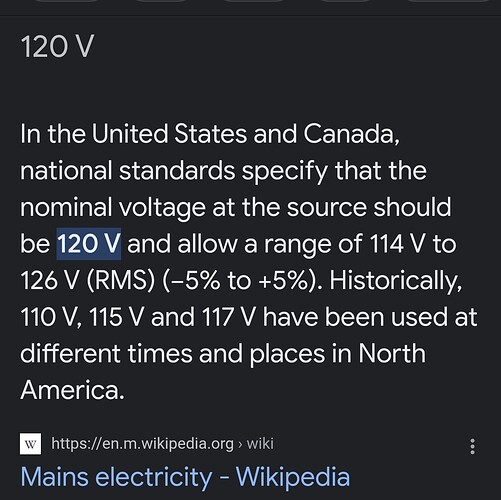

It will work. US power is 120v and 240v. On 120v, I have seen from 105v - 128v while working on my own stuff
I measure 247v, its top of nominal voltage. Been running my hdm for months on it with 0 issues. You can do some research on United States mains rms voltages if you would like more confirmation.

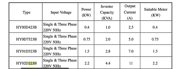

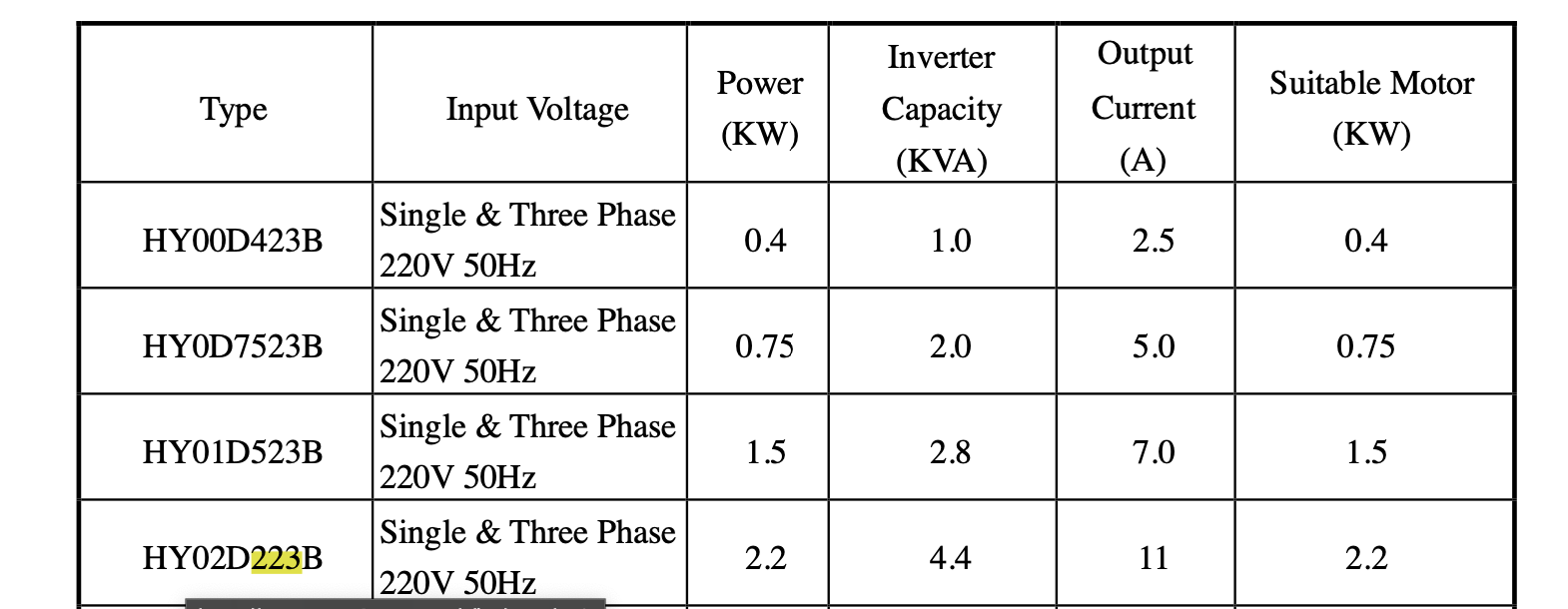

What’s the HuanYang model number of that VFD?
Many of them are rated to fairly high three phase voltage but we’d need to check the manual for the specific unit.
HY series, Model HY02D223B.

OK, so that is definitely a 220V not one of the 380V Three Phase units.
It’s the right size for that spindle, but only rated to 220V.
As Michael and Rob say, there’s always a voltage tolerance range when specifying a utility supply voltage, to allow for variability in where you’re connected on the distribution network. That’s typically at least ±10%, you’re at +12% which has used up the spec tolerance, and, given you’re clearly on a less voltage stable bit of distribution, you may well get spikes well above this.
Given that the HY drives are manufactured to a price and likely don’t have a whole lot of headroom on the component voltage ratings, I’d be more comfortable with one of the 380V Three phase drives such as the HYD02243B in terms of long term reliability.
That said, swapping out the main caps for higher voltage units (probably those from the 380V rated unit) may well allow the drive to operate at higher input voltage indefinitely. The semiconductors may well be the same across many different units.
If the drive does succumb to overvoltage and let the magic smoke out, it’s unlikely to take the spindle with it and you could just buy one of the 243B drives on AliExpress or eBay to replace the dead one, and program it for your spindle. You might want to ask the seller if they can upgrade you to that drive for a fee?
If you’re keeping this VFD unit, I suggest walking through the programming parameters and taking a note of all those that are not the default in the manual so you can program a new one for your spindle if this one goes pop. Here’s a link to the HY manual if you don’t have it https://www.cnc4you.co.uk/resources/VFD%20CNC4YOU.pdf
