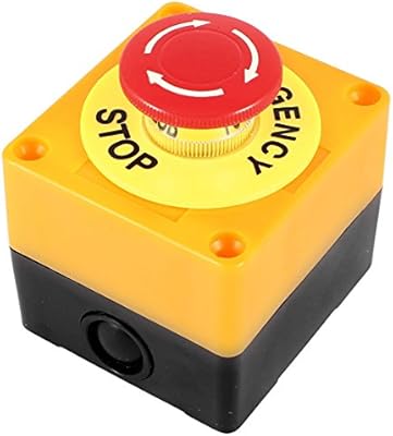

I can put the S3XL and router on one big power switch, is that a bad idea.
Just thinking, in an emergency I can power off the router, but wouldn’t it be better if both the S3XL and router turned off at the same time? If the router was off, but the machine is running with the bit down, it might cause some damage. Yes?
You need something like this wired up to the main power feed to both router and shapeoko, 1 emergency stop for both.
Its a UK amazon link, but the same in US. There are also some fancier Router table ones but this is what I used.

I love this - you are now on the path to greatness, your journey reminds me of mine, and on that note i did the following for my machine. i had a few PANNNNIIIICCCC moments and did the worst thing ever, i accidentally turned off spindle but left motors on, well, lets just leave it too “mistakes were made lol”
But this is what you will find strangely appealing, “see a need fill a need”. I made mine with independent power source for each item, router, hoover etc, and all go through the E-stop button, that way everything is dead in nano seconds. so well worth doing, happy to help / show you more pictures if it will help create your own.
Absolutely right, I have router and shapeoko wired together on one of these switches for now but a panel of switches for controlling power to each component is what I eventually want to build
Sherpa,
I like the design and engineering behind it, nice! How many times have you had to hit the PANIC! button?!
You can’t miss that button, submarine quality. Thx for helping out a newbee!
Well not so much now unless I have been careless, but when I started out, well I was hitting it like a whack a mole game!! No shame in it, at all :grin:
