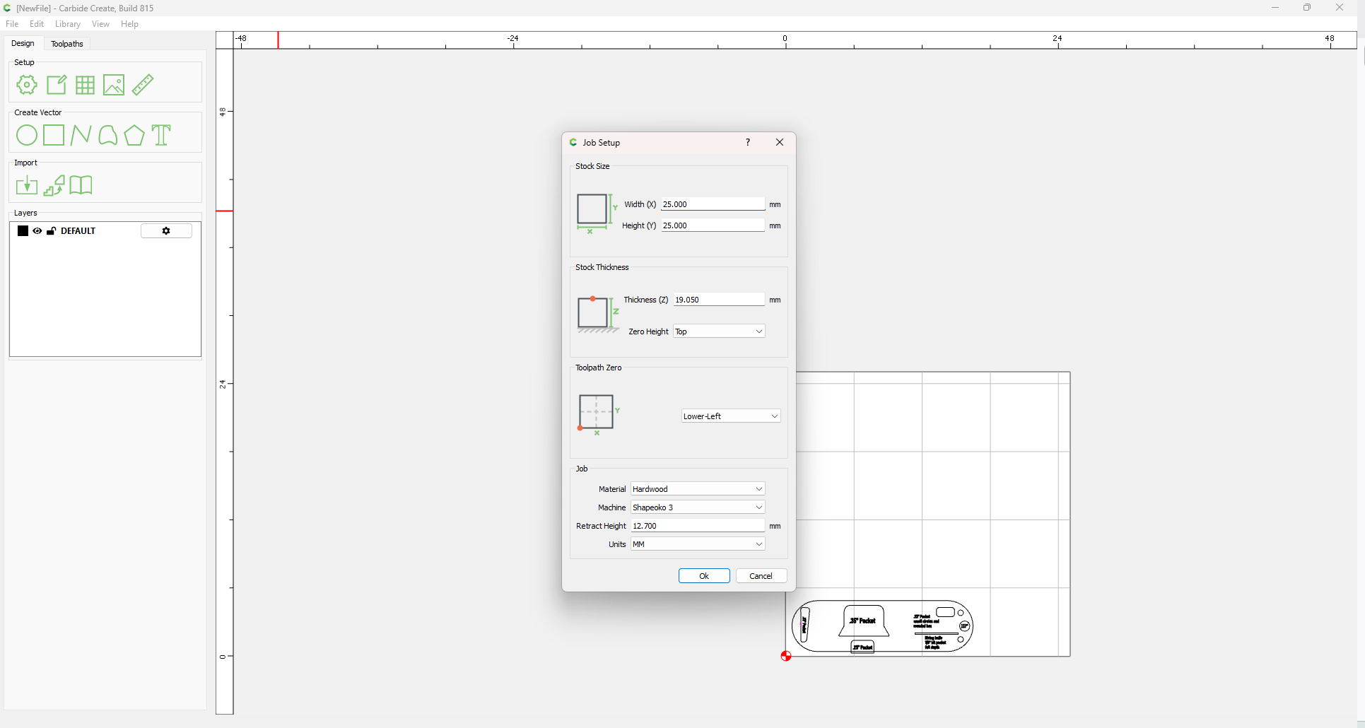

So I have noticed when I download a file from lets say Etsy and I open it, the file is always in metric and incredibly small. What can I do to prevent this from happening?
Using what version of Carbide Create? If not current, please update.
What file format?
Upload a screen grab?
Send a problem file in to support@carbide3d.com
V8
DXF
Please update to Build 836:
Did that, same issue is still happening
Can you share your DXF file?
I’ve never given much thought to unit conversion. Vector graphics scale seamlessly to any size. So if I import an english part and it comes in metric it’s going to be very small. Just scale it up 25.4:1 and you’re good to go. Or whatever scale fits the stock you wan to cut. I’m more concerned with the quality of the curves than the size.
