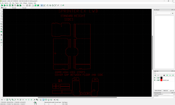

I’ve been successful with such files by opening them in a third party tool, LibreCAD:
https://librecad.org/
and then exporting the design as an SVG — the SVG then opens.

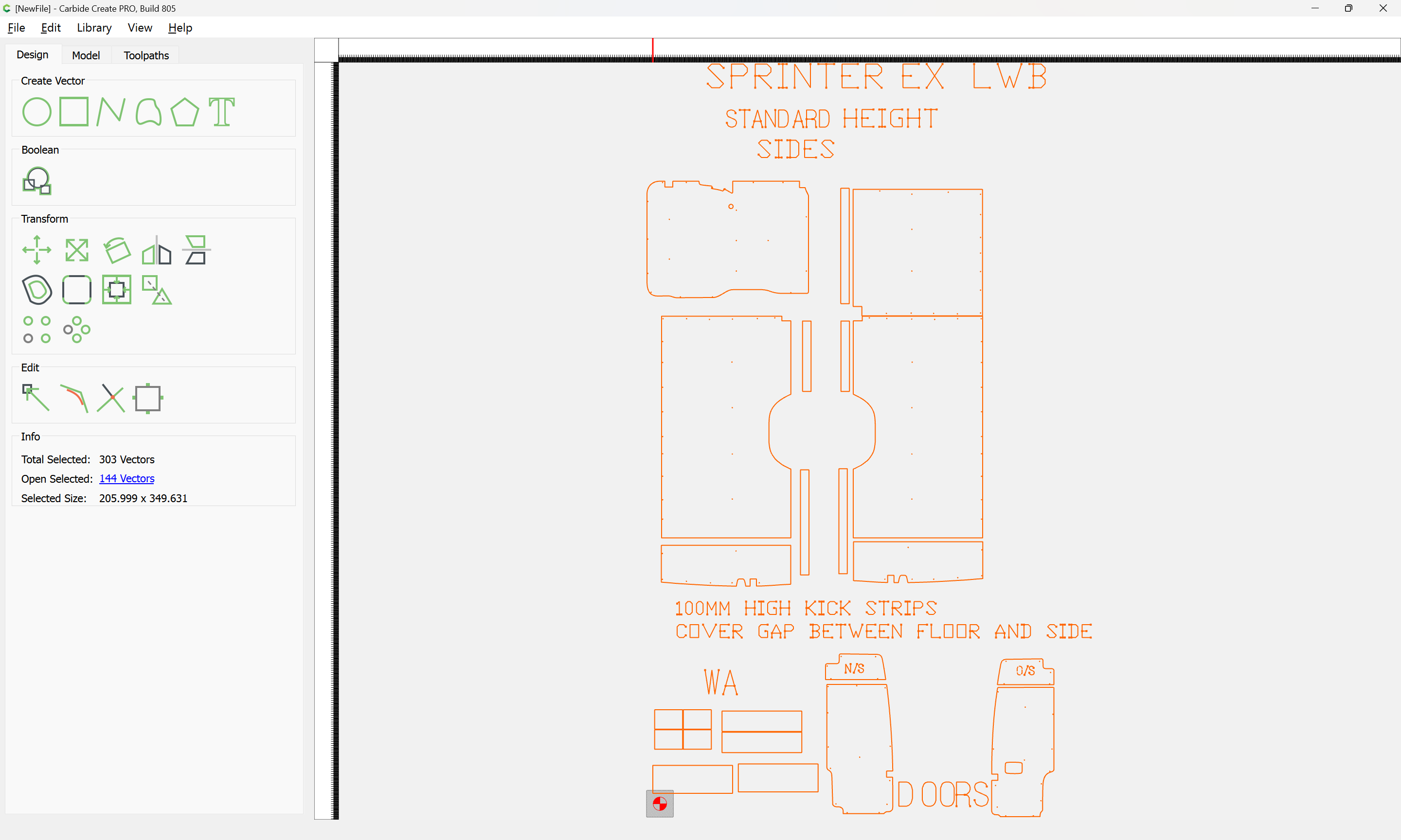

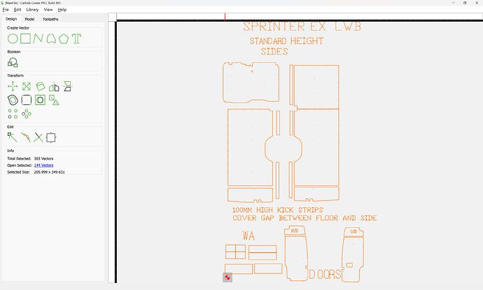

Got your ticket from support@carbide3d.com — as noted, it opens as expected in LibreCAD:
and exported as an SVG, it then imports as expected:
