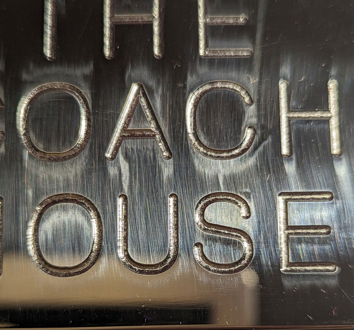

Hi All,
As you can see the engraving isn’t smooth and has lot of marks left by the end mill. My question is
how to improve the engraving quality to get a much smoother result?
Details:
Nomad Pro
Brass 1.5mm thick
Max depth of engraving: 0.2mm
2mm ball nose carbide end mill
Dept per pass: 0.05mm
Plunge rate: 600
Feed rate 1000mm/min
RPM 20000
Thank you all in advance.

My first instinct would be to slow down the feedrate.

I assume contour toolpath, on an open contour. You end up with cutting with both sides of the bit at the same time, with each side fighting each other. I wonder if a “spring” pass would help?

I think Open Contour means a contour (No Offset) operation on an open vector. (The centerline of each letter stroke). I assumed you were doing an inside contour on a closed vector? Outside on the center portions of letters.
Many times you can VASTLY improve surface finish with a finishing pass. Make the last pass around 0.02mm and see if that helps.
Open vector is what I meant, You’re lettering looks like single line fronts.
I used stick fonts and no offset so the tool just followed the font lines in depth increments.
