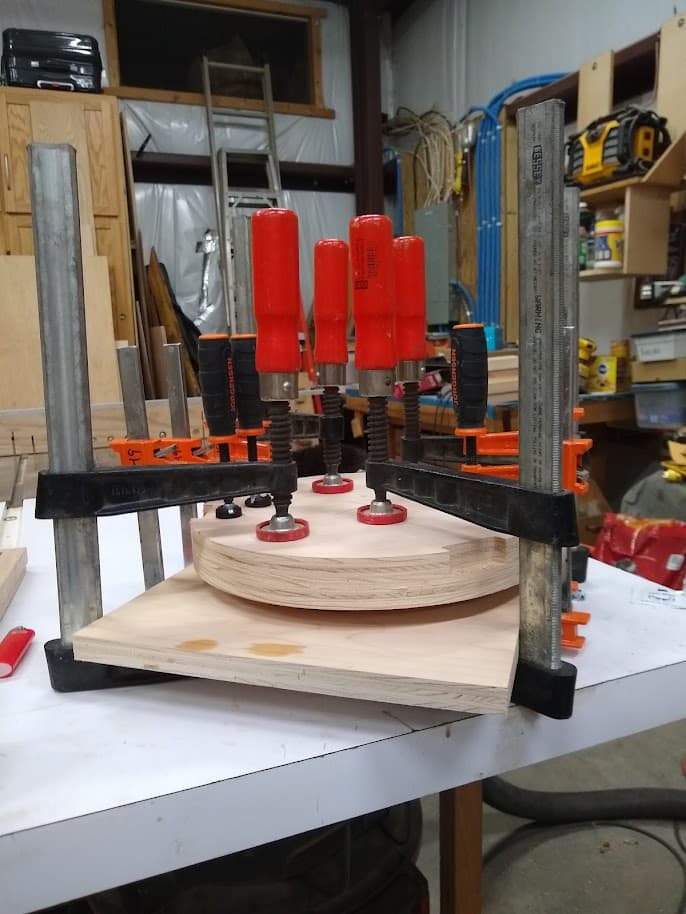

When clamping your male plug in use as many clamps as possible to get the plug to seat all the way to have a gap free finished result. This picture has a round plywood call on top of the inlay to get even pressure all the way around. The caul was just a left over piece from an earlier project. You can use a board of you have one that is bigger than the inlay.
Thanks Guy, I just finished remakiing my female and male parts using a 0.02" glue gap with the following depth settings:
Female: Starting Depth = 0.00" Max Depth: 0.125" (I wanted it thicker for a cutting board)
Male: Starting Depth - 0.105" Max Depth: 0.125"
They match perfectly showing a small gap between the 2 parts. It’s all glued up and clamped and after the glue dries, I’ll surface it and see if I have any gaps where they matched up. My test parts were made from MDF for the female and Select Pine for the male.
