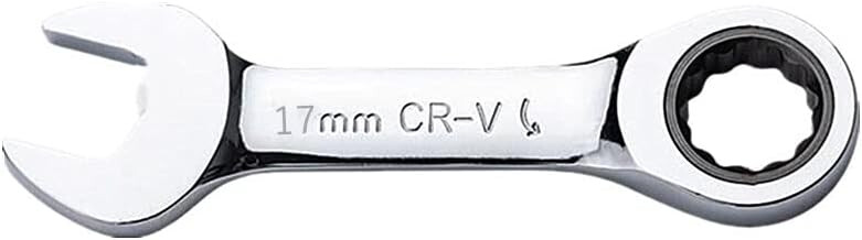

I would recommend buying a better wrench to tighten the collet. I bought a shorter wrench to keep me from over tightening the collet.
Similar to this:
https://www.amazon.com/FLZOSPER-72-Tooth-Ratcheting-Combination-Spanner/dp/B09W1XJ1WK/ref=sr_1_5
