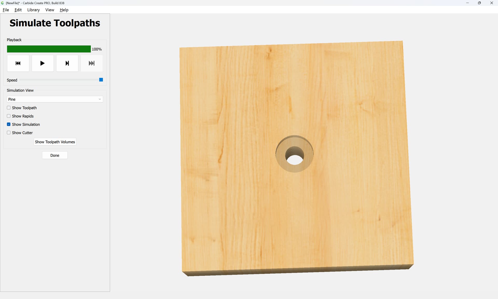

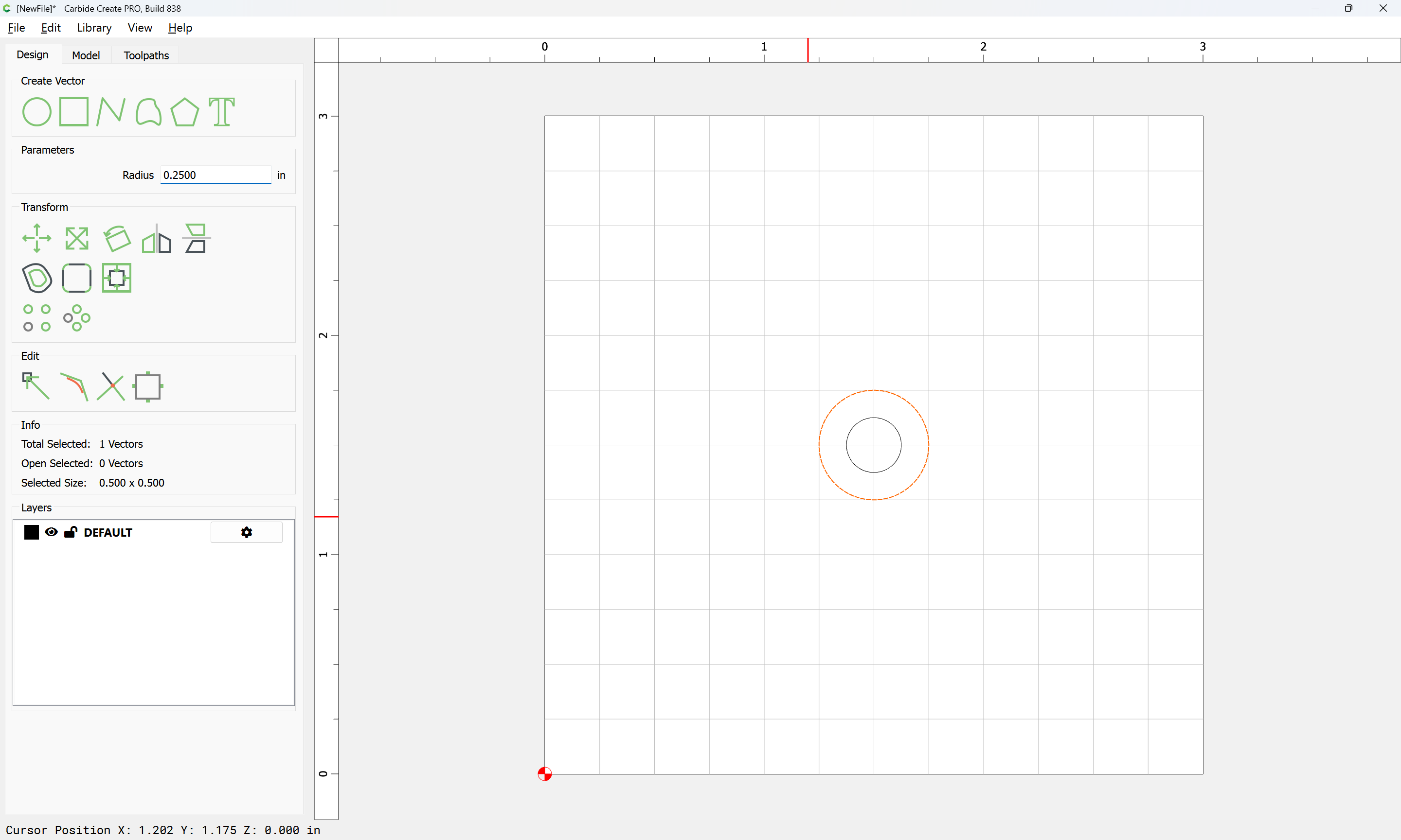

Using Create, i am trying to drill for the countersink then drill for the bolt.
Hole is
0.75" deep (through the work)
0.25" wide
Countersink is
0.125" wide and 0.0875" deep
I cannot seem to be able to generate the correct .nc file.
Is there something in the tutorials on how to do this?
Jeffish
(Jeff de Ruiter)
February 7, 2026, 8:24pm
2
The countersink is smaller than the bolt hole… Either way just create 2 circles of the correct size centered on the same center point and then make 1 drilling toolpath for the .25 to the correct depth and a pocket for the larger countersink hole to the correct depth. Or do the pocket first then the drilling

That is called a counterbore.
Countersink = tapered or chamferd edge around a hole for something like a flat head screw.
Counterbore = flat bottomed recess around hole for something like a washer.
You would make another pocket that is 2" (50mm) diameter and whatever depth you need, centered on the through hole.

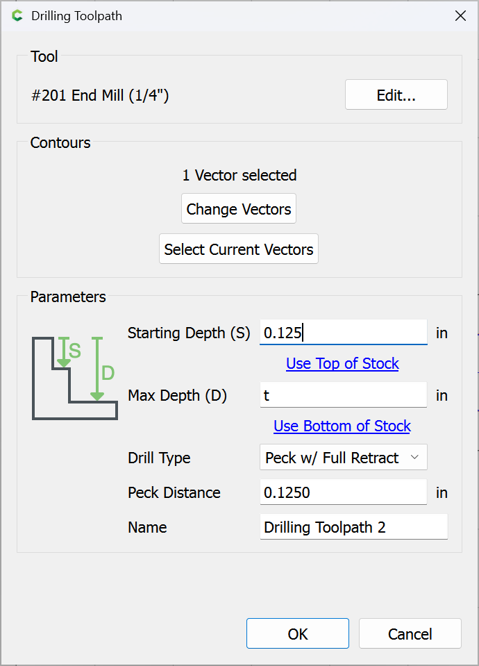

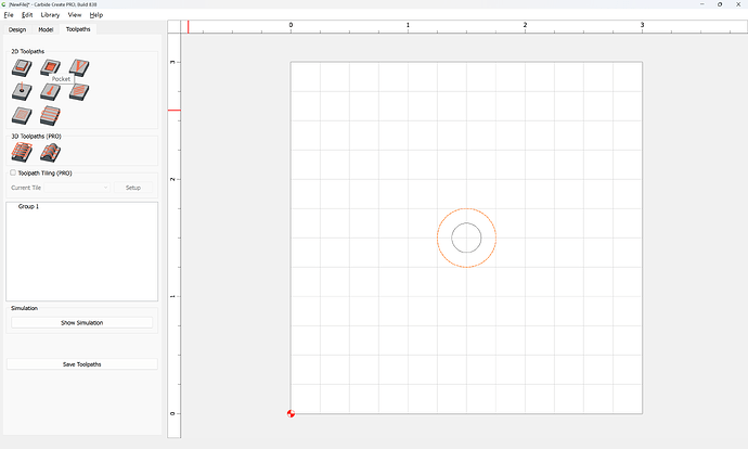

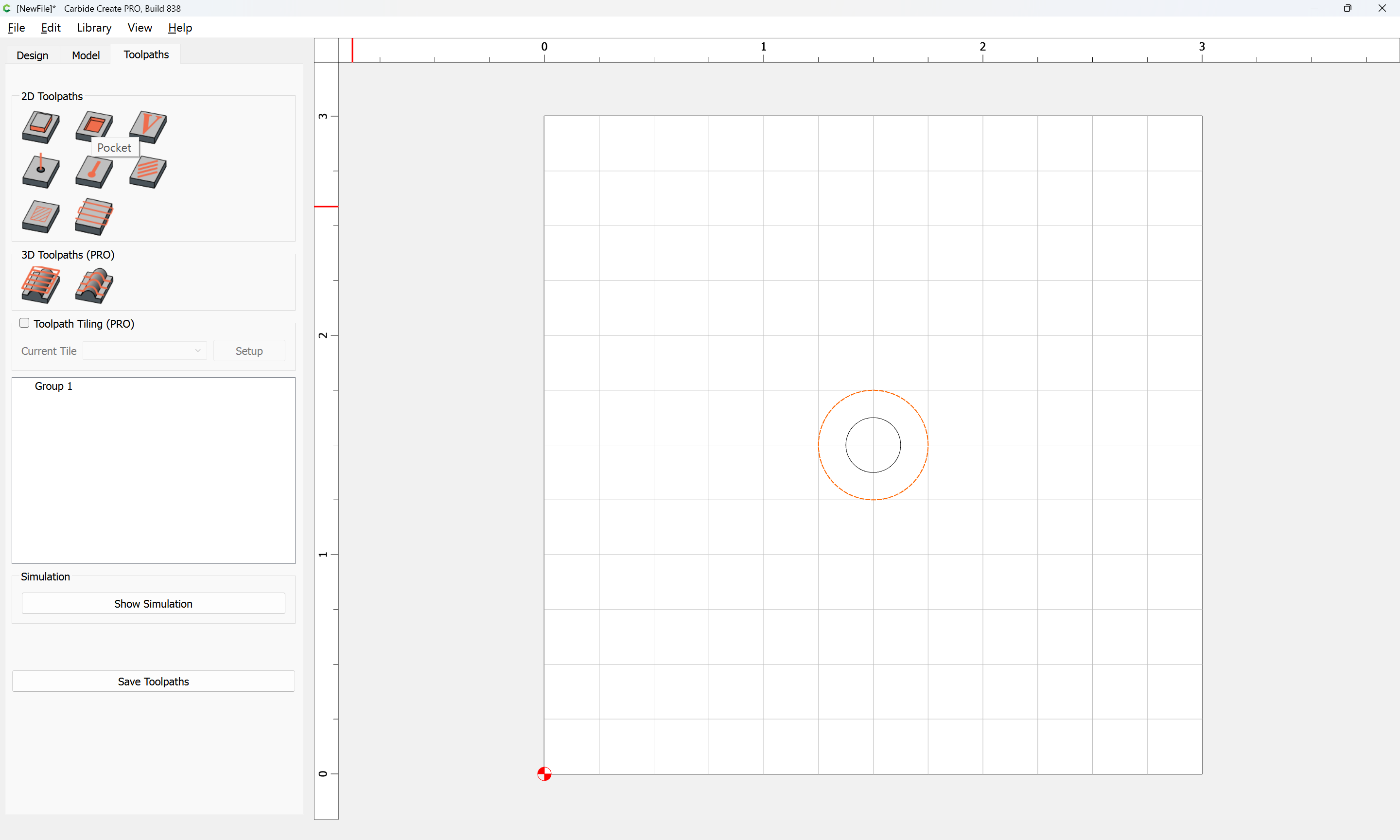

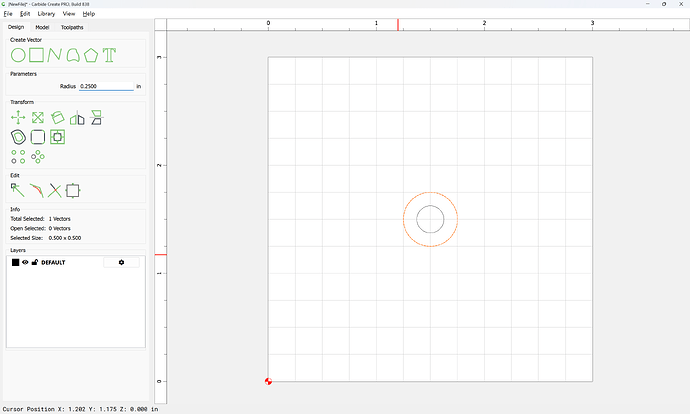

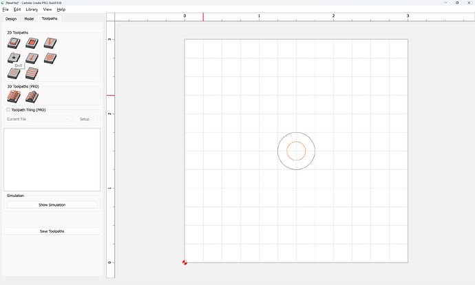

Have two circles:

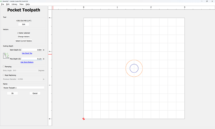

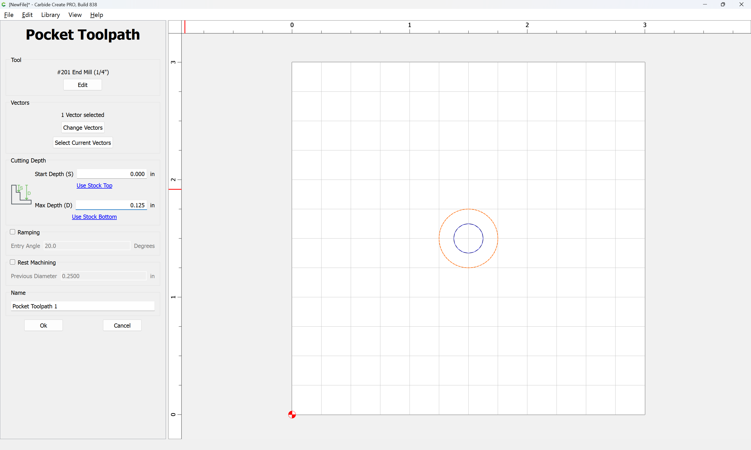

Use a pocket for the larger circle to the desired depth:

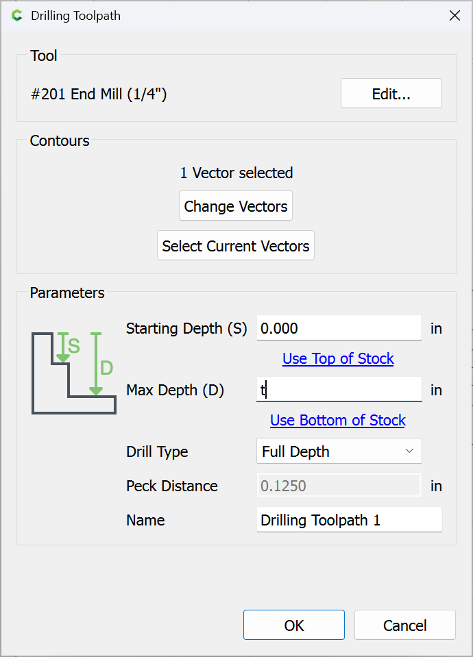

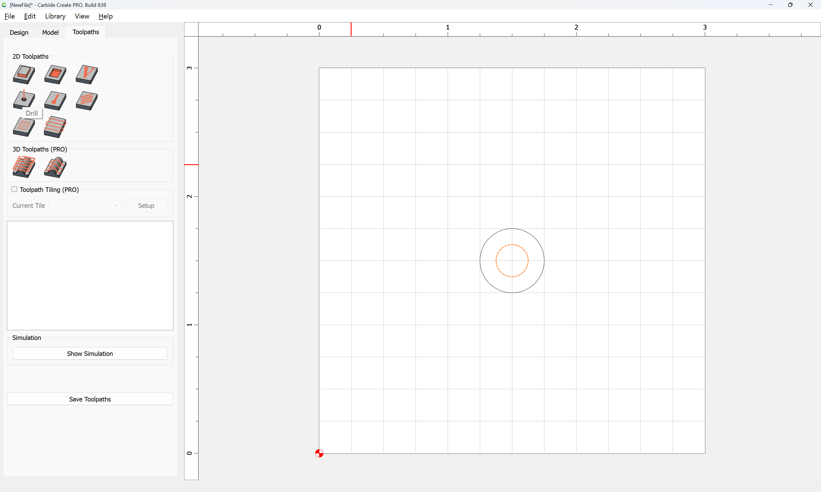

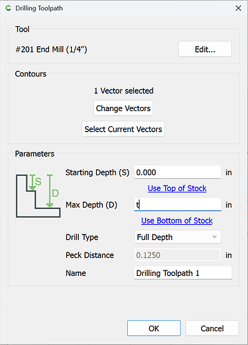

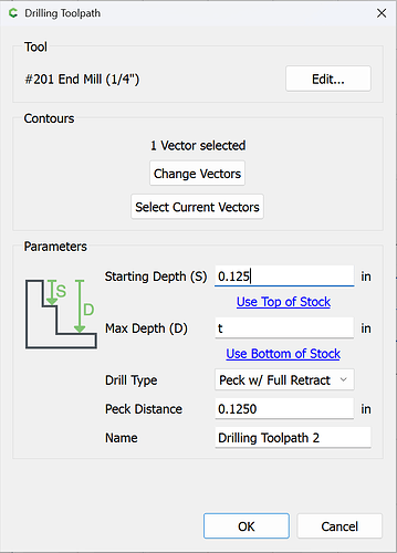

Use a Drill toolpath on the center:
setting it to start at the bottom of the previous pocket:
