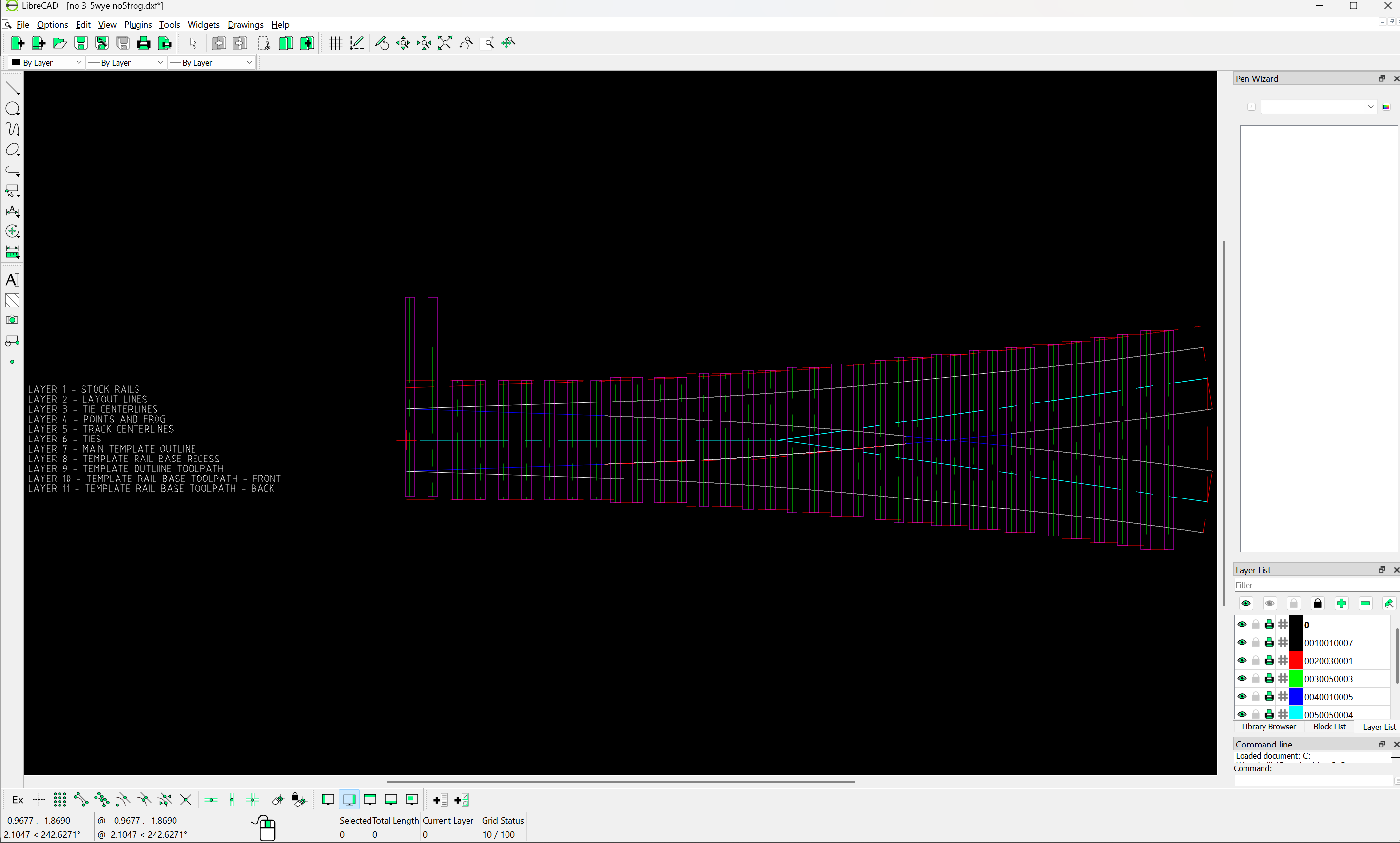

Is CC supposed to respect DXF layers?

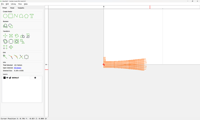

Title says it all. I’d email Support directly but my gmail is down… CC puts the whole DXF on DEFAULT. I’ve already learned to scale the DXFs by 25.4 because I work in inches and they always come in as mm.
While the mic is open, I’ll add that CC does not respect the DXF origin either. Is that expected?
no 3_5wye no5frog.dxf (41.9 KB) is a typical DXF output from my CAD. That said, it’s easy enough to window-select everything and drag it by the node at (0,0) to the origin (maybe needing to put geometry there in my CAD just for that purpose…) , just fiddly to do every time.

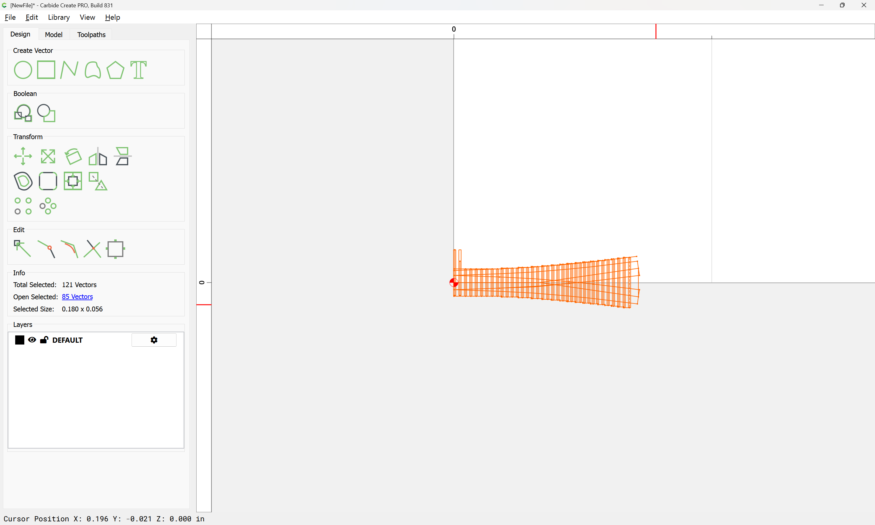

Your file views as:
and imports as:
which seems to match the origin in the DXF as interpreted by LibreCAD.

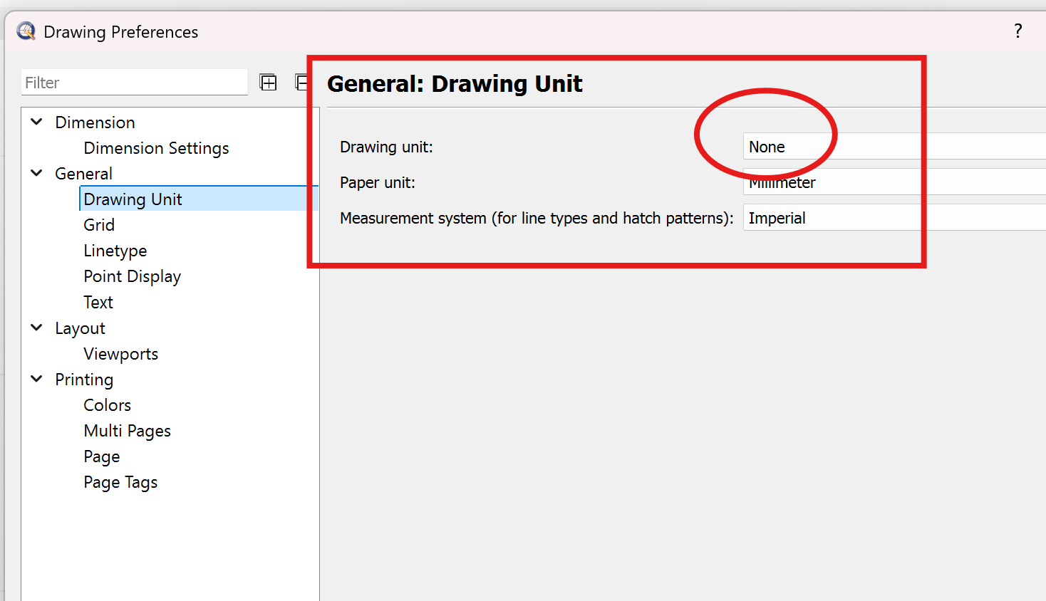

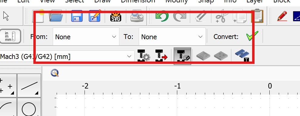

your DXF-file has no unit defined.
The importing software does not know what measures are there. That is what I get when I try to convert drawing unit:
May be define a unit in your dxf-file. May resolve the unit issue.

Thank you, Will. Yes, I see that CC is aligning to the DXF origin. But I have the stock origin set at center left, whereas CC puts the DXF origin at the bottom left of the stock and not at the stock’s origin. I guess it’s a matter of getting used to how CC works, and knowing that is supposed to be how it works… :slight_smile:

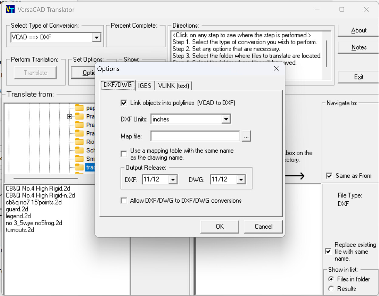

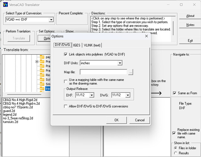

Thank you, Matthias. I do have inches set in my DXF translator
As I replied to Will, I’ll just get used to how CC works so I develop a consistent workflow.
DXF is an old format, with a lot of variations, since units aren’t required/standardized, some folks treat it as unit-less.
I’ve found that importing into LibreCAD, then exporting as an SVG, then importing the SVG works best.
The origin thing was something I reported an oddity on a while back, which I think was fixed — if you have a file which has a problem, let us know and we will look into it.
