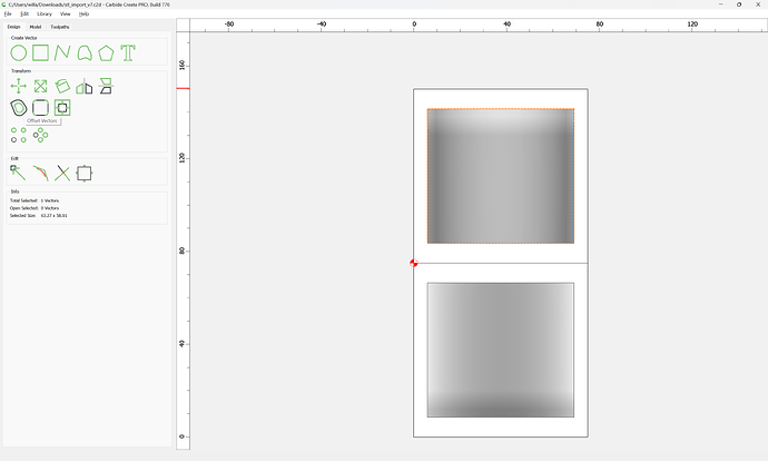

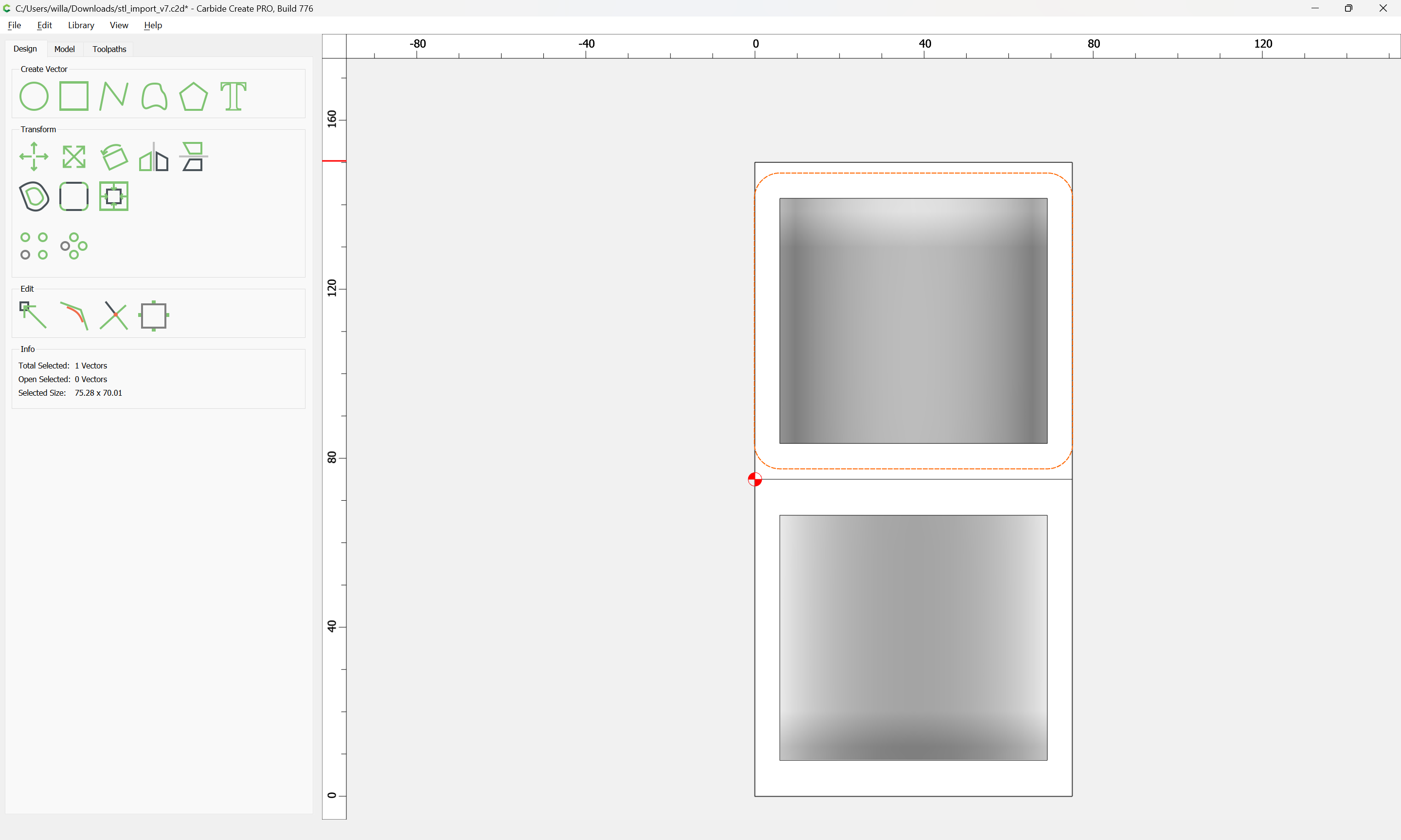

When an STL is imported, geometry is auto-traced around it:
If you wish, that geometry may be selected and offset to the outside:

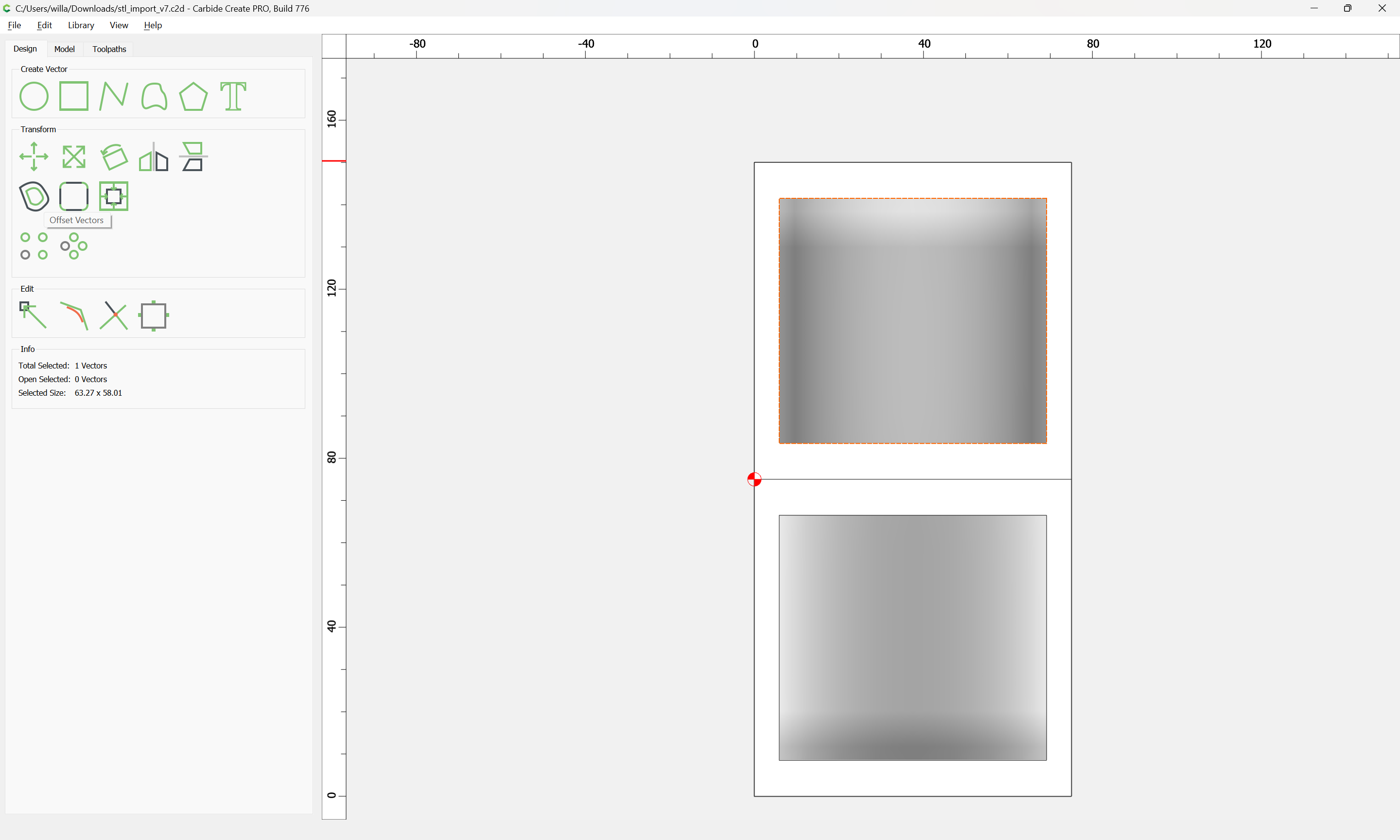

Alternately, deselect everything:
and use the Polyline or Curve tool to re-draw things. See:
