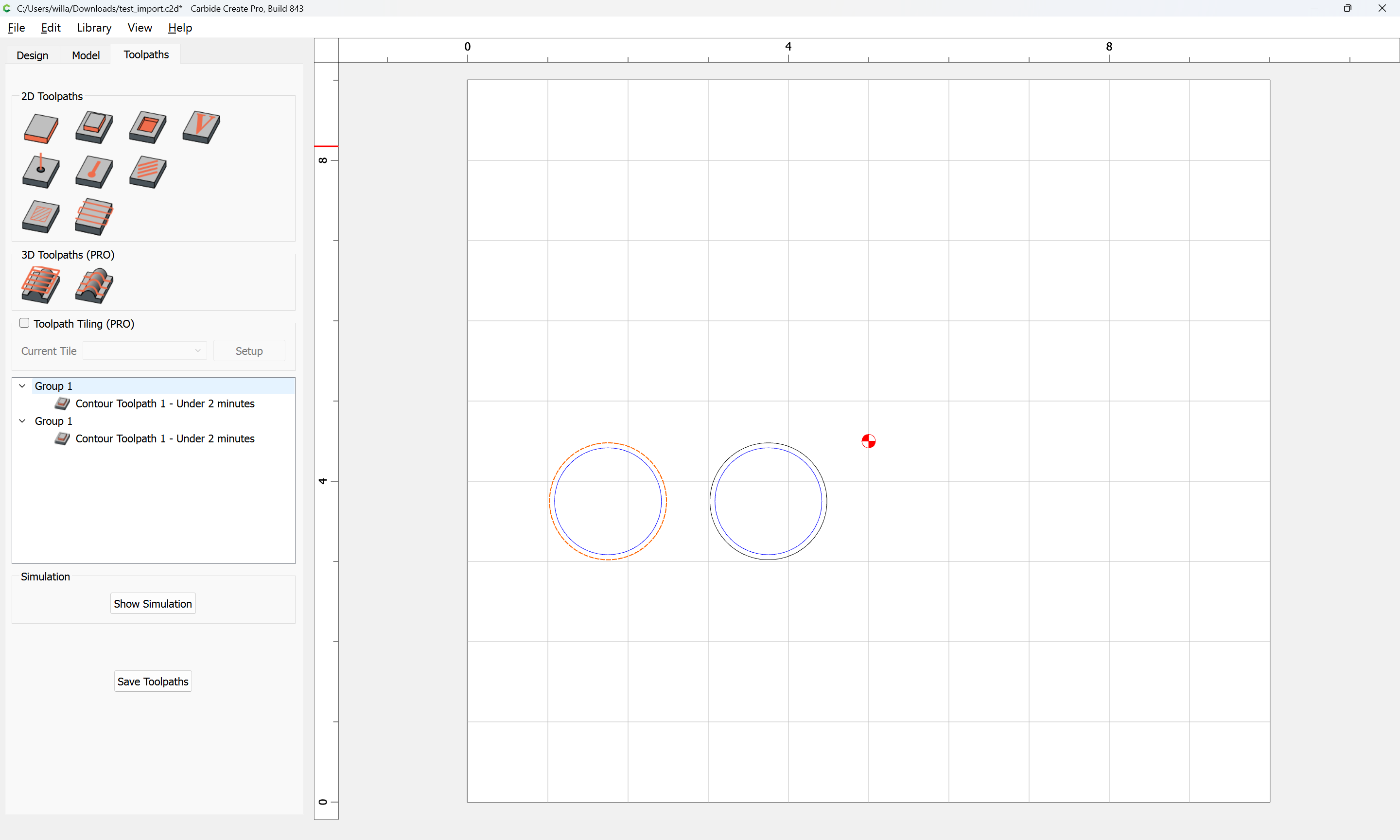

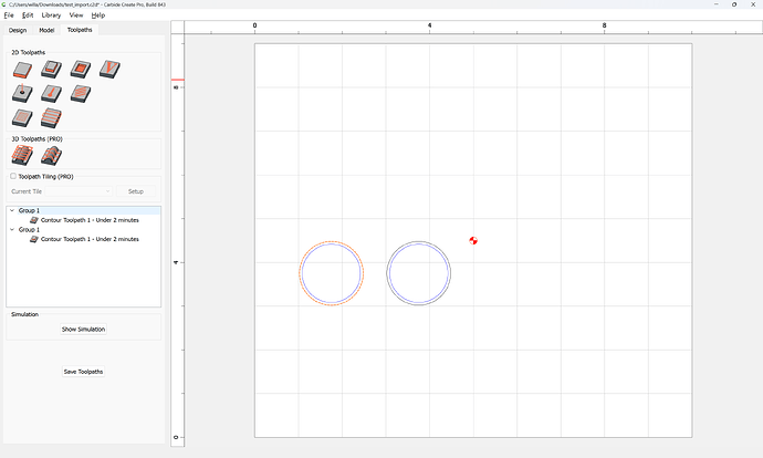

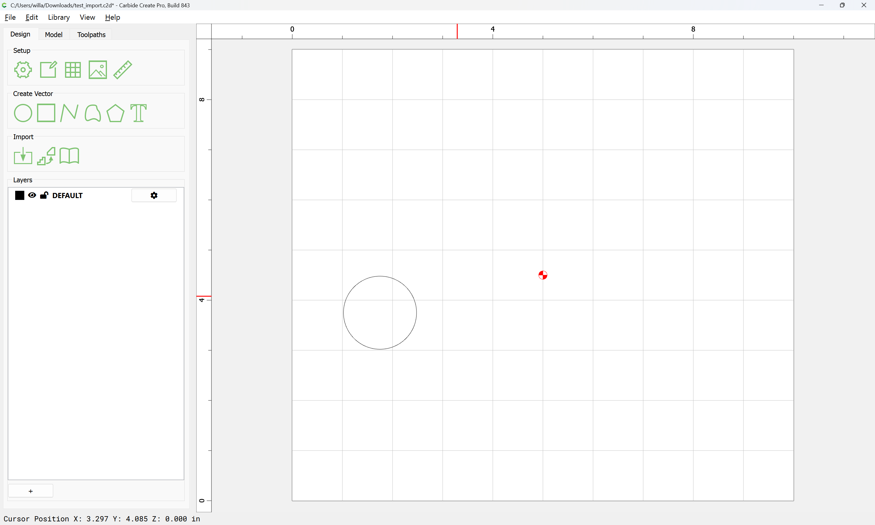

The technique which would work for this would be to:
  • create the file and save it

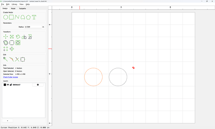

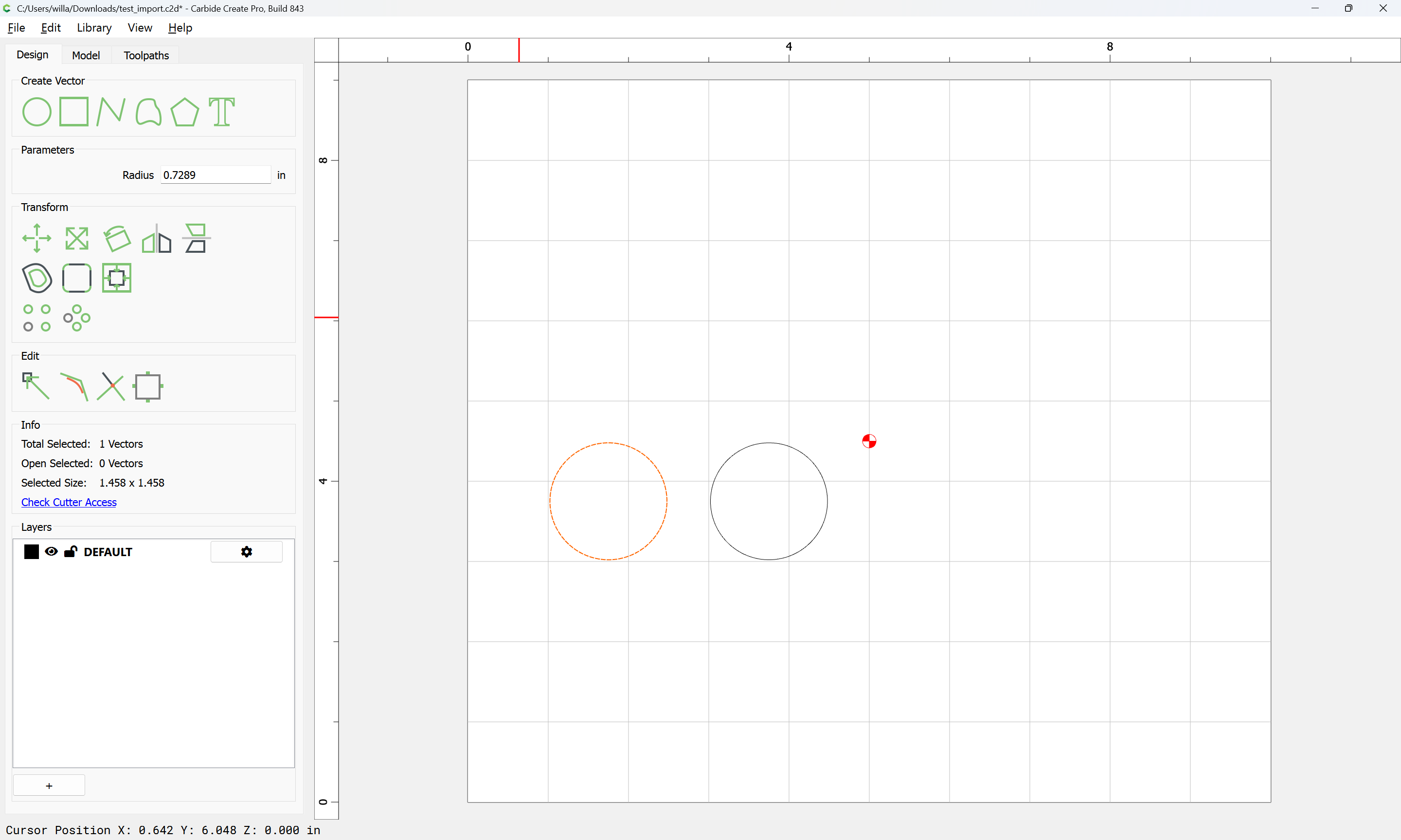

  • move everything in the file to a new location as dictated by the desired spacing of the batch produced parts
  • import the saved copy
  • repeat
I believe once one did a compleat row/column one could re-save the file and then alter the direction of movement and so forth.
Making the grid dimensions should make all this go a bit faster:
You, sir, are a steely-eyed missile man - that worked great! :smiley: I forgot to do the “move everything first” step but I don’t think that is needed. The imported objects are auto-selected after import, so I just clicked-and-dragged them together off to the side, where I could then rotate and position them appropriately. I thought maybe I had to preemptively rename the toolpath group but no - it just ended up with two “group 1” groups, which of course I then renamed.
You saved me hours of work - many thanks! Now hopefully my initial design doesn’t change, or I will be redoing all of these steps again! :crazy_face:
