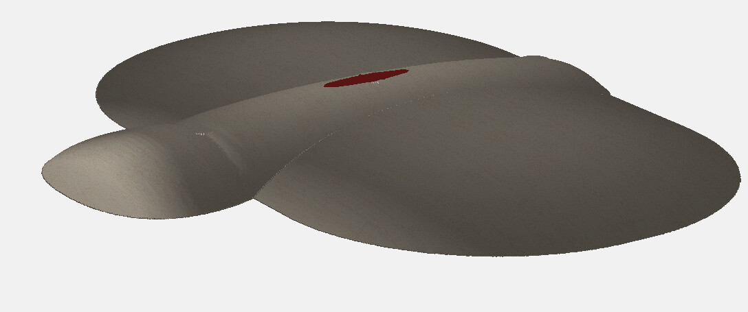

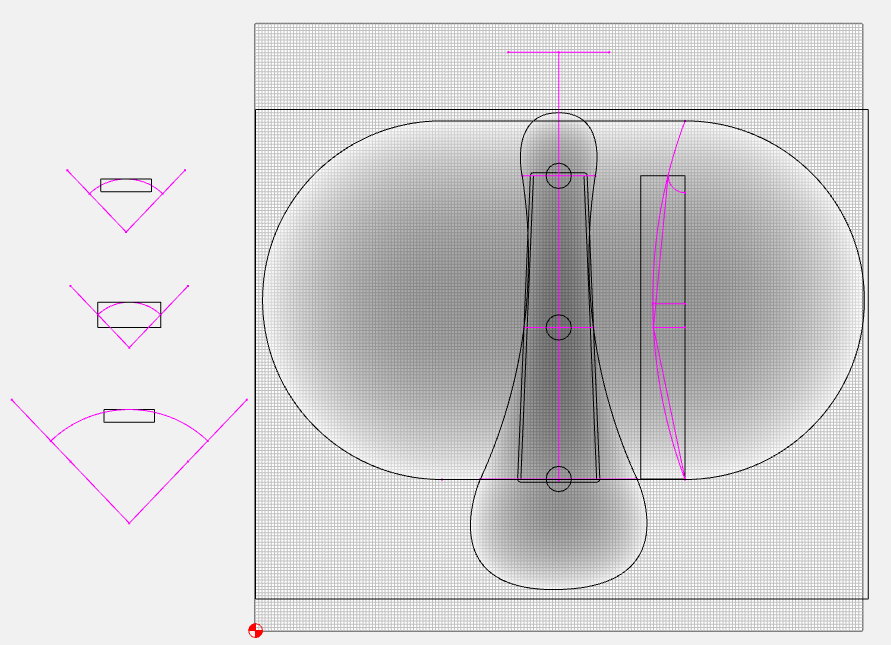

But I had to give it the old college try in CC Pro…
You have to make the workpiece quite a bit bigger to accomodate the model.
This is 48" x 48", and 3.5" stock height.
I extended all 3 top radii to a 43.6° tangent, and then measured the height. Using the difference from the total height, I constructed the long curved base solid. So it’s 2 pieces, the larger base, then the rounded top. The bottom section is right at 2.5", plus the center section is 1" taller, so it worked out to 3.5" overall.
The 3 small circles are gage blocks, the ends being 2.5" tall and the center 3.5" tall. So there is an imaginary 1.5" base in the simulation.
The 3D model
The simulation, with a disposable pocket toolpath to display the remaining shape.
Bozo_curved_surface.c2d (1.3 MB)

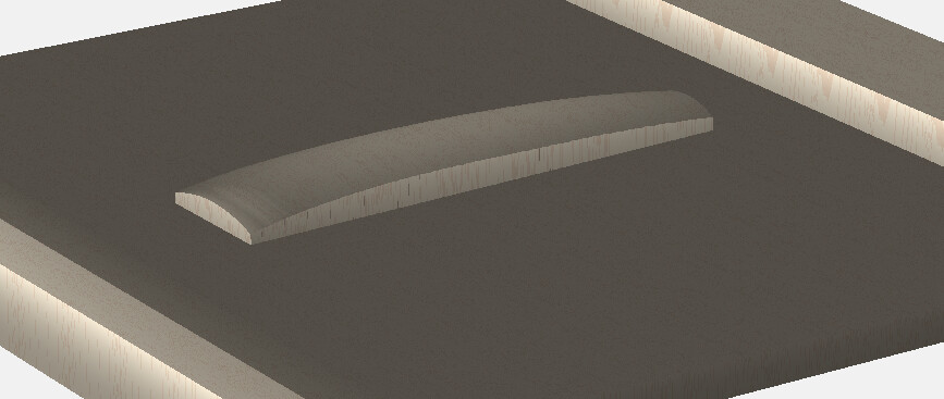

It was a typo. “Loft” instead of “lift”.
And if you look at my second post with image and stl file attached. It automatically curved it and did not leave a sharp edge.
I saw the image, and it looked good, but it looked like one end was too tall. I am not sure if that was just the perspective or what.

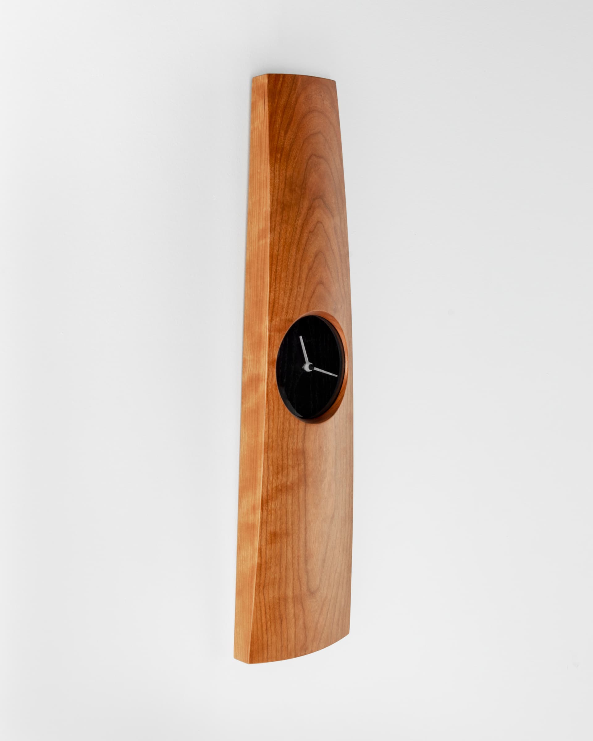

The compound curved board is very similar to this:
I thought it might make a nice back for house numbers. Cheers.
OMG - it’s $800!
Drop in a $10 clock…
I guess one could make a clock if wanted. ![]()
