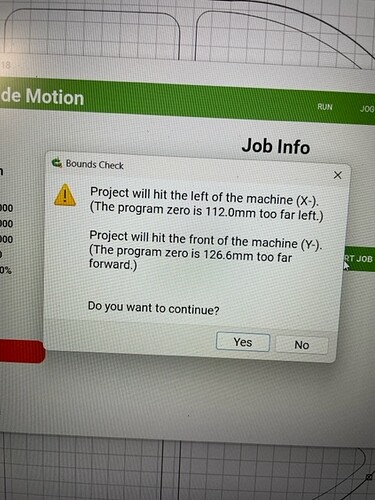

Why is it doing this? I tried an air cut and it was definitely going outside its limits.
Main Tray.c2d (376 KB)

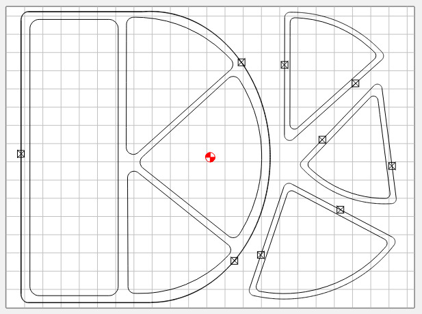

Your zero point in that file is in the center of the job. Do you have at least 11" from the left edge & 8" from the front edge to your zero point on the machine?
Ahhh! Good catch! However, when the machine asked to go into “Park” I said yes and it slammed into the home position. And thank you sooo much!
When jogging the configuration stops the machine before it hits the mechanical stops. However during running a job there is nothing stopping the machine from crashing into the mechanical limits.
C3D implemented this checking a couple of versions back. I guess you could call it a sanity check of your job.
It’s busted me a couple times too. With the new warnings, we should set the zero BEFORE loading the file. But the preview also shows you where the zero is as another sanity check. (which is good)
