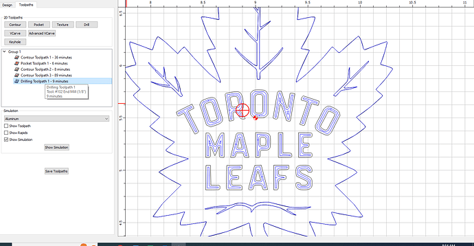

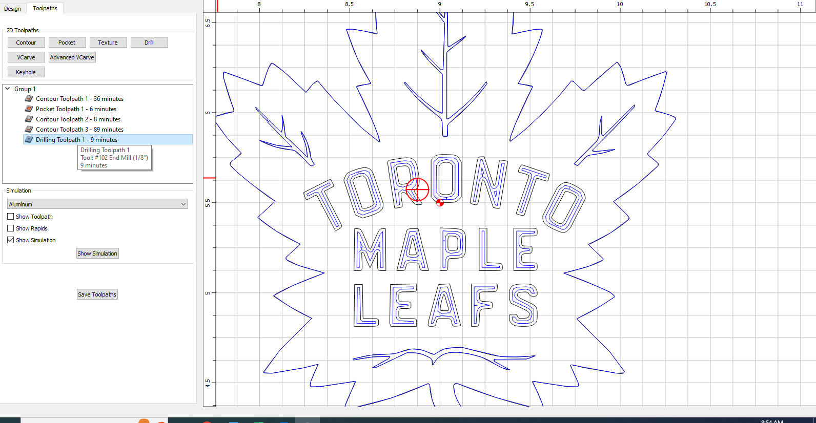

I am making a cribbage board and have set all the toolpaths. For whatever reason though, Carbide Create wants to drill a hole near the centre of the piece even though there is nothing in the design for it. How do I go about getting rid of this?
Please post the file. So we can take a look.
Can you edit the toolpath then choose select current vectors to see what lines have been selected for the toolpath?
I found the culprit! A line under a line… Thats what I get for ordering from etsy. Hahaha. Next time better off doing it myself after all the editing I had to do anyways. Thanks for the help!
