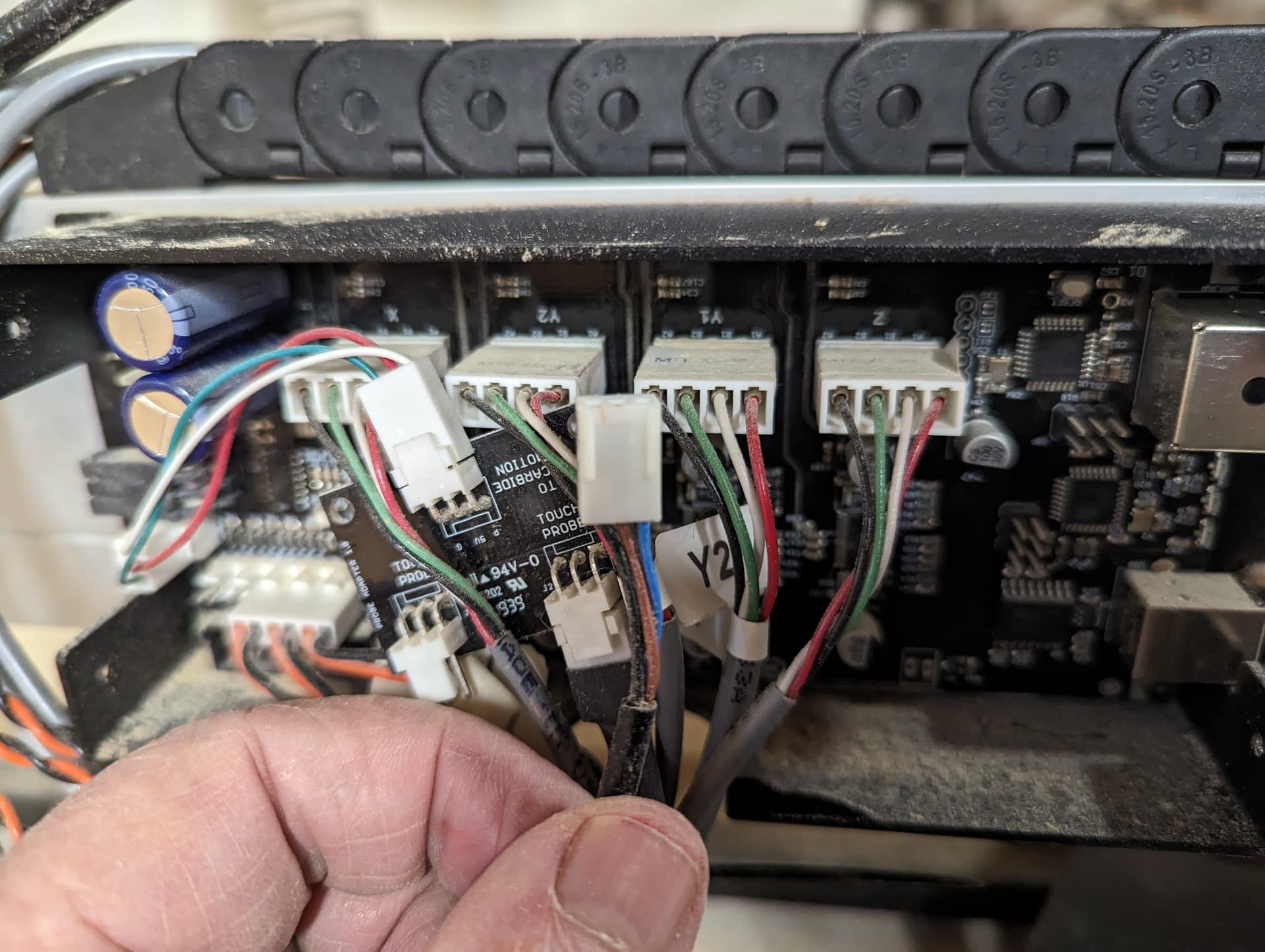

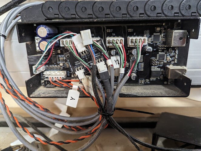

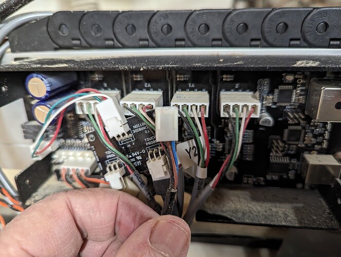

I went and opened the side of the enclosure to expose the controller. I opened the controller housing and it appears that the cable that runs from the bitsetter to the controller is disconnected on the controller side. I suspect that while I was rooting around tring to figure out why my machine died the other nite, I pulled the wrong cable a bit too hard.
I’ll attach pics. Second image shows the suspect piece
Does the manulal show where that plug should go on the motherboard?
Just need to know where this goes and I think we’ll be good. Yay.
See:
There is great rejoicing in the shop.
With the manuals help I was able to home right in on the solution.
I haven’t run a full init yet, but with the machine powered up and pressing the the bitsetter button the red light responds. So I’m pretty sure all is well. I want to button things back up after lunch, then get back to work.
