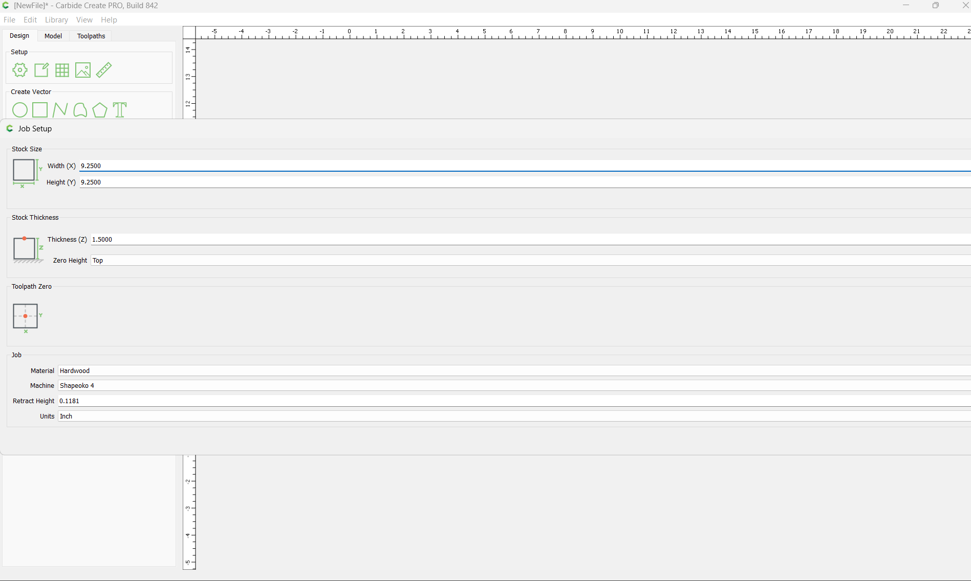

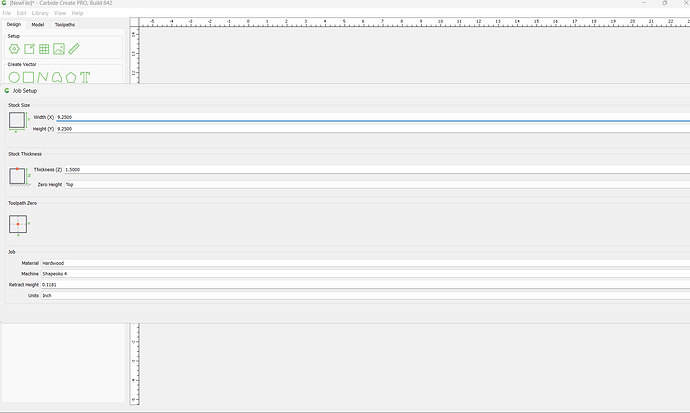

Good day, Having an issue with the job setup tab in CC build 842. The job set tab opens in an exploded view right to left about 5 screens wide. How can adjust it to fit screen? The double arrow window resize function does not work.

Post a screengrab?

It looks from your screenshot that the workspace window is also flying off the screen. I wonder if the two are related? (Not a CC user but sensitive to UI stuff…)
The icon in your title bar shows the window is maximized.
Could it be a resolution setting in your OS? If you non-maximize the window can you try resizing it and then re-maximize?

The issue has been resolved! I had uploaded a tool database from IDC Woodworks and it was causing the problem. Deleted the tool database through the tool library tab. But also had to go into CC program folder (Tools) and delete the excel files for it there.
