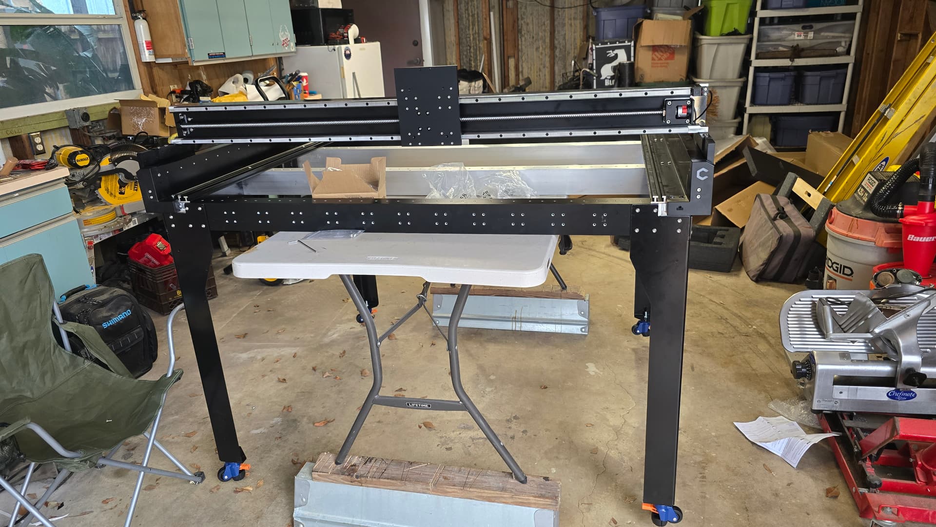

Yes, it is pretty heavy at that point. Not too heavy, but enough so to be awkward and really should be a 2 person maneuver. My build table was a plastic topped folding table that wasn’t tall enough to build the machine with the leg kit on it. So i put collapsed steel sawhorses on the ground and put the build tables legs onto those for the extra height. Once the machine legs were on, I just held up one end of the machine and build table and kicked the sawhorse out on that side, then walked around and did the same on the other side. Probably not the best way to go about it, but it worked well for what I had to work with.
Hey Gary if the drag chain is the same size as mine it’s super tight putting the chiller lines in with the cables so I recommend you roll out the lines to give them time to relax. With the colder weather they are harder to fit in the chain. The hdm chain is bigger that is better fitted than the 5.1 for the chiller lines . Danny
Thanks, I have about a million of those metal sawhorses that I could leverage. Come to think of it I have a collapsible and expandable rolling outfeed stand. I could put a board on top and then roll it off once the legs are on. Keeping it from rolling around and being annoying while building the frame may be a challenge.
Which wheels did you use and do you feel like its stable enough with them on there? I have been concerned about wheels that are not retractable.
So, I found these on Amazon. They are retractable via a little ratchet system that raises or lowers the feet. They work great and the machine moves around like its on ice when the wheels are down. When the feet arw down it seems very solid. The movement of the machine doesn’t make ot wiggle or slide or anything. I would absolutely NOT use the machine with the wheels down as I think just the moment of the gantry would have this thing walking all over. Lol.
Here is the link to the casters
https://a.co/d/019YgMwO
Ok thanks. I didn’t zoom up enough to see that they were the retractable ones.
