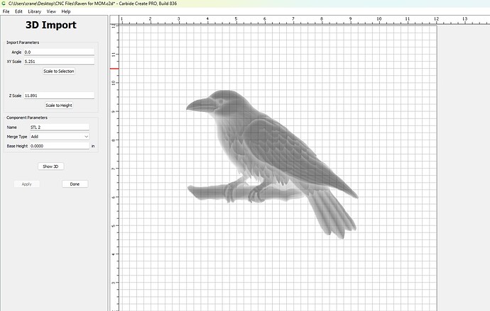

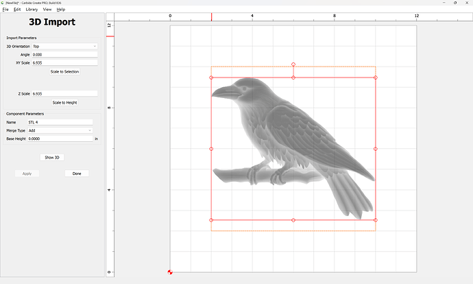

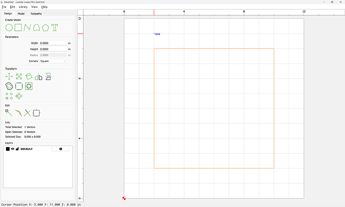

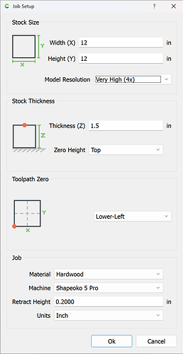

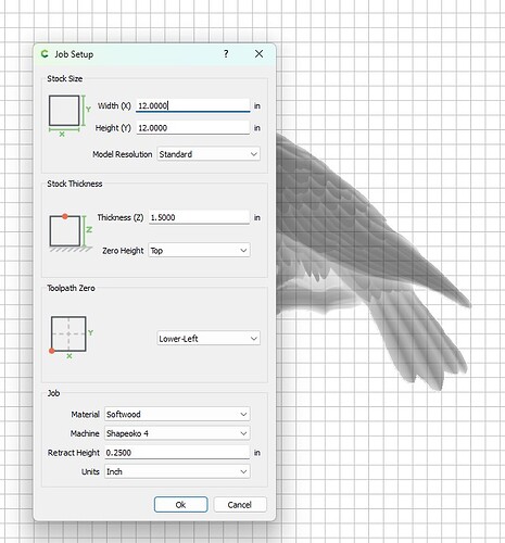

  1. I have set up the stock 12"x12"x1.5" (glued up poplar)

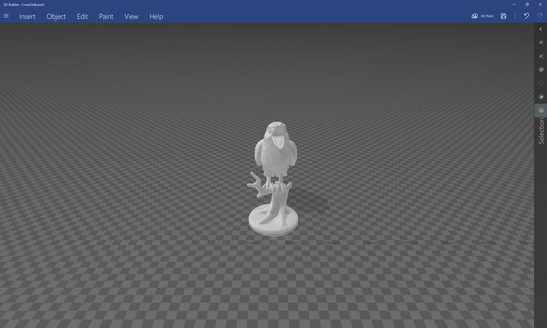

Imported the STL, a raven on a branch.

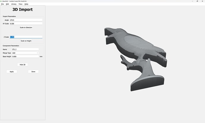

Can anyone define the below.
Import Parameters:
Angle?
XY Scale?
Z scale?
what is the base height?

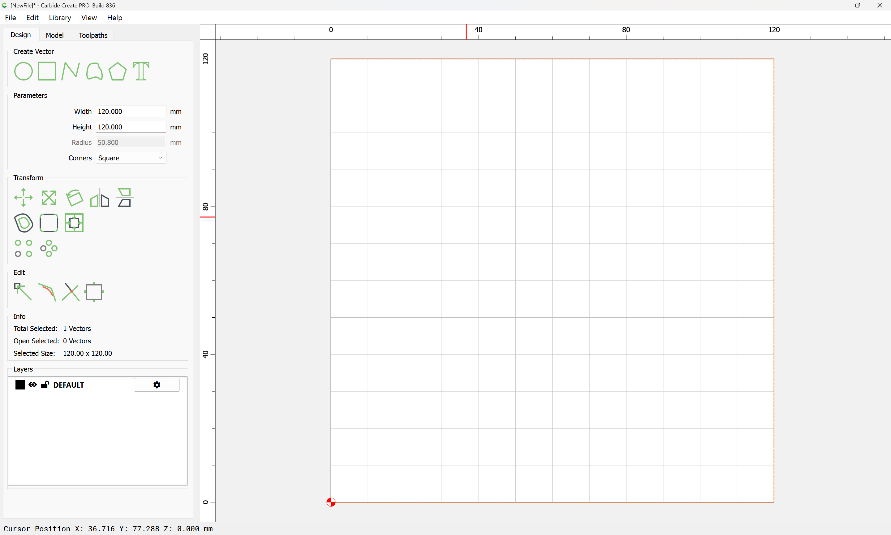

Right now I have the raven model section and all I see in when I look at the 3d in the raven image not the outline of the stock. There is something very simple that I am missing I am sure. In all the videos I have watched there is an assumption that know something.

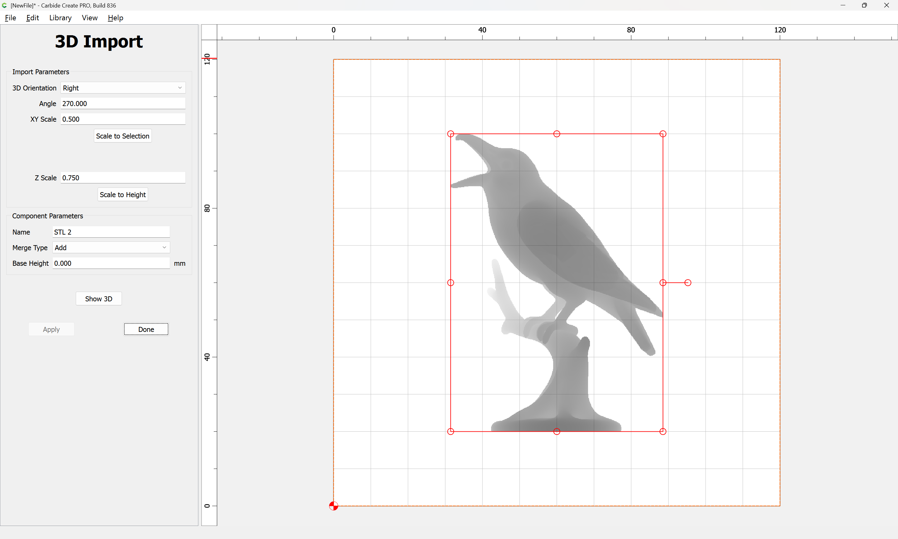

I have attempted to include pictures of how it is set up.
Thank in advance.
John

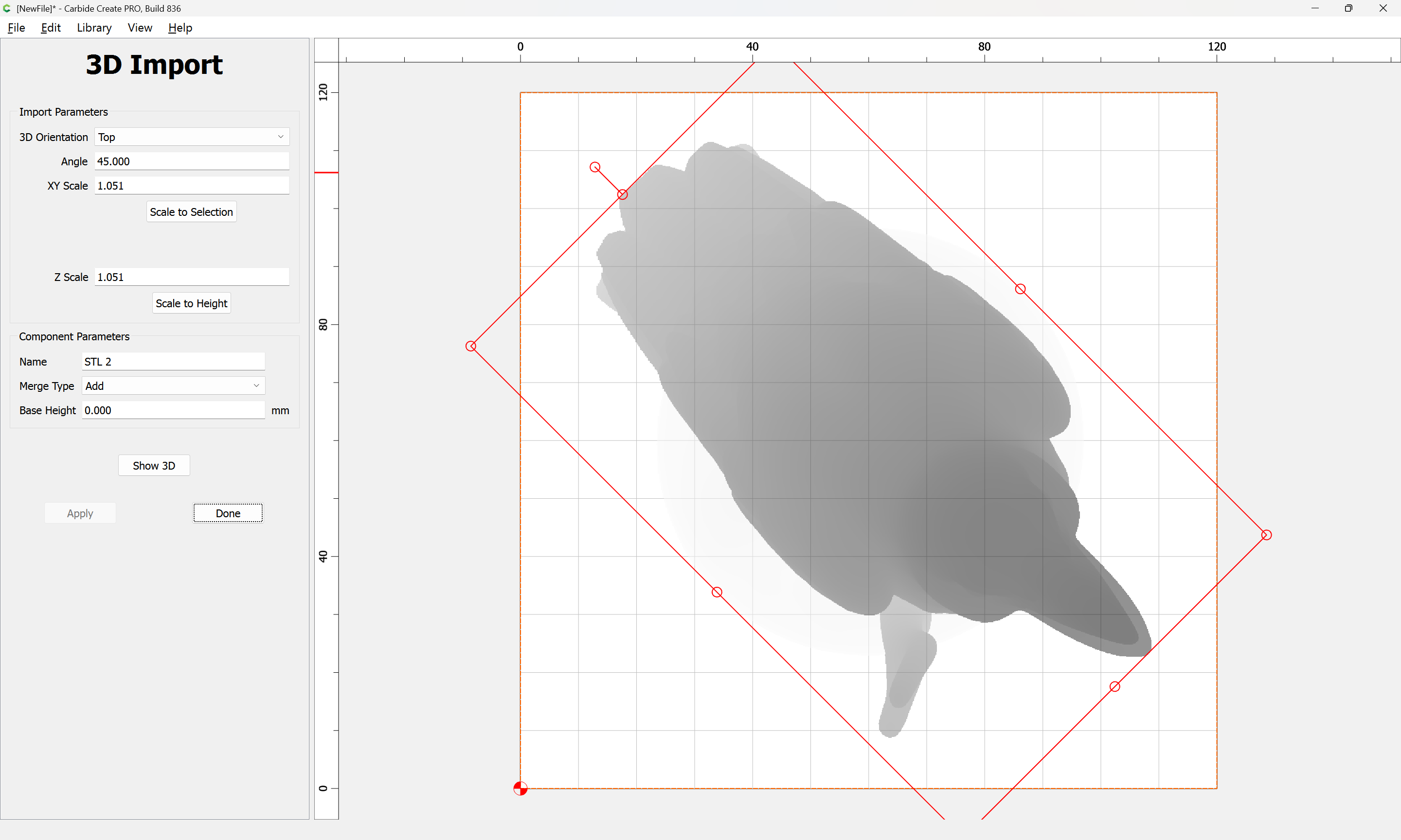

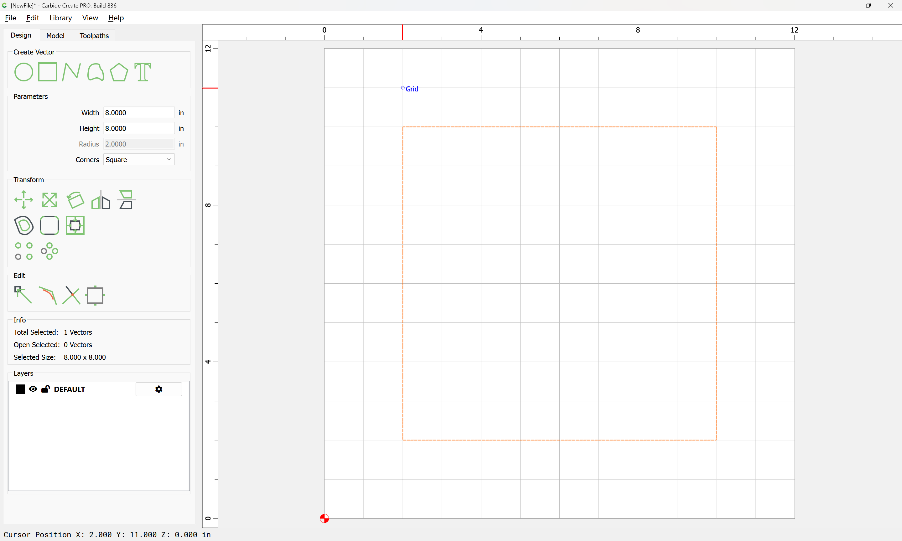

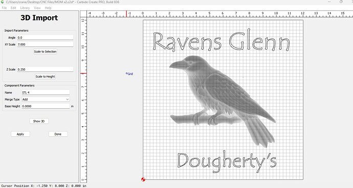

STLs are 3D models:
It is necessary to select geometry to determine the centerpoint at which the 3D model will be imported at:

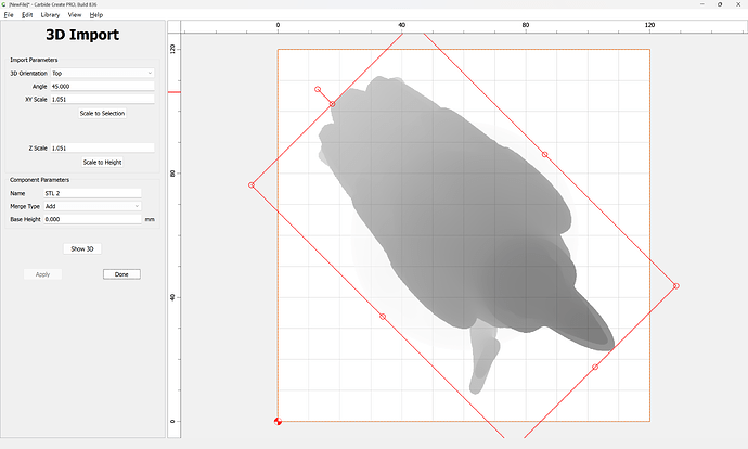

The Angle determines at what rotation angle an STL will be imported at.
changing it rotates the model:
XY Scale determines how large the imported model will be along X and Y:
Z Scale determines how large the model will be on the Z-axis of the stock:
Base Height will add additional thickness so as to place the model in terms of Stock Thickness:
If you want more control or a more dynamic interface I would recommend:
Thank you for the slowing things down for me. I was able to find where some of my errors.

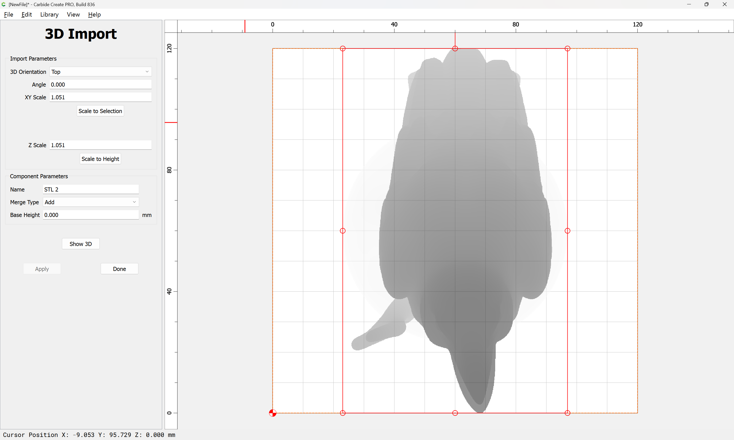

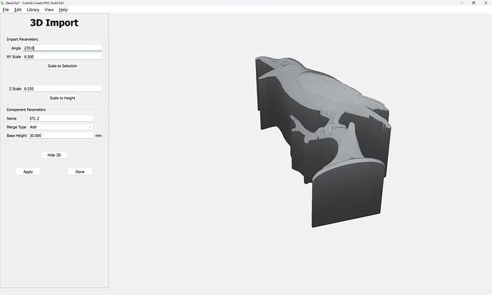

How do i get the Raven to be a part of a small piece.
I am attempting to put the raven in the center of a 12"x12" X1.5"

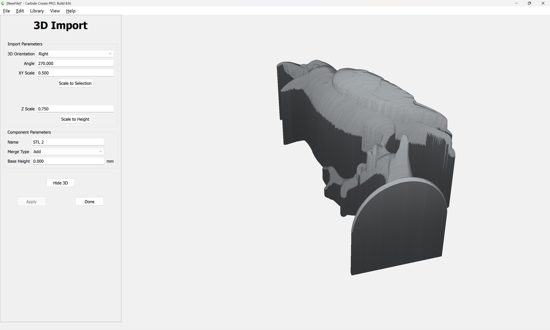

When I add base hight teh image disappears.
John

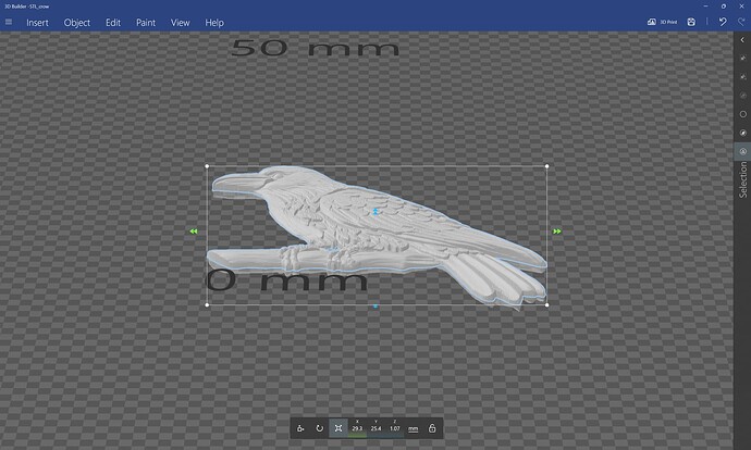

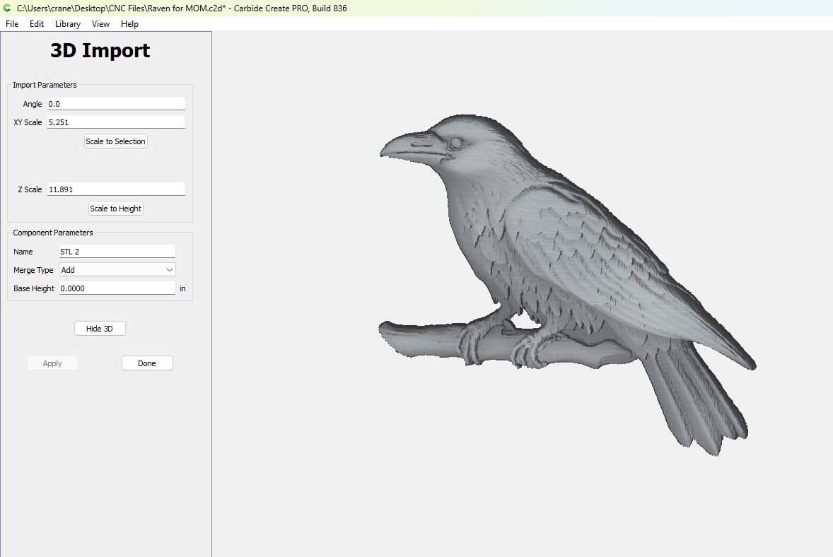

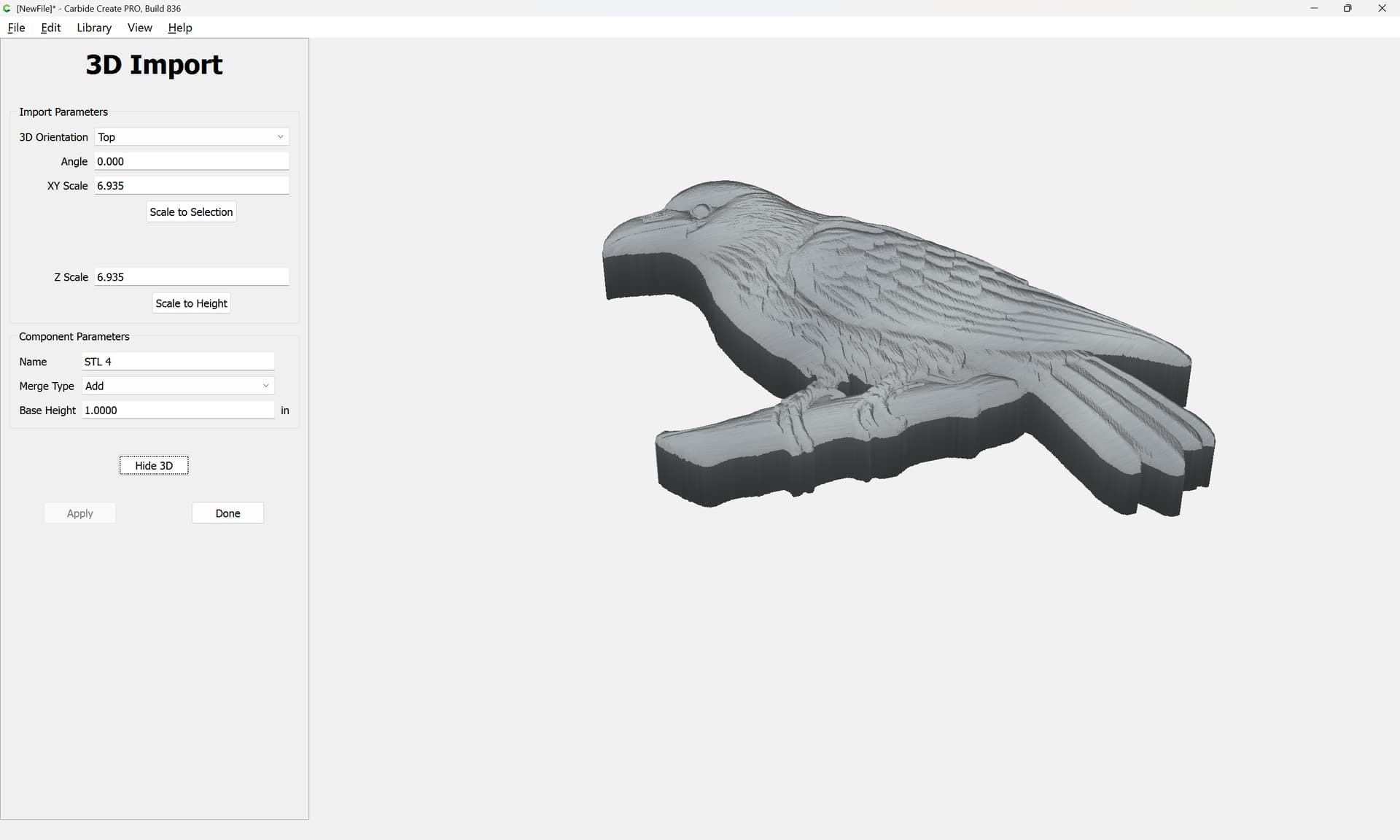

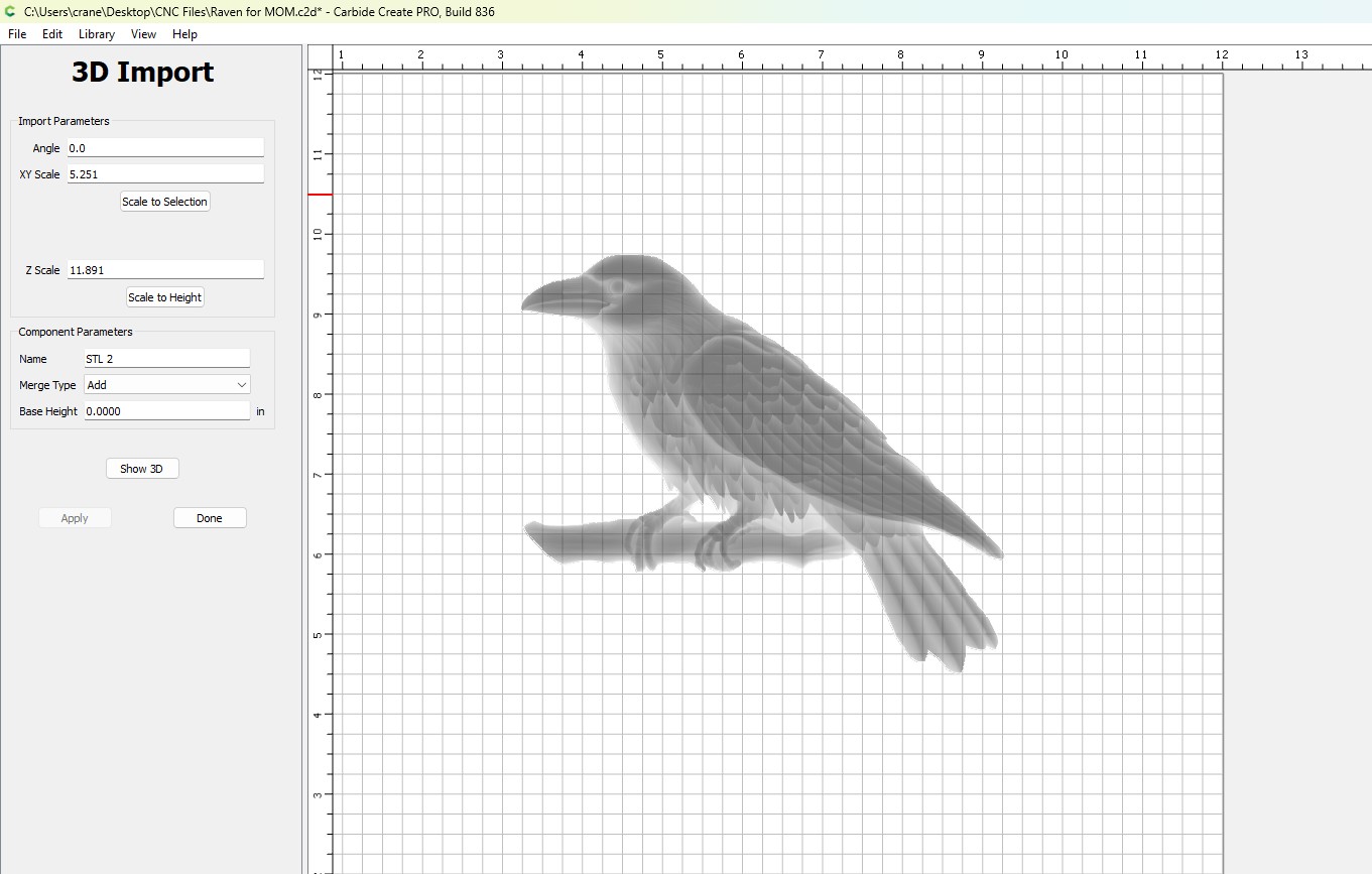

Please send the STL which you are having this difficulty with, and a screen grab showing the problematic settings in to support@carbide3d.com and we will look into this with you.

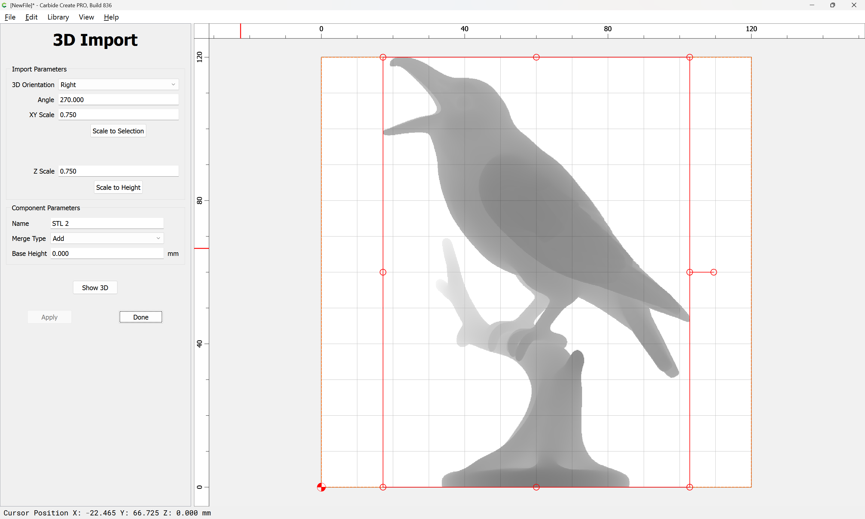

The file in question is invalid, and needed to be repaired — once repaired:
It was re-saved and when imported into a suitable file:
worked as expected, even when Base height was added.
