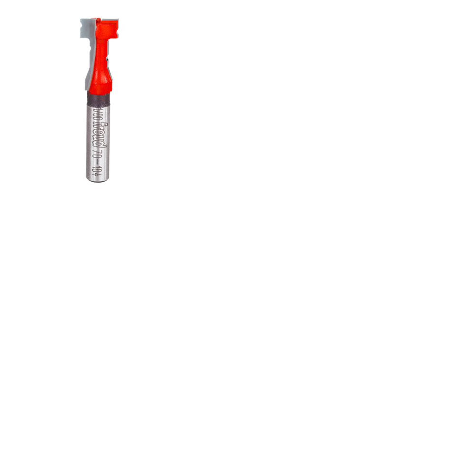

Here is my custom tool for the Freud keyhole bit.
| number | vendor | model | URL | name | type | diameter | cornerradius | flutelength | shaftdiameter | angle | numflutes | stickout | coating | metric | notes | machine | material | plungerate | feedrate | rpm | depth | cutpower | finishallowance | 3dstepover | 3dfeedrate | 3drpm |
| 701 | Freud | 70-104 | Keyhole | end | 0.39 | 0 | 0.25 | 0 | 0 | 2 | 0.125 | 0 | 10 | 60 | 16000 | 0.4375 | 1 | 0 | 60 | 16000 |
It is specifically for the 70-104 Keyhole Bit. Similar bits would likely work.

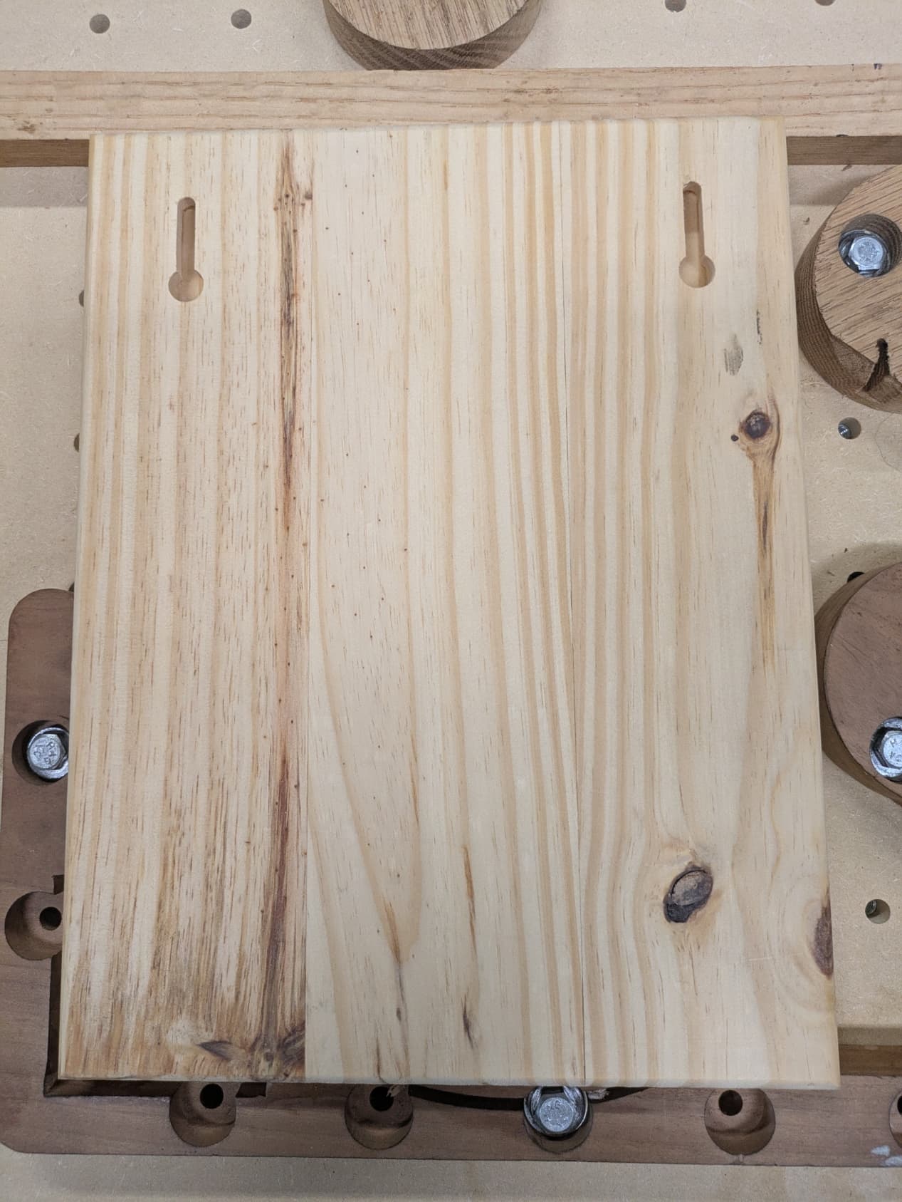

Just made some keyholes yesterday.
Those are the settings I use on my Boomerang 3/8 keyhole bit and it startles me every time I use it because it’s loud and fast. I wonder if slowing the feedrate a little bit would help
Yesterday I cut 2 keyholes. I had not cut any in a while. I agree with you that it was startling but it works. Slowing down the feed rate would not really hurt anything. Just dont go so slow you dont get any chips.

Also, do you guys pocket out a hole first for the big end to drop in or just plunge that baby straight in?
I plunge that baby right in
I’ve done both, in hardwoods I’ll run a pocket first with a 0.125” up cut then run the keyhole bit. If its a softwood I just run the keyhole bit.
On the tool I provided for the Frued it just plunges in then drives forward, reverses and then comes out the entry hole. It is a very fast operation. In and out.
