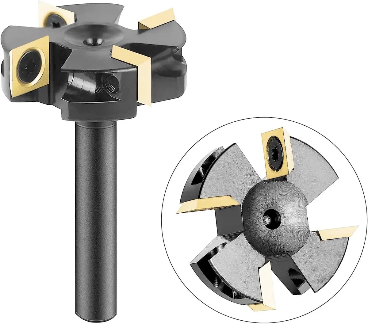

I have the ER11, 65mm spindle. I use a 1” diameter bit max. You should be easily able to use up to 2” cutter with the 80mm spindle. I have used this size on my router tables with no issues. My best advice with the new setup is to test, test and test your feeds and speeds.
Load up a slab and send it…… start with lite DOC’s and listen to the machine and go from there.
First make sure you are using the bit with in its rpm range. A lot of the non cnc bits aren’t rated for much rpm.

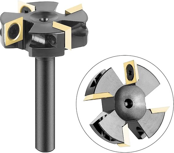

I regularly use a carbide insert 2.5” bit. It’s 1/4” drive ( part of an amana a set I bought years ago). Have zero issues with it.
I have tried to use a grizzly C3707Z 7 cutter 2” bit. I start having torque issues with it. I had to slow down feed rate to a point where I was having other issues at 1/8” doc
It may work for you but it wasn’t worth the frustrations in the maple and cherry I was dealing with.
I just use my insert bit up to 1/8” doc in hardwood at 275 ipm. I’ve raked 1/4” doc in mdf without issue.
I use a 1 1/2" planer bit, and a 3" sanding bit, both with 1/2" shanks.
I use them often enough that they just sit out on the bench & rarely get put away.

I have been thinking about getting the Haas 45mm surfacing bit. It is cheap, and good to 15K RPM. I have bought a variety of end mills from them and they work well, and are of good quality. Has anyone used any of their surfacing bits?

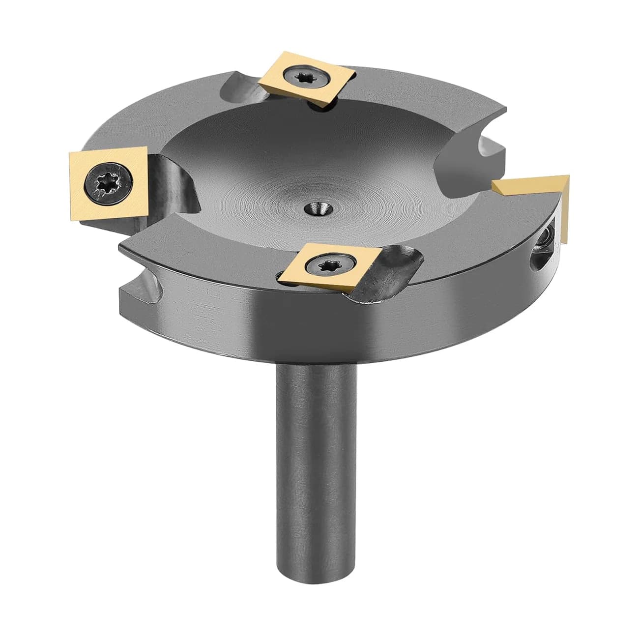

I was using a 40mm Spetool surfacing bit but also have a 75mm Spetool now. Using them with the 80mm spindle.
They are both great and create silky smooth surfaces.
There’s pros and cons though:
  • The 40mm is slower (obviously) but fits easily with the dust shoe working properly.
  • The 75mm (12mm shank) is an insane beast. Surfacing is very quick, but the dust shoe is not really fitting with this one so chips will be everywhere…
I have used a 2.5" bits with success. My best experience has always been with just a plain half inch upcut endmill. The IDC Ripper is one that I use often and while it is much smaller, you can run it at full speed and if you were to ever want to surface some stock that has a lot of irregularities in it, it just mows right through them.
I have the 80 mm water cooled spindle with 1/2 in collet and I use Spe Tool 2 in 3 inserted slab cutters exclusively they cut hard wood like butter and will easily handle a .375 deep cut at 12000 rpm and 100 inches a minute feed rate, and would take more probably. You have to disable the bit setter on this tool because of the bottom shape of tool but thats not a big deal. I hardly ever even need a finish pass even when my step over is 1 in. Also the 2 in fits brush dust boot. I use a lot of Spe Tool endmish and tools good quality and very reasonable prices!
