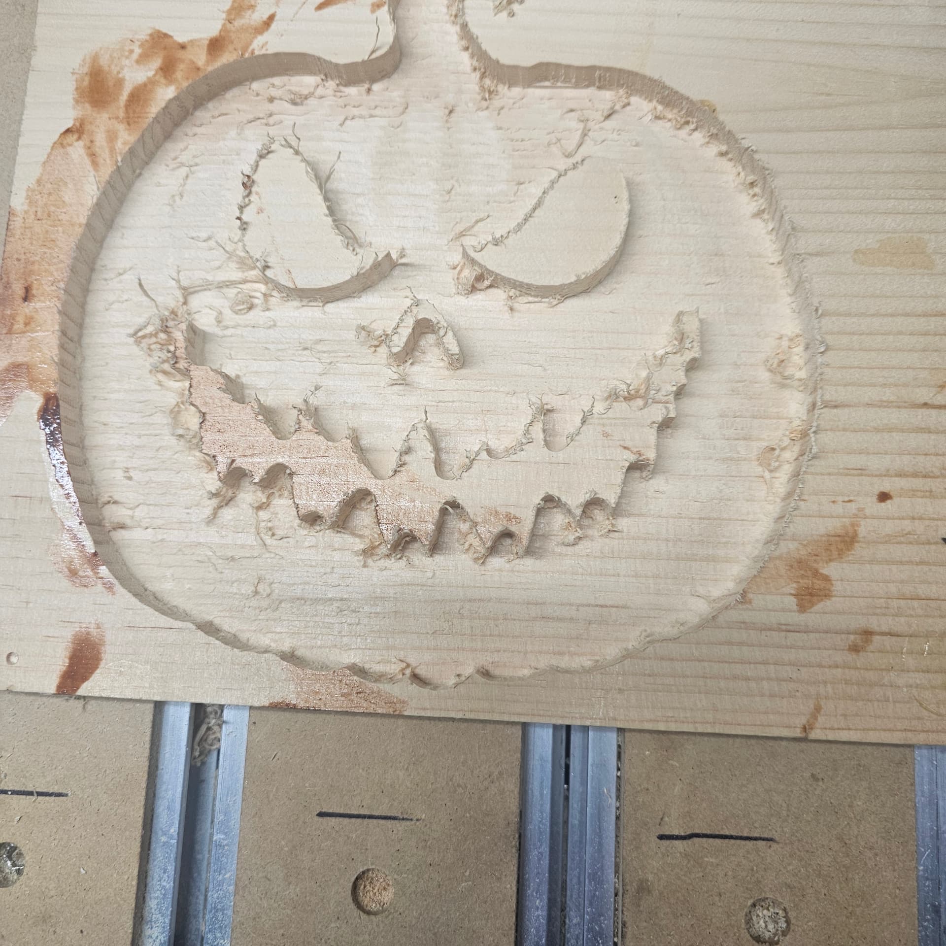

Have mad many successful cuts with the 4xxl, however bought the pro version so I could cut stl 3d signs and every time I do I get a pocket cut, I have changed toolpaths to everything listed and cannot get a 3d cut. getting frustrated. any help?

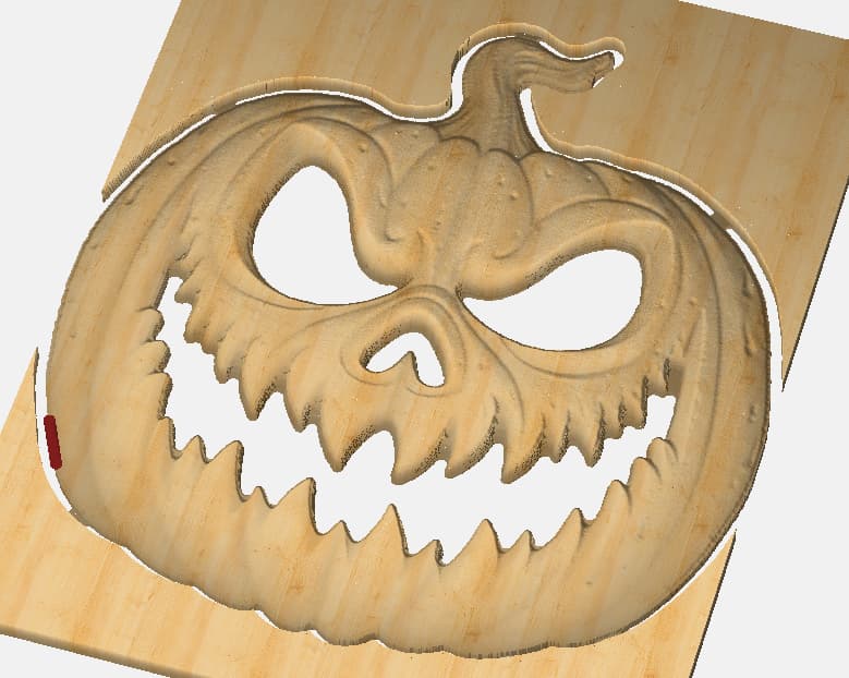

Instead of a 3d pumpkin I get a pocket cut of a pumpkin shape.

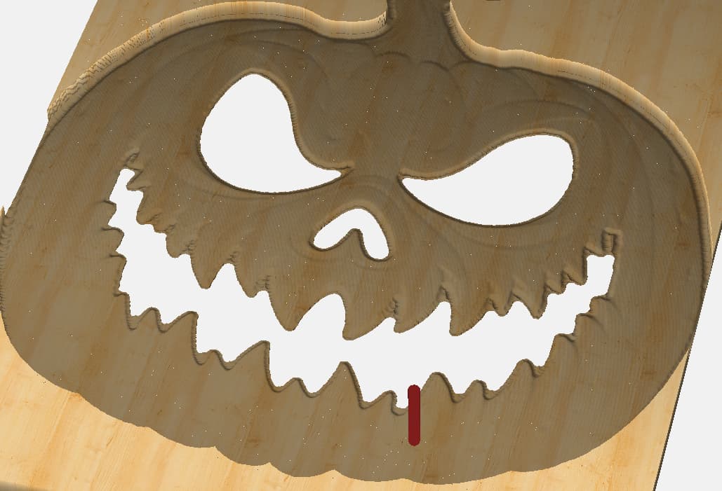

The 3D is there at the bottom of the pocket. You just need to cut out the face & outline.
It looks like you may have used the default height when you imported the STL. I would bump that up to your 0.5" stock thickness. If you only select the outside vector for roughing, it will clear out the eyes, nose & mouth.
Other recommendations: Use a larger tool for roughing. Use a ball mill for finishing. Not a lot of sharp detail on this model, so I would go with a 1/4" ball.
Add in your contour path to trim out the outline. Add a few tabs to hold it in place.
