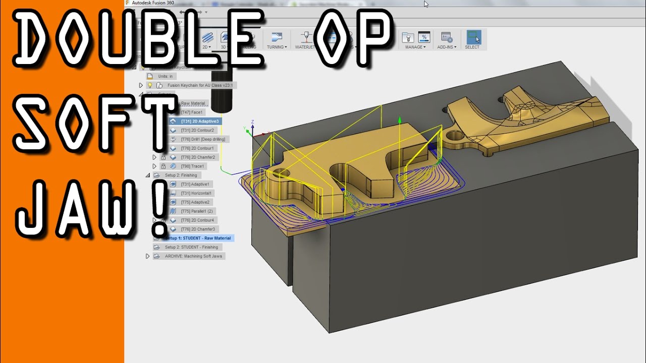

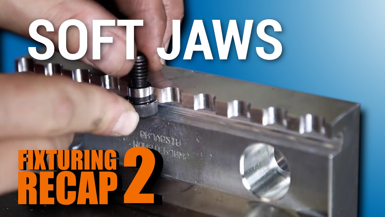

I do not, yet, have enough experience to effectively comment. I did learn from some NYC CNC YT videos. Here is a link to one of them.
And another.
