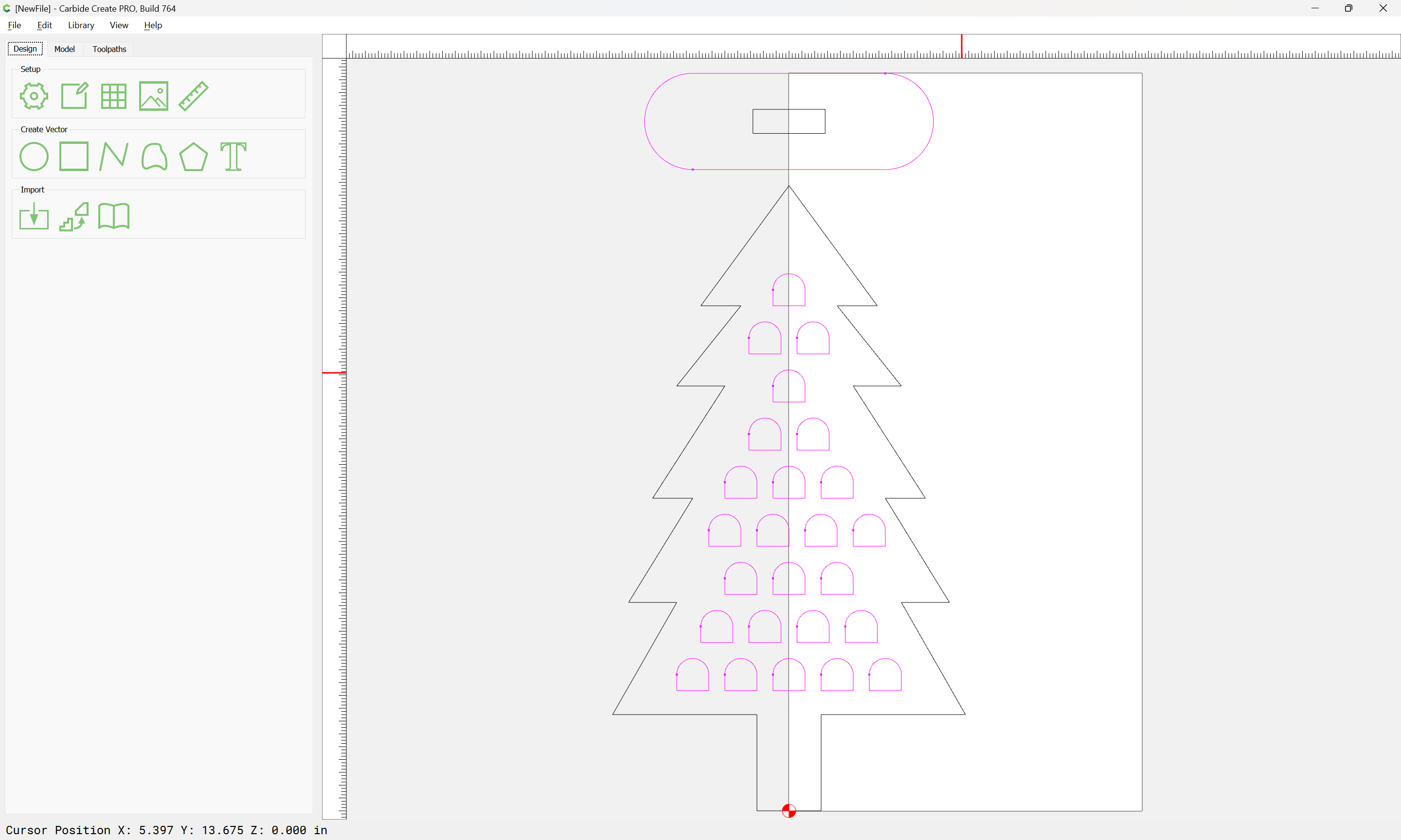

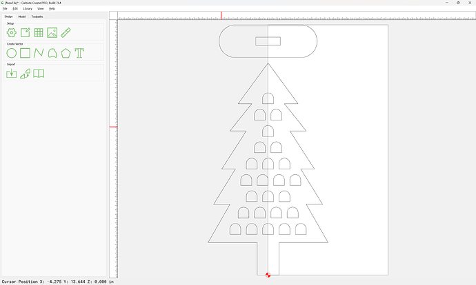

Advent Christmas Tree.dxf (192.6 KB)
Are these files showing up? If so, the toolpaths in Carbide Create are not working properly.

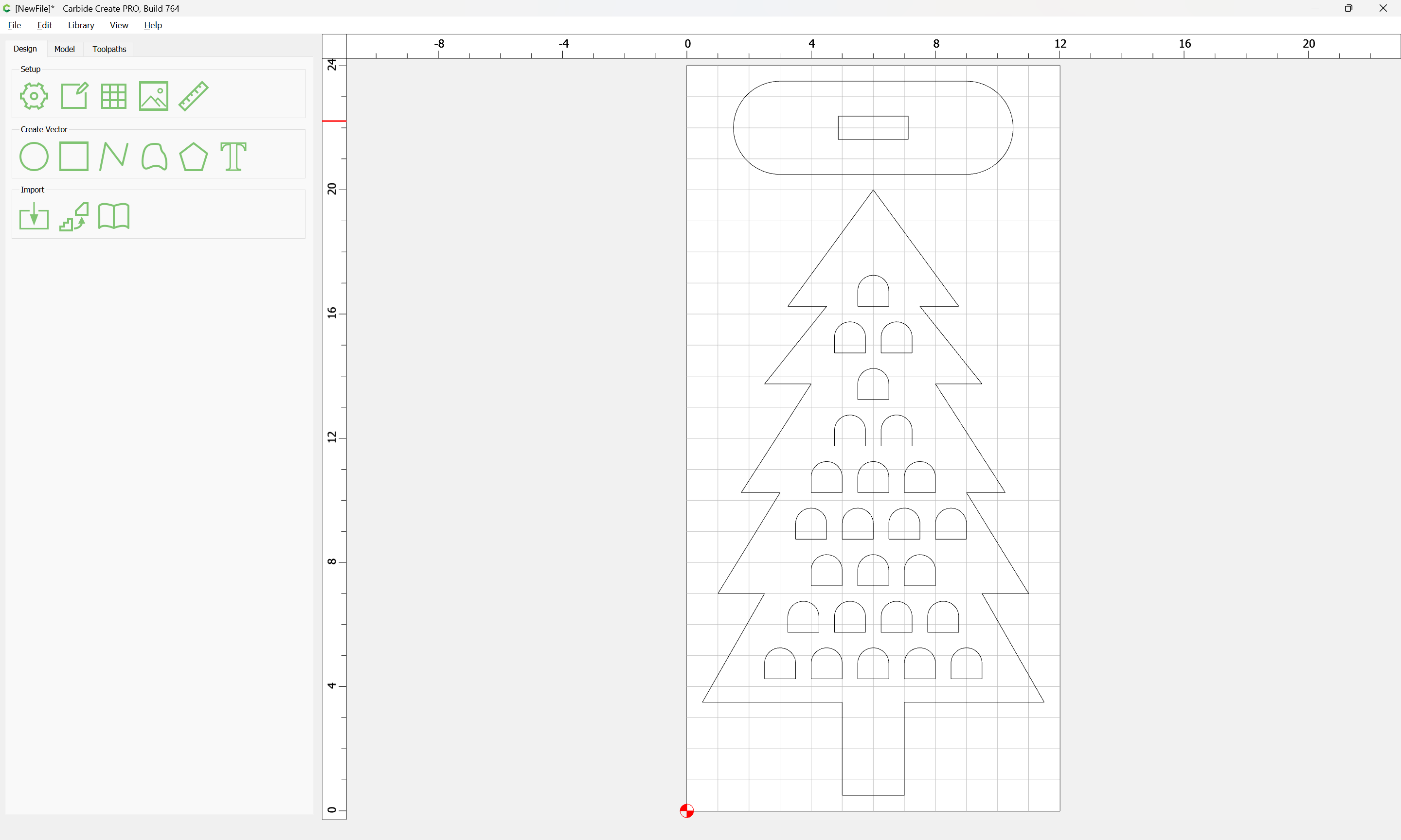

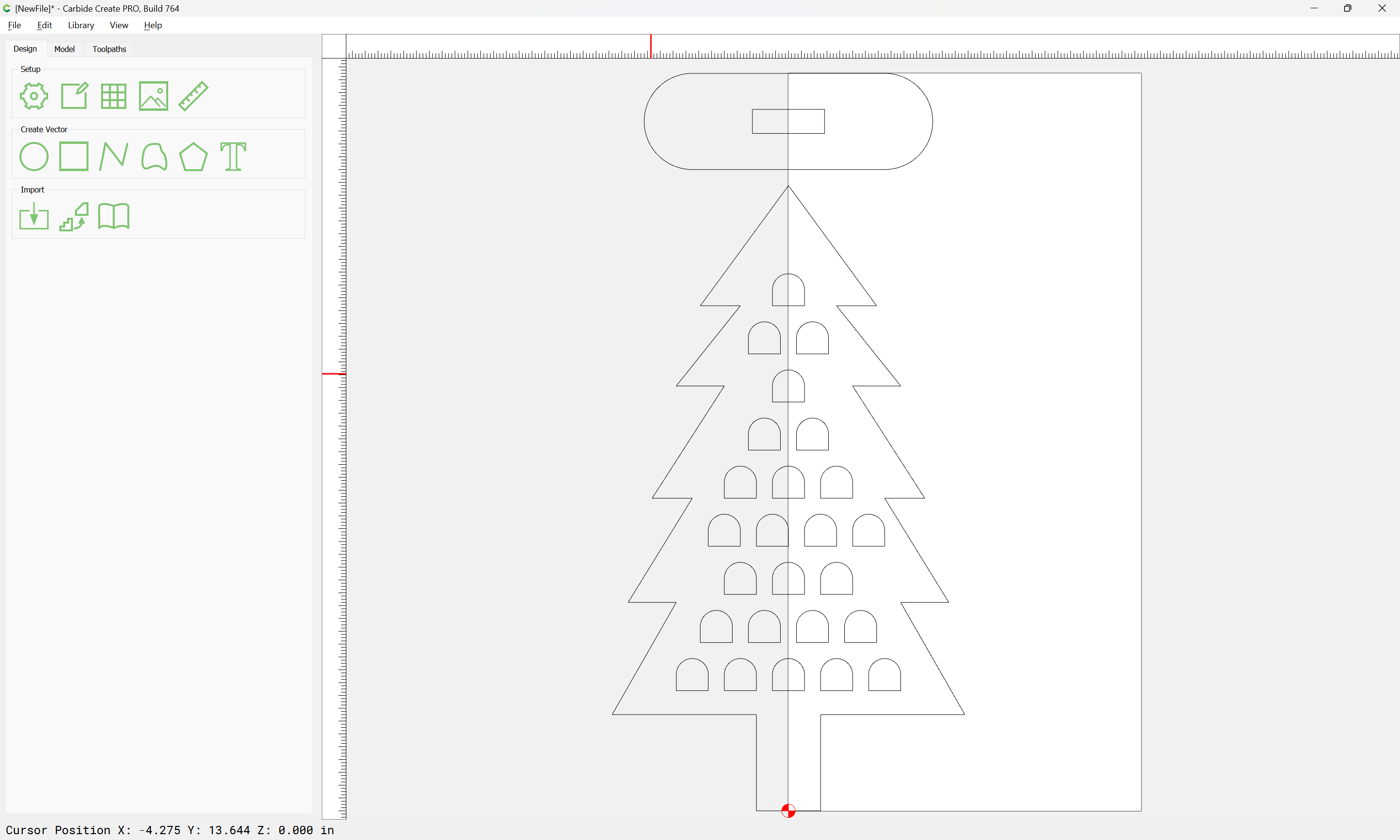

It looks like the dfx file showed up…let’s try the svg file:

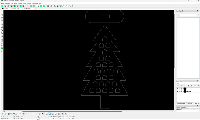

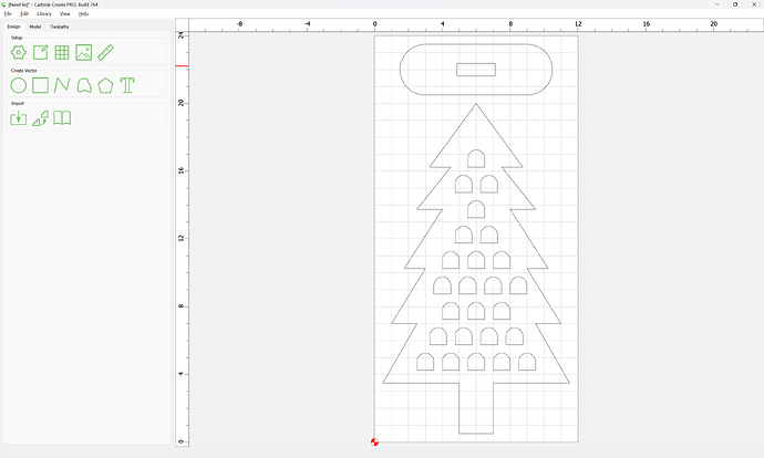

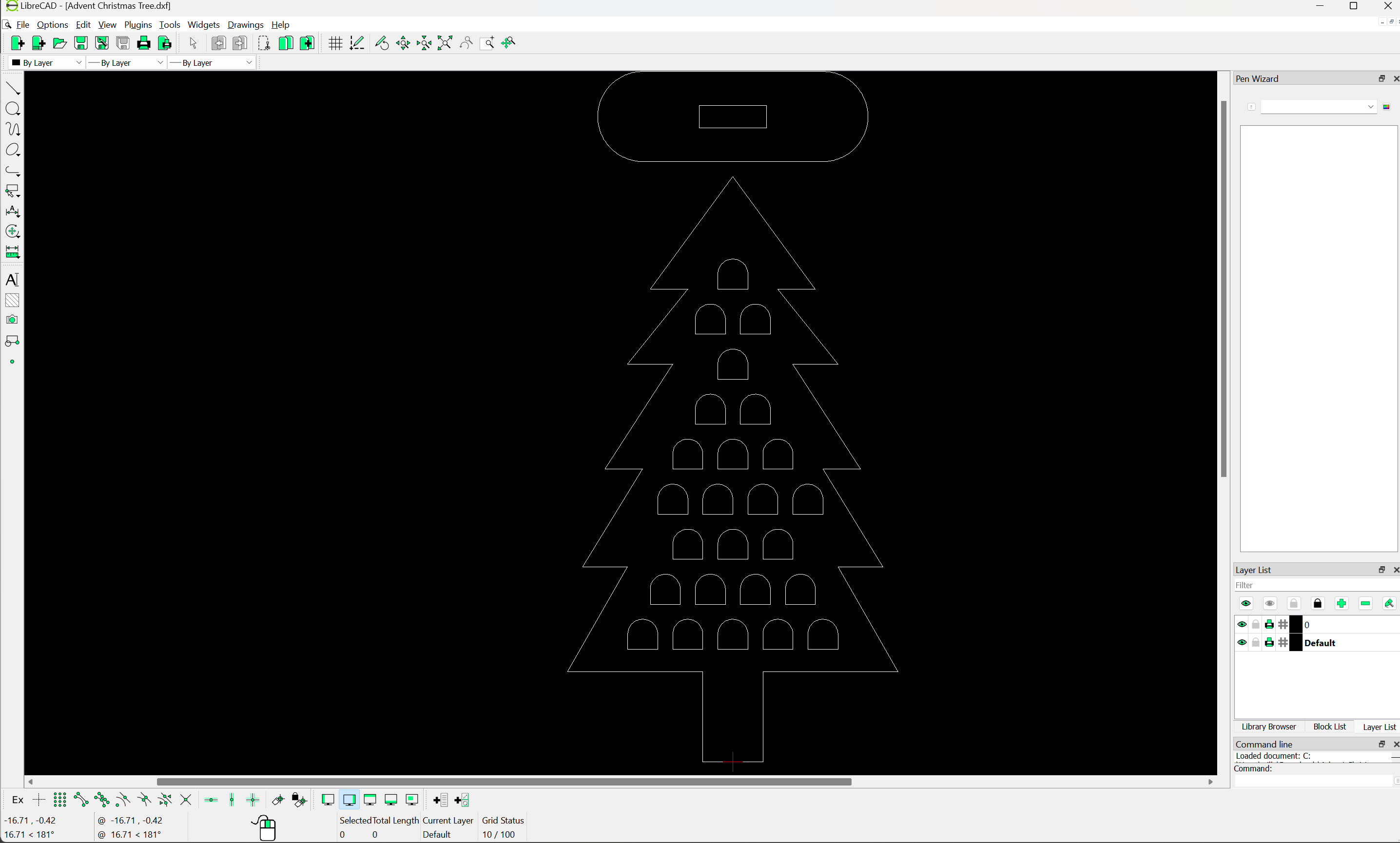

OK, it looks like these files are showing up. I created these on rhino cad… Any reason why the tool paths are not pocketing correctly in Carbide create?
The DXF seems to open okay in LibreCAD:

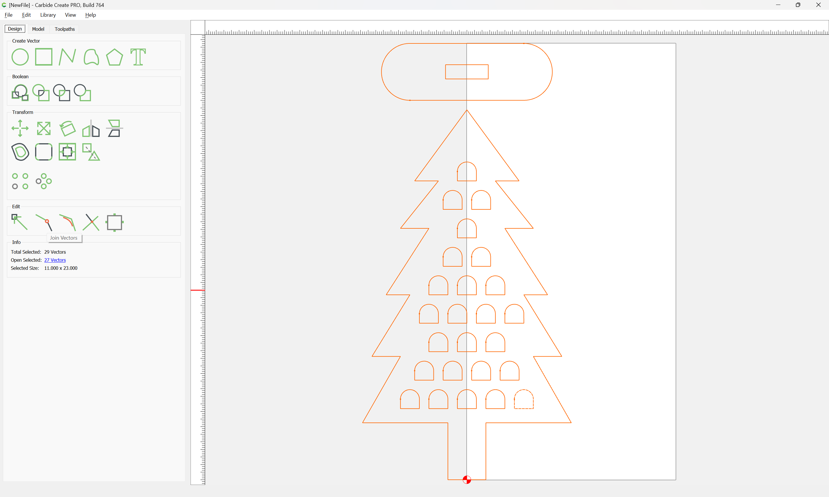

and when opened in the current beta of Carbide Create opens fine, just with some open/unclosed paths:
Note that open/unclosed vectors cannot be used for a Pocket toolpath since they do not define a closed region.
Selecting them and using the “Join Vectors” command:
yields:
which with a bit of adjustment becomes:
attached as a v7 file.
Advent Christmas Tree_v7.c2d (120 KB)
Awesome! This works, thanks. I didn’t know about the join vectors feature.
