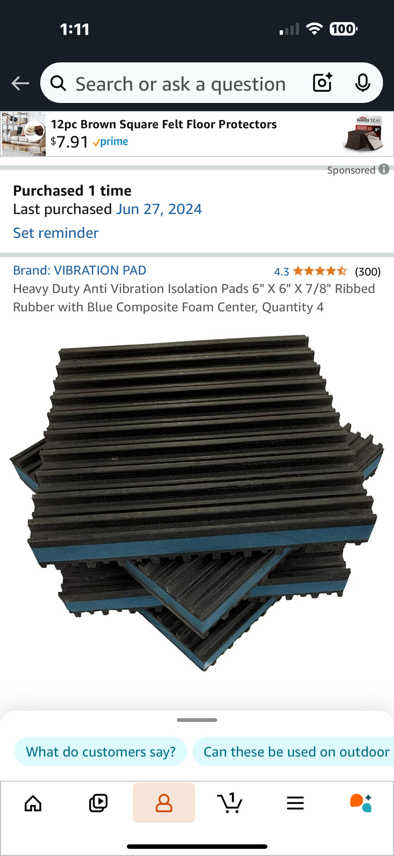

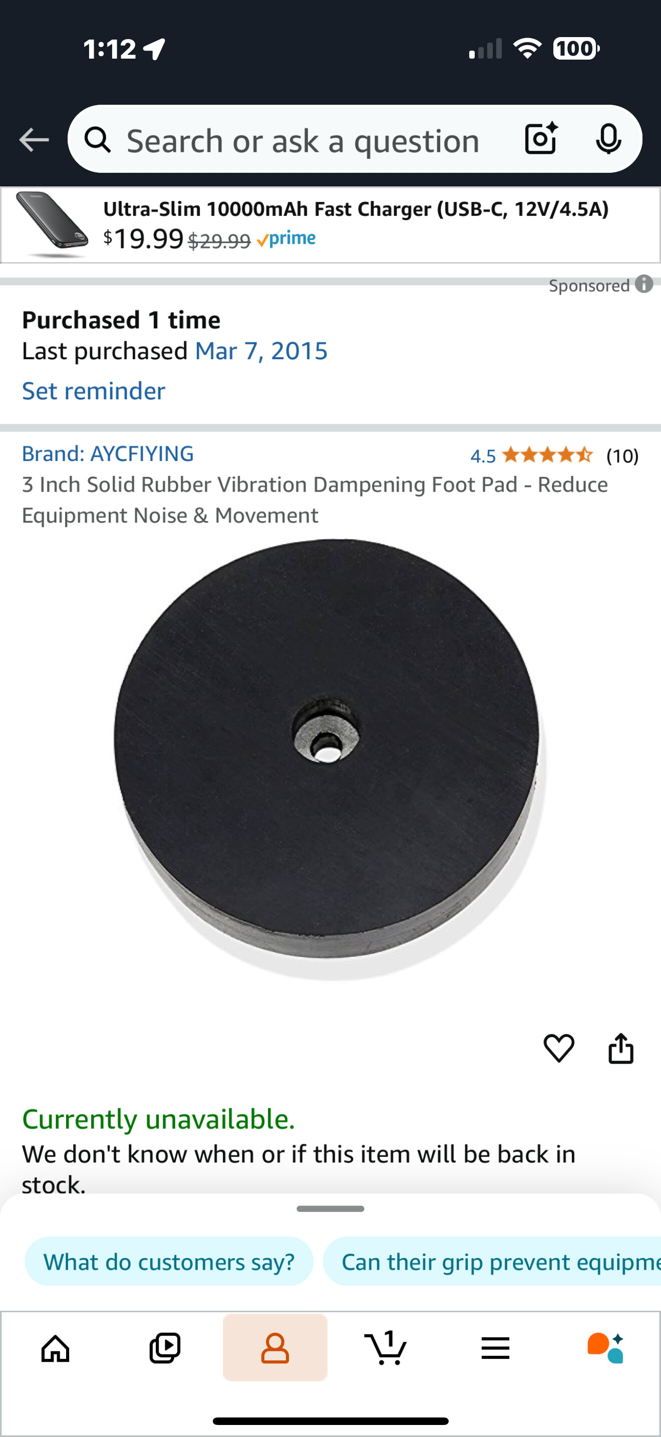

This might be of interest to you. The first & second pics are what I use on my DWC 4848 big machine (4’x4’, 2500lbs, ATC/Laser, 4th axis, etc).
The second pic is just an example, but very similar of what my machine supplier provided.
Check it every once a while for level, hasn’t moved a mm yet & no issues with the concrete or the Karen next store about noises from the studio keeping her cats awake.
I added the Vibration Pads to stop transmitting the vibrations into the fresh concrete & protection of said concrete.
The smaller Vibration Pads I used on all my Hobby/Pro Hobby machines, currently 5.
I also use either some all drawing board rubber top or the exercise form mats on top of tables for the Hobby machines.

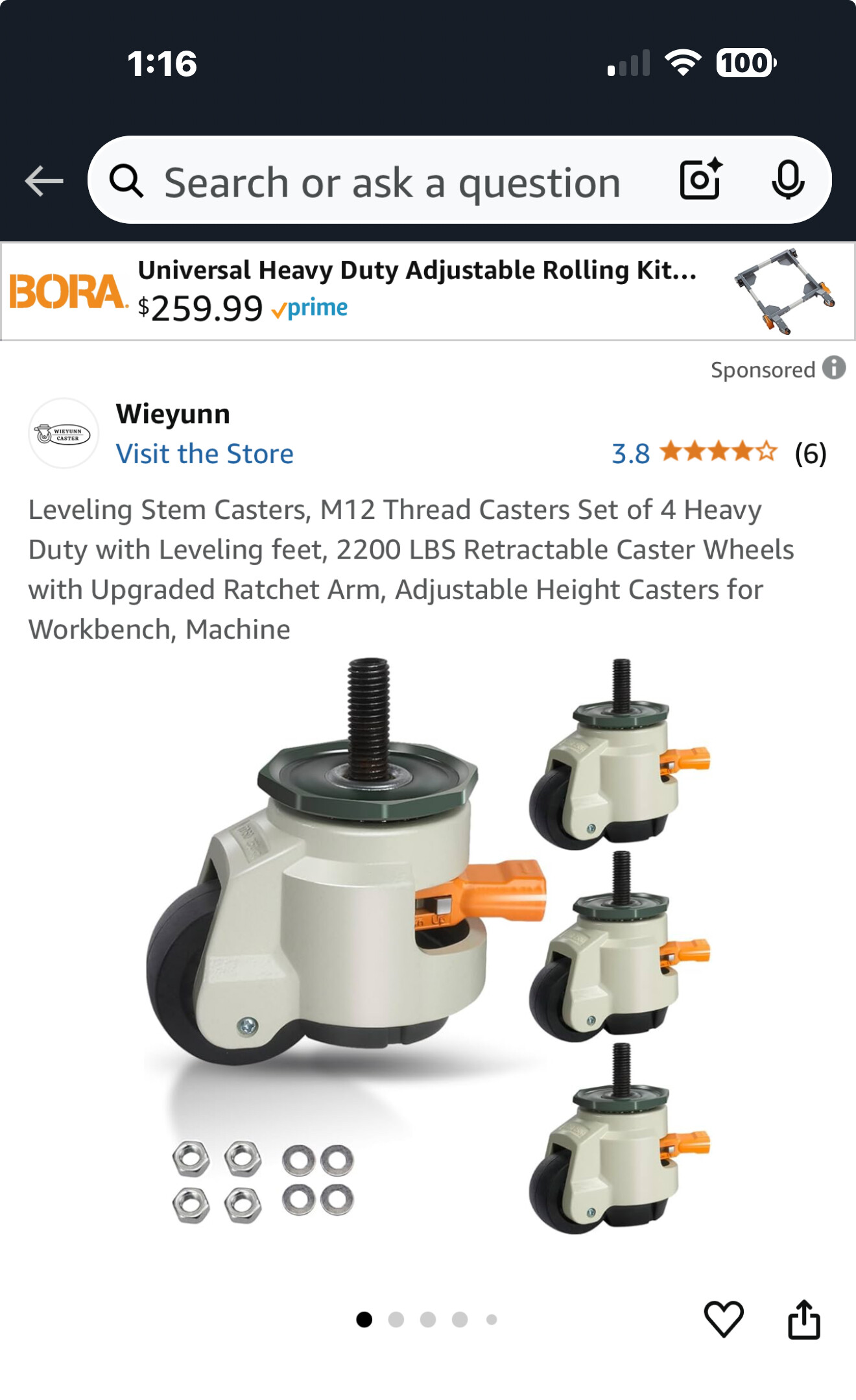

My Shapeoko bench has those castors with the adjustable wind down feet. It glides across the epoxy surface of floor very smoothly.
So yes, self levelling floor can be done very successfully, and for me was well worth the effort - just make sure you select the correct product.
I have been looking into those types of casters. They seem the most feasible to me. I also like the foam pads as well. I hadn’t thought about padding my machine to reduce noise and vibration. That is a definite item I will be looking into as well. Have to get past the purchases of the lumber bundles I am currently working on getting. Building up stock material so I don’t have to keep running to the hardware store for any material. I will have it at my fingertips.
