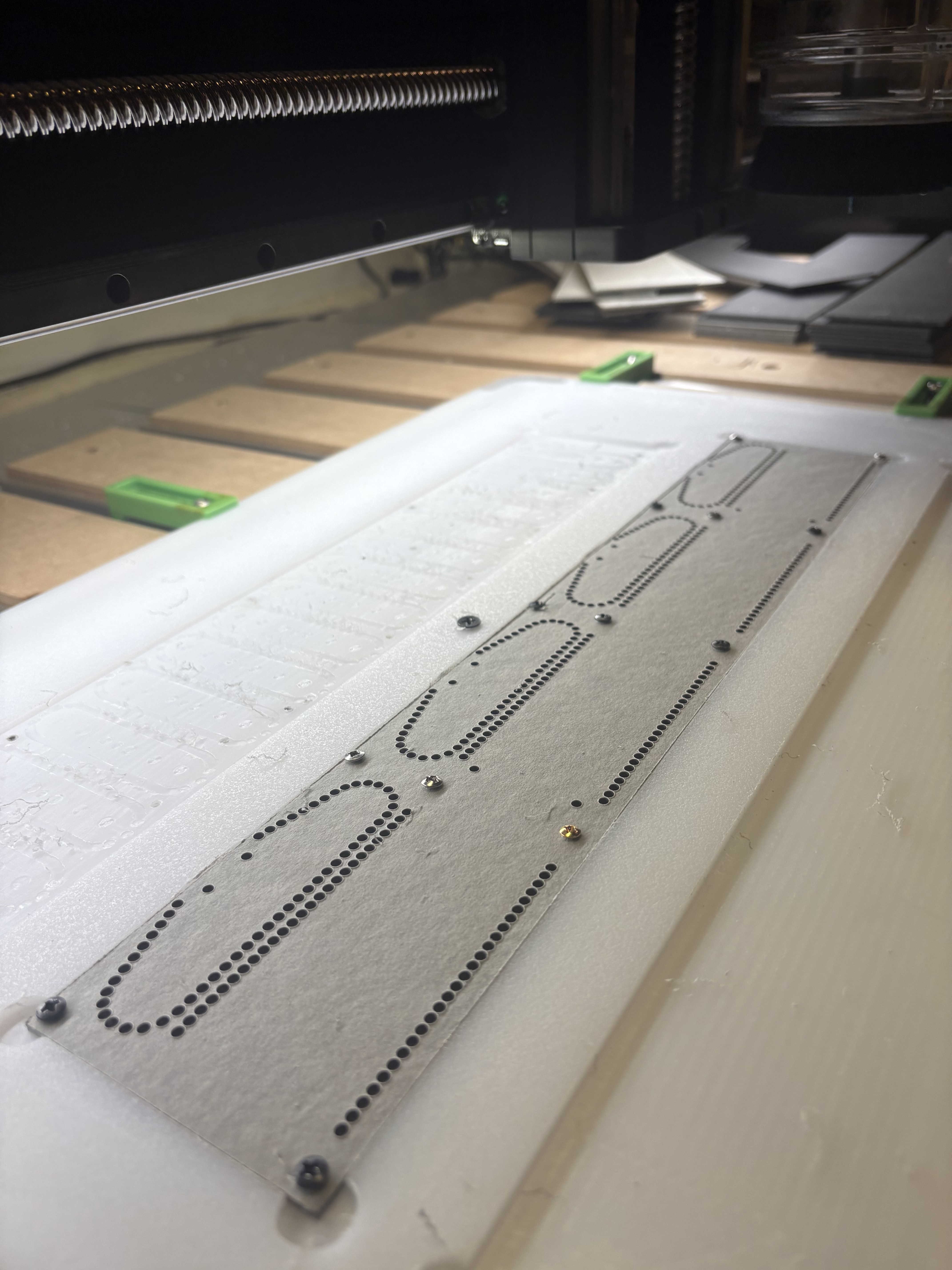

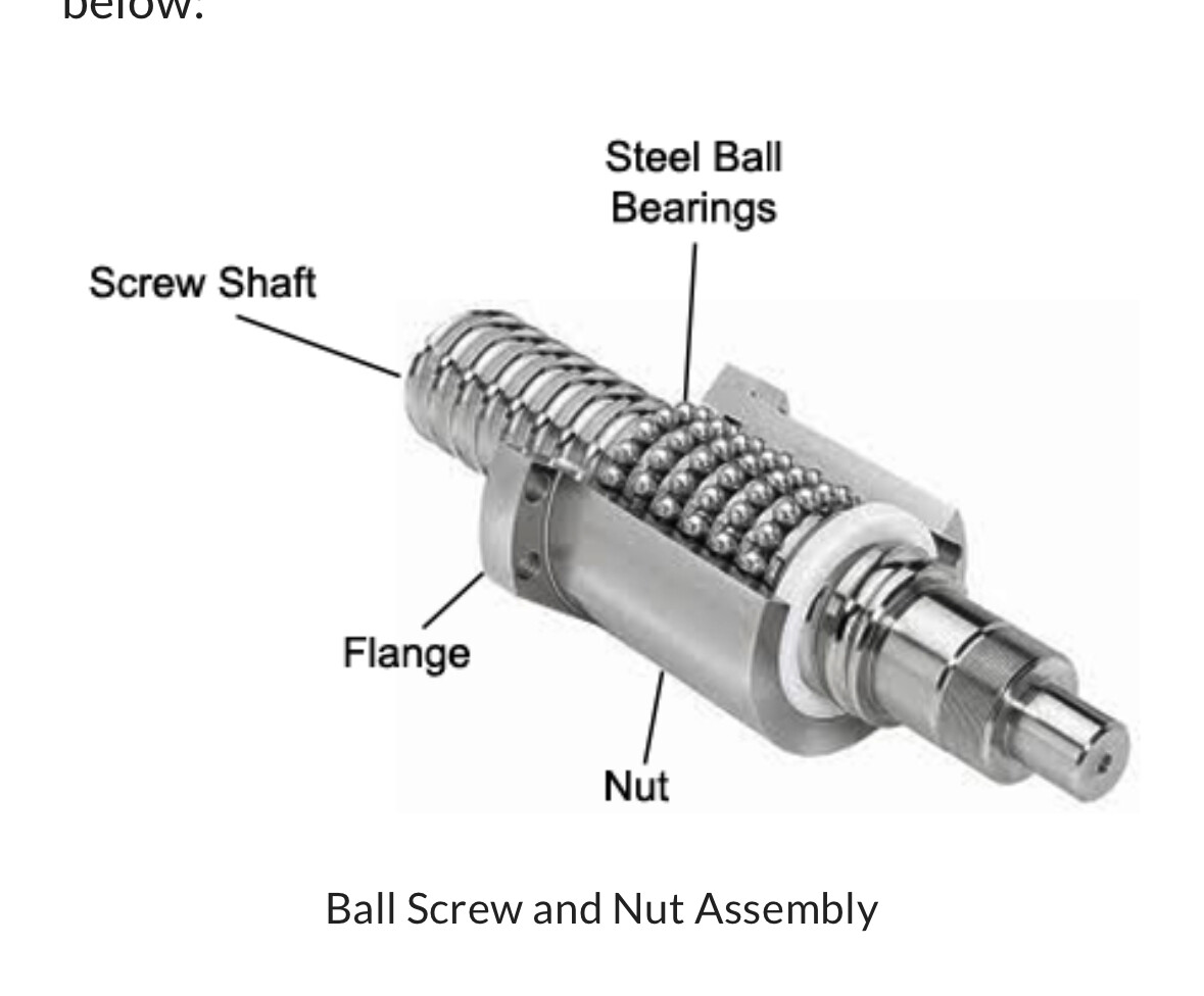

Shapeoko 5 pro. Referencing this diagram:

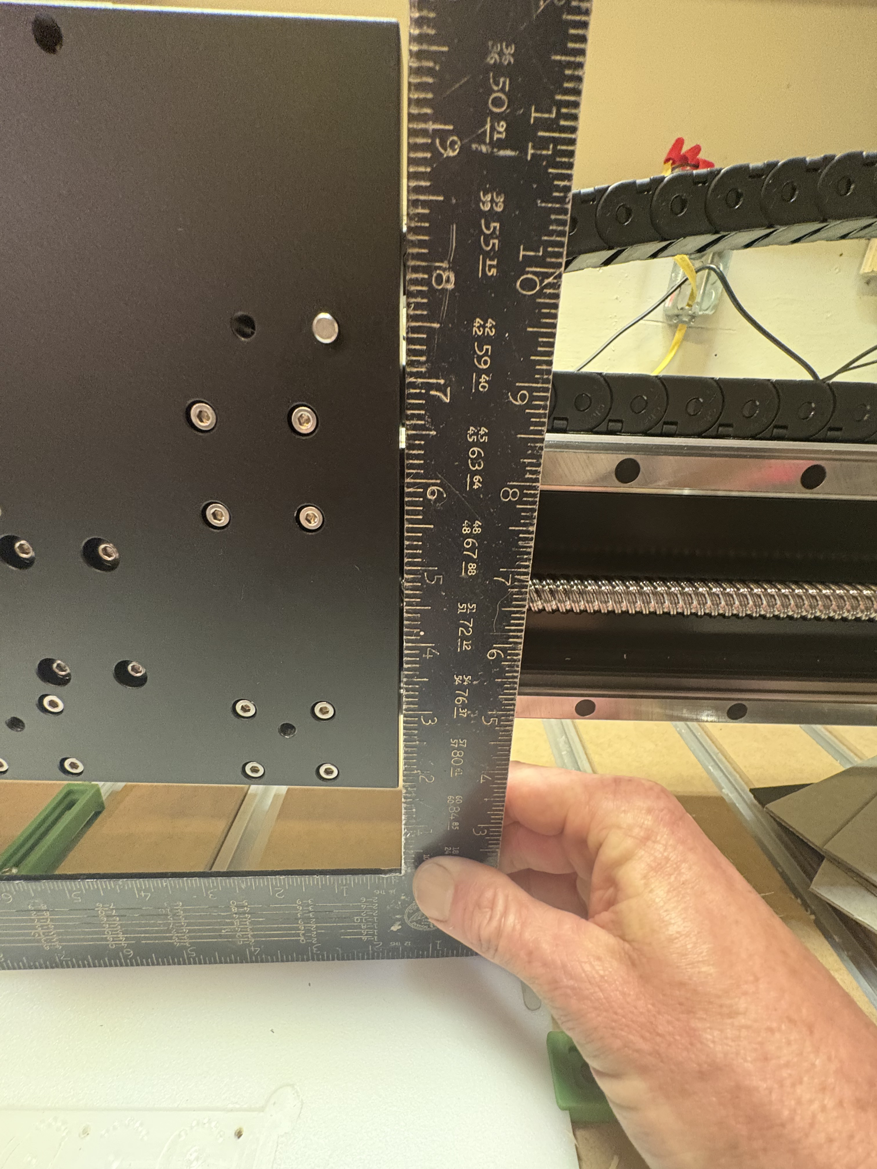

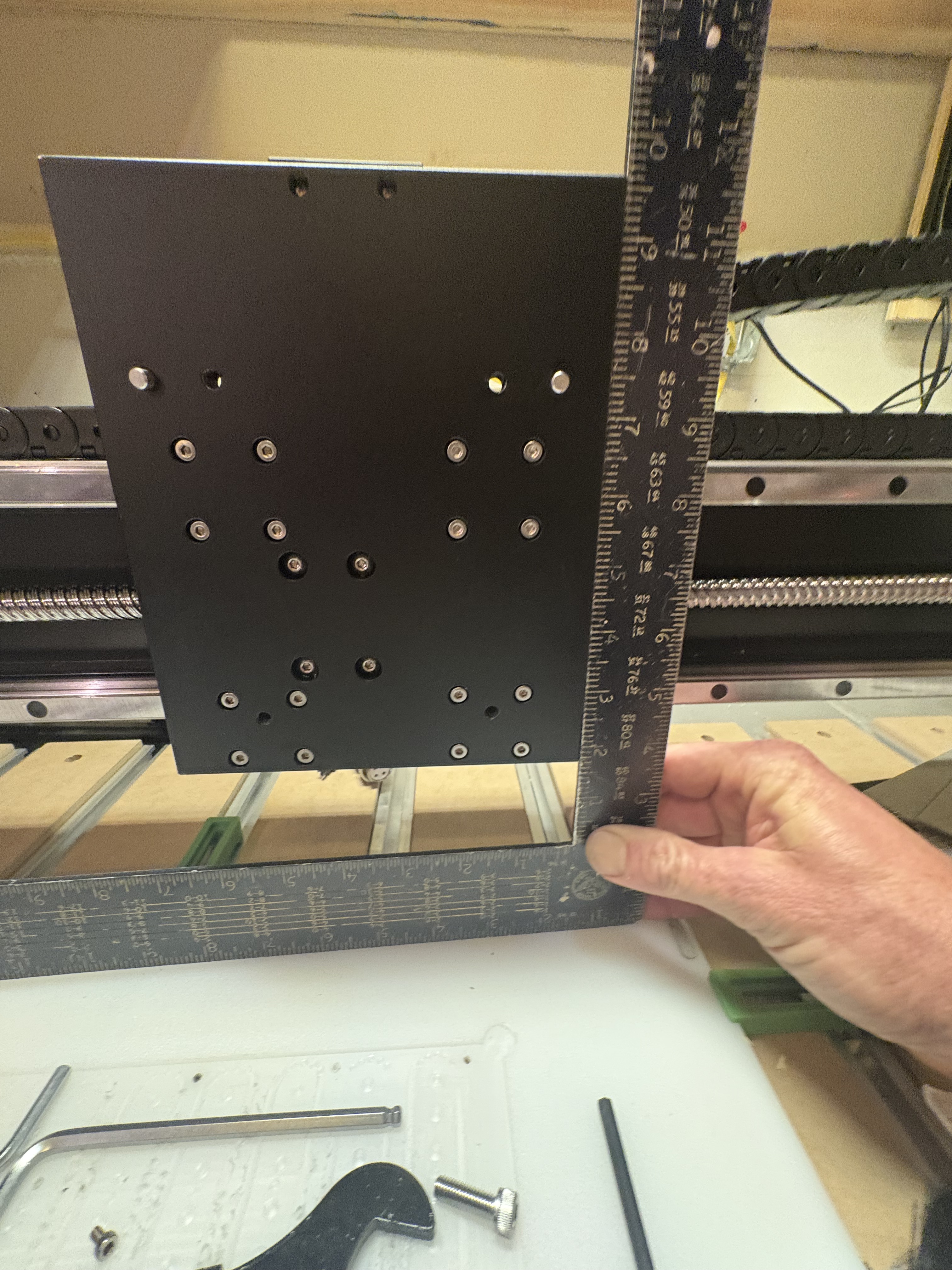

With the screw shaft not moving the nut/flange can click/clunk/move 1-2mm to either side, just eyeballing with carpenter square:
Is this normal? Seems not normal.
Not normal. Try tightening the four screws in the middle.
Definitely not normal. Also check the Y axis. Push forward/back on the whole gantry.
The carrier plate to ball screw screws are tight and loc tite applied, They were tight and there is no movement between plate and mounting points behind. It’s slop in the ball screw assembly. You can see the flange/nut moving back and forth with the screw holding still
The y is tight, and the accuracy issues are definitely x axis specific: horizontal spacing of holes is compromised, vertical alignment of holes is compromised. Is there adjustable pre-load in these? If so I’d say it’s gone. I’ve had no shock of any kind to the machine through assembly til now, wondering if g forces of shipping caused a failure or for preload to go out of tension etc.

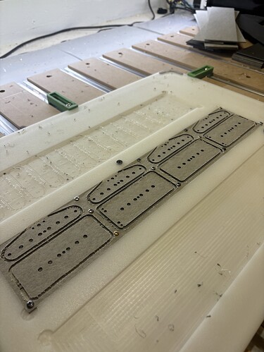

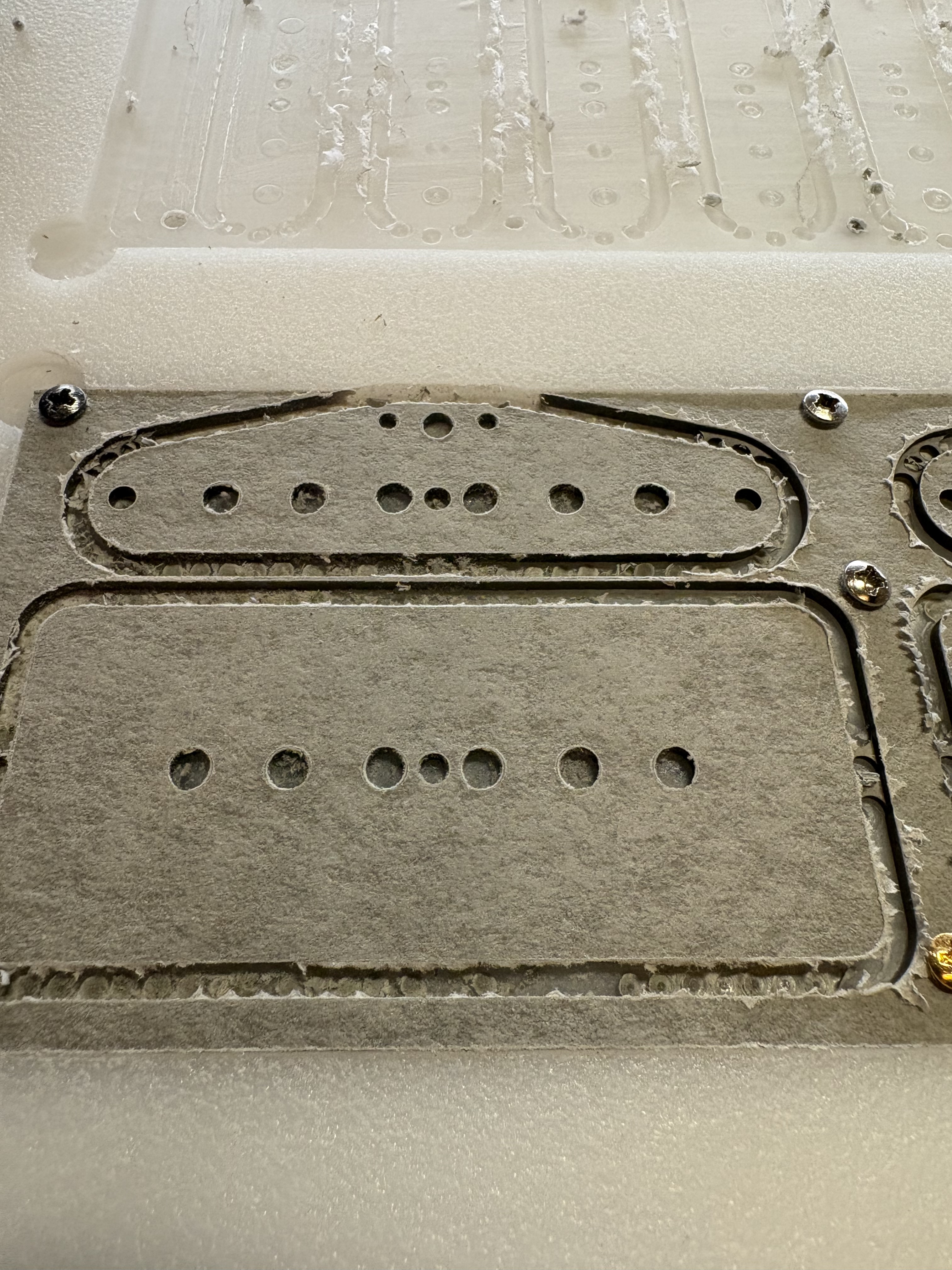

The ball flange mounting screws were completely loose, I have applied loctite red on reassembly but probably not much because it’s a reach to get back there. Gorilla hands. Slop gone. Back to zip zip zip, I’ll follow up.
Admin, if you read this please move post to machine category not software.
Loctite and retorquing of the ball screw flange round head screws (accessible on the behind the left side of the z carrier plate follow the screw shaft, one screw above, one below) is the other cure besides the four z plate to ball screw screws to coming loose.
Cutting pretty right now.
Now that looks much better!
