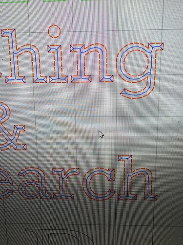

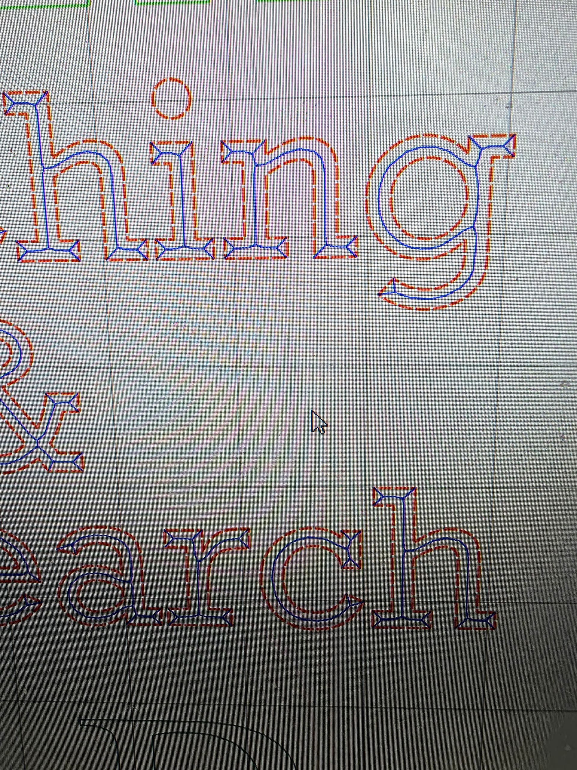

Okay y’all, maybe i’m looking at this wrong or misunderstanding. But from what I understand when you do a tool path in CC pro 838. The little blue line indicates where your pathing will go.

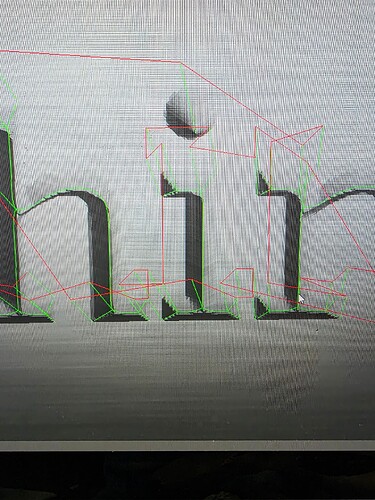

So I was very stumped to see it not represented in the dot of the i. But it does show it on simulation.
Is this a bug or am i just bugging?
Always appreciate your thoughts and experience!

It is just a dot, indicating a plunge.
I’m going to guess here…because you are doing a VCarve the dot is going to be completed like a drilling operation where the VBit will just go straight down in the circle and not move in any other direction. Therefore you won’t get a toolpath line as you do in the rest of the letters
I understand now, thank you!
I gave you the Solution click because you Will verified what your thinking, and that makes sense now.
