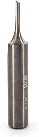

Maybe you should try some single edge bits. I have seen tests that they cut pretty good.
This picture will not fit the Shapeoko but there is a lot more meat behind this type of bit as opposed to a spiral 1/16" bit.
