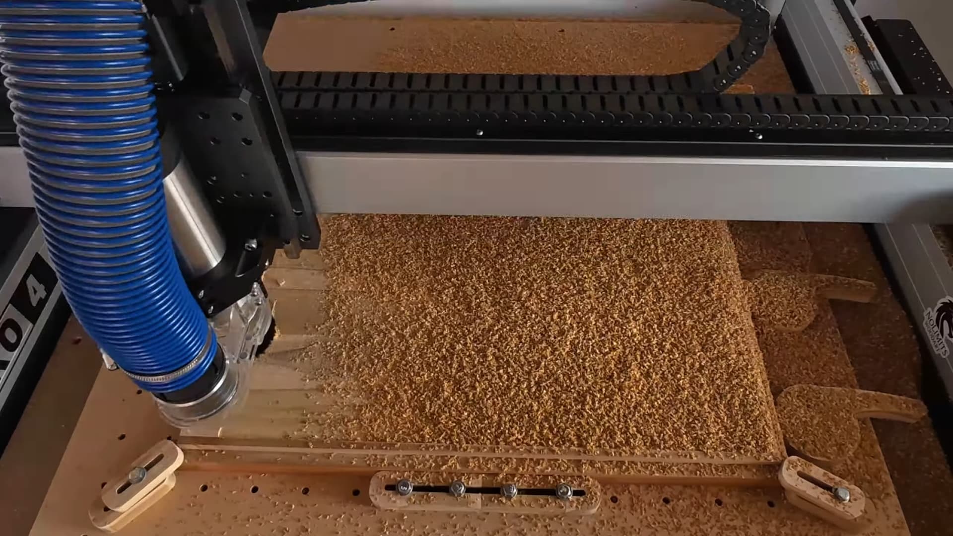

I’m the owner of a Shapeoko 4 XXL equipped with a Spindle and HDZ, and I’ve been struggling to find a proper dust boot solution for my setup.
Right now, I’m using the Sweepy 2.0 that came with my machine. It does its job and is definitely better than nothing, but the suction performance isn’t great, especially on the first passes or when doing finishing toolpaths with a tapered ball nose. The main issue is that it’s impossible to lower the Sweepy 2.0 enough because of the very limited surface area where it can attach (I also would prefer not lowering a lot more because it could crash/interfere with my piece). At the moment, it’s basically holding on by a single screw.

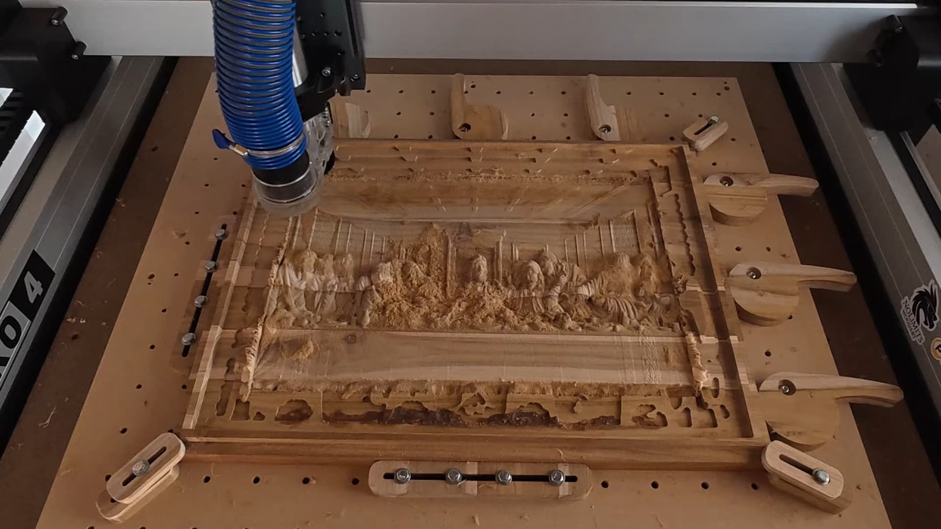

Here is a video where you can watch my current setup in action:
