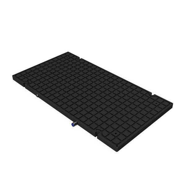

You’ll probably want vacuum workholding such as:
(double-sided tape gets expensive)

I didn’t even know you guys had a vacuum solution.

Thank you all, I decided to go with the 5.1 in 2x2. I also ordered the 2x2 vacuum mat as well with compressor. Wish me luck!

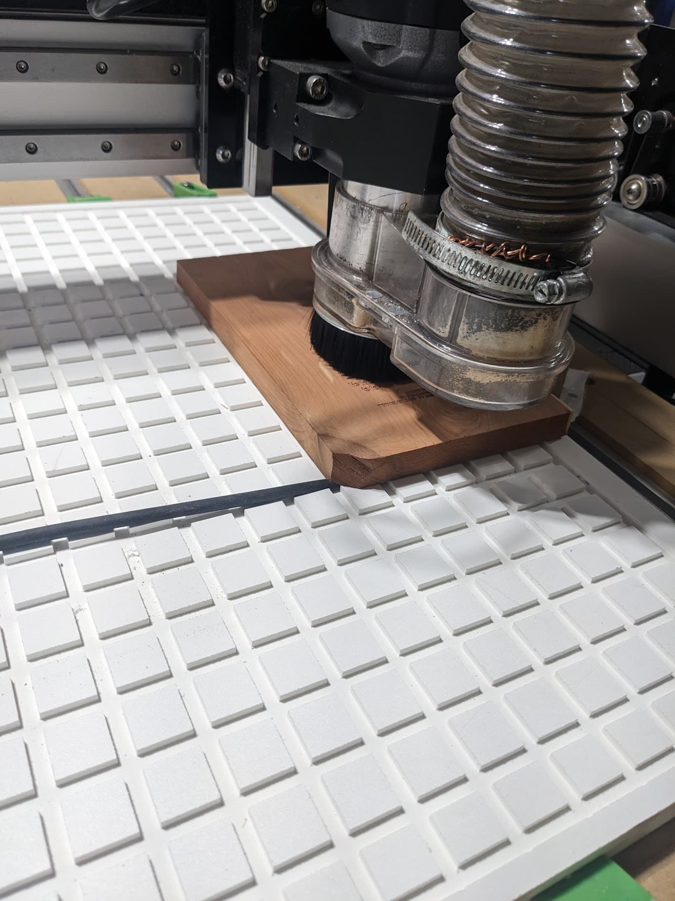

Should they also pick up some vacuum board or similar? Drag engraving on the vacuum table directly seems like it would be a bad time.
I’ve seen those vacuum boards Datron uses but that seems spendy, maybe a firm open cell foam with sealed edges would do the trick at a reasonable price point?
Yes, some sort of backing board/spacing material will be needed.

I suspect just a thin sheet of MDF (or low density fiberboard) would work well.
Or, source a thin cutting board and perforate it w/ a grid of tiny holes?

I cut a few tables out of PVC. They work fine. Thin MDF sealed works for cut through, but leaving a little skin is better.
Hey all, I’ve seen in a few videos where when using a drag knife on a vacuum board that a MDF board is needed to prevent damage to the vacuum board. Is there a specific kind of MDF board or recommended thickness you would all suggest?

The CNC would be able to cut the MDF to a specific shape if needed.
I think MDF and painting the edges would be fine? I’d maybe get half and quarter inch?

If the MDF is just a porous “spoilboard” on top of the vacuum table, aren’t really thin “laser” MDF sheets available? (I seem to remember them being mentioned in modeling videos but I’m at work and can’t access Google from here…)
You should be able to source a thin sheet of a suitable size of MDF from a big box store:
