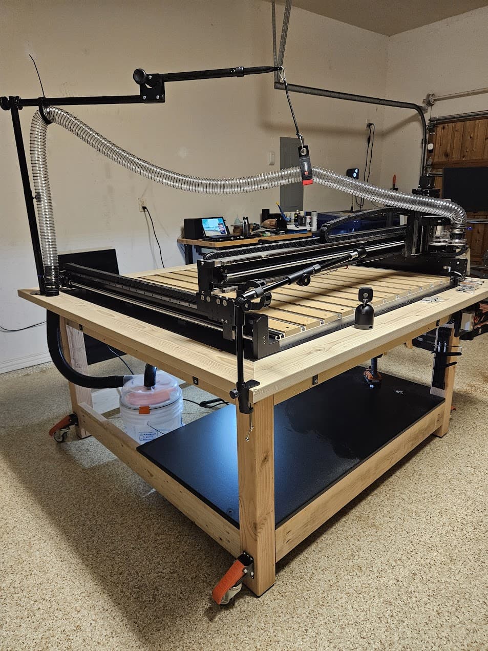

I recently bought my Shapeoko 5 Pro 4x4, and have been through this issue. I had never built a workbench before, but I’m extremely happy about the results.
Big box stores only carry, MDF/Plywood up to 4’x8’ - but you need a workbench at least 60 inches square. I went to Central Hardwoods (local in Dallas) to get 5’ x 5’ sheets of both for my build. MDF comes in 5’ x 10’ sheets, and they were happy to cut the sheet in half for $4. I rented a flatbed 10’ truck from Home Depot to transport everything.
I bought 4x4 and 2x6 lumber at Lowes (looked better than the Home Depot lumber), picking out straight quality boards. I also bought the Kreg pocket hole jig kit for assembly.
I placed the plywood on top and screwed that down to the outer frame and cross support. Then I added the MDF on top and used a router to edge the MDF to the plywood. The MDF is NOT screwed to the plywood. Next, shellac and flat black paint for sealing and protection.
Next, I added 2x6 framing to the outside edge - flush with the MDF surface. This will allow clamped accessories, dust collection, and maybe an enclosure base if needed later. By framing like this, I can easily replace or modify these boards without having to remove the completed CNC that will sit on the MDF surface.
Still working on the dust collection - looks like the 10’ hose won’t cut it.
Happy to answer any questions or provide additional images / links to any products used. Hope this helps!

Interesting about 5x10 sheets of MDF. What did you use for the shelf at the bottom front?

The hose seems fine to me, so long as it doesn’t drag onto the gantry and interfere with machine motion.

The shelf at the bottom front is the second piece of MDF, cut in half. There’s a crossmember at the mid-point (east/west), and then two more between the the front and the half-way point (north/south) to prevent flex in the 3/4" MDF. It’s very solid. Original thought was to have it be a full shelf, but there’s not enough space on the diagonal to slide it in, plus the deeper rear section is better for the dust bucket / shop vac.
What you’re suggesting is part of the design reasoning. As the surround is just on with brackets they can be removed without disturbing the CNC if I want to do big 4x8 or indexed cuts.
