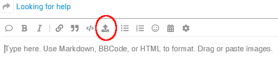

Use the upload button here:
navigate towhere you stored your .nc file, and select it.
