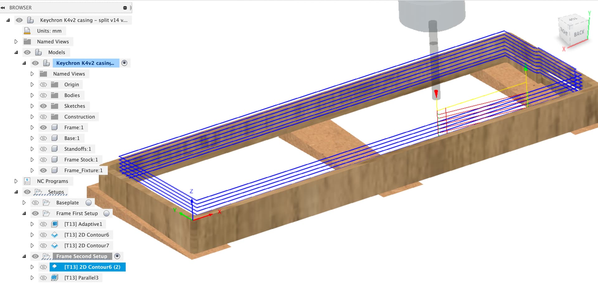

For the first CAM setup I have the frame ‘flat’ and the zero set at the spoilboard.
There’s then an adaptive clear on the upper part followed by 2D contours inside and out. I’m not sure what to do for workholding here, I’d try blue tape and superglue.
This set of jobs leaves 2mm uncut at the bottom of the inner slot, I figure cutting this out by hand and then sanding might be easiest, you could try all the way to the bottom with tabs or other approaches.
The second setup uses the wedges to hold the frame at the wedge angle, zero has moved and needs to be set off the cut outer edges from the first setup.
Getting the X aligned correctly will be really important as any misalignment will really show up. I suggest putting a dial indicator in the spindle and jogging left / right along the front machined edge to get it properly straight with the Shapeoko X axis.
There’s two toolpaths, a contour to cut the inner angles, for this one, I might do a first pass with, say 1 or 2 mm stock to leave, then measure how accurately it is centered in the outer cut.
Then theres a parallel finishing toolpath for the top face
Which brings us to the problem, workholding, there’s nowhere left to hold the work down. You could split the top finishing into two toolpaths which might let top-clamping work.
For the holes in the bottom I might just mark through with the baseplate and manually drill.

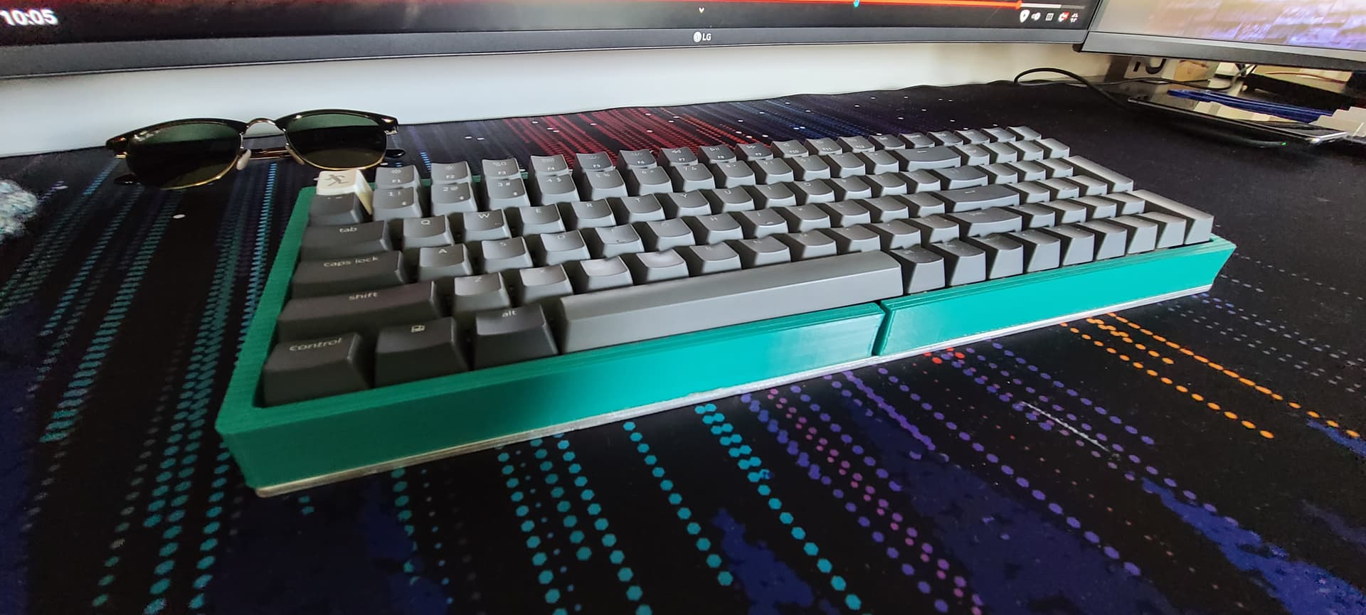

I printed the new changes and it fits pretty well. I may add half a mm spacing on either side just to give some wiggle room for the PCB to sit. Thanks again for all your help, just need to make that tweak and then i can start milling!
