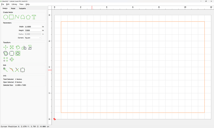

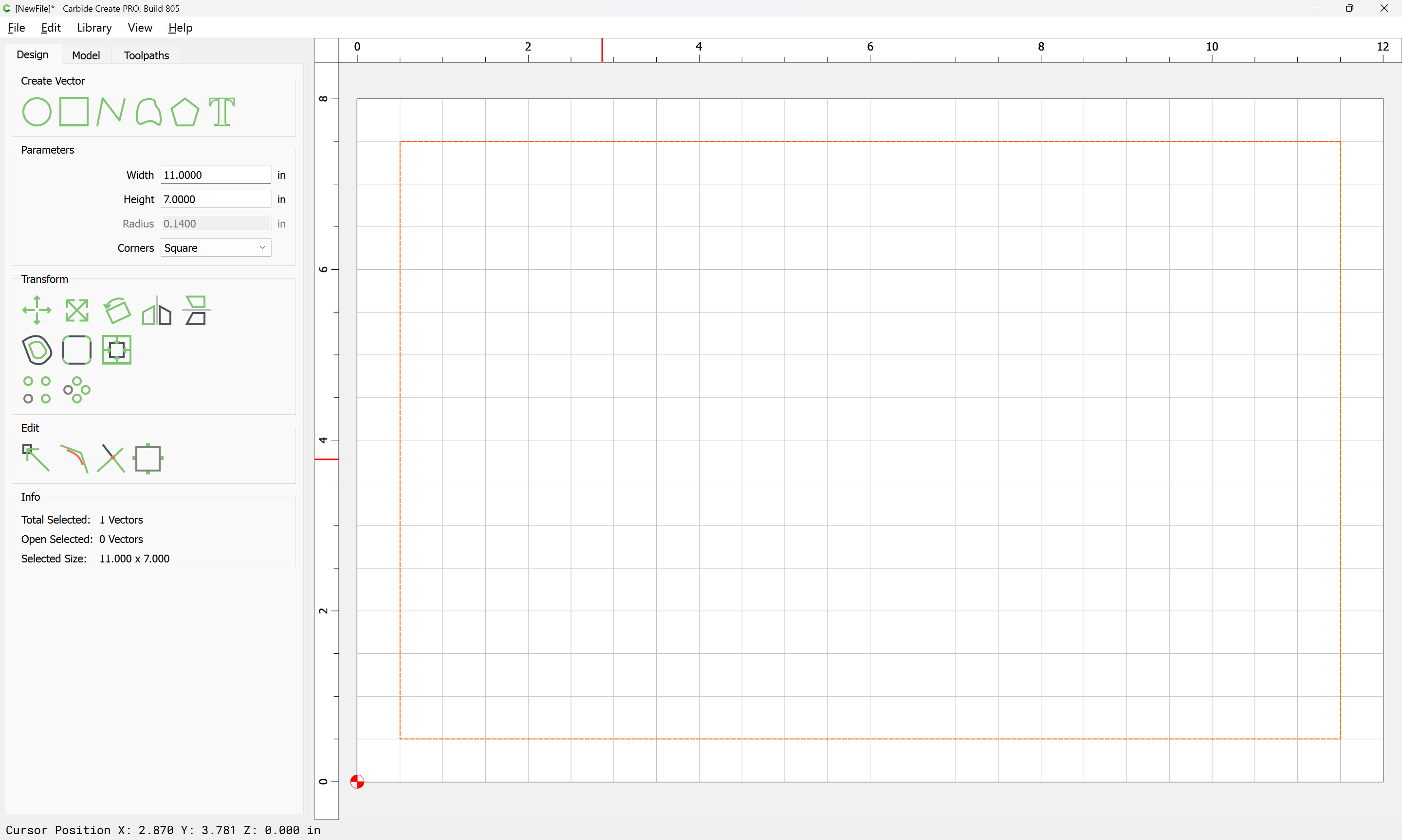

Are you using Carbide Create Pro?

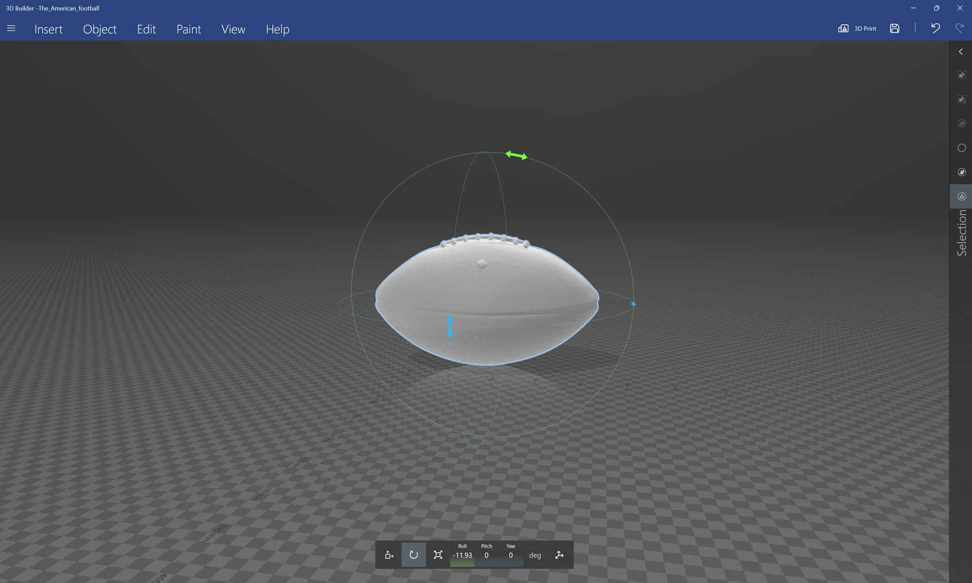

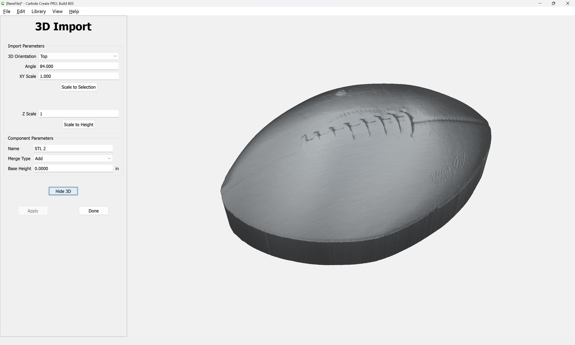

There is a downloadable 3D model at:

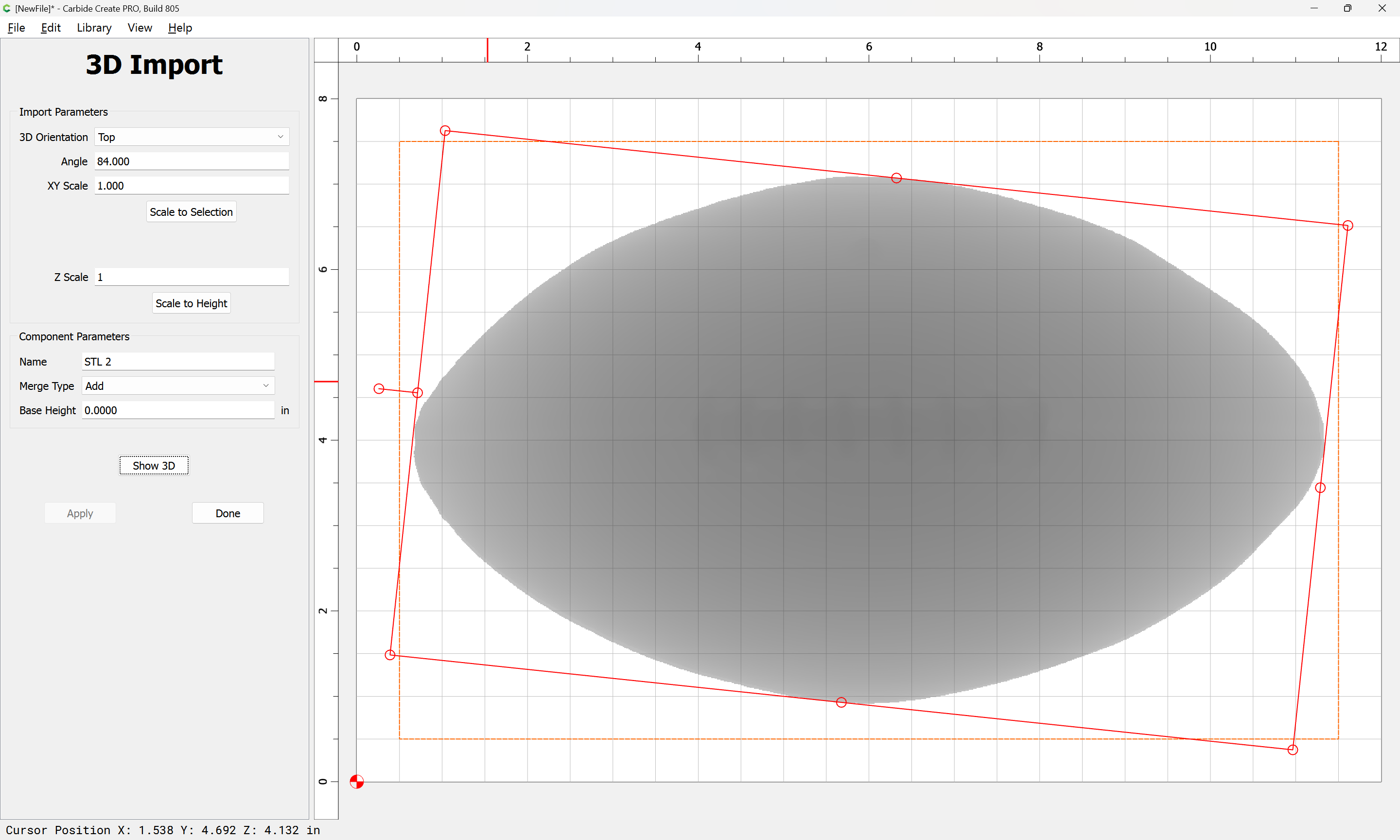

You could download it and then it would want to be rotated:

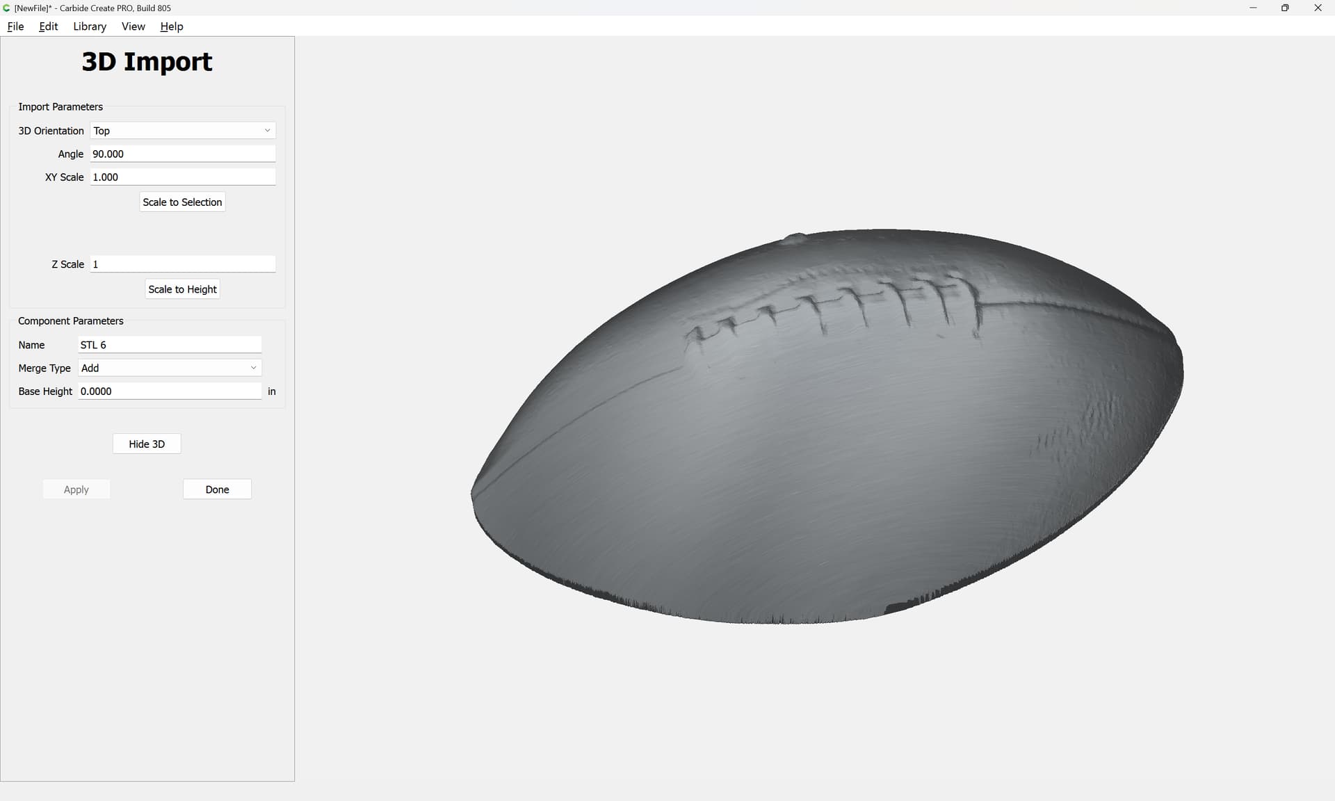

Then the STL could be saved and be imported into a 3D CAM tool such as Carbide Create Pro:

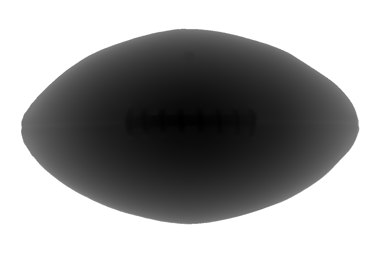

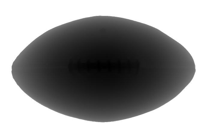

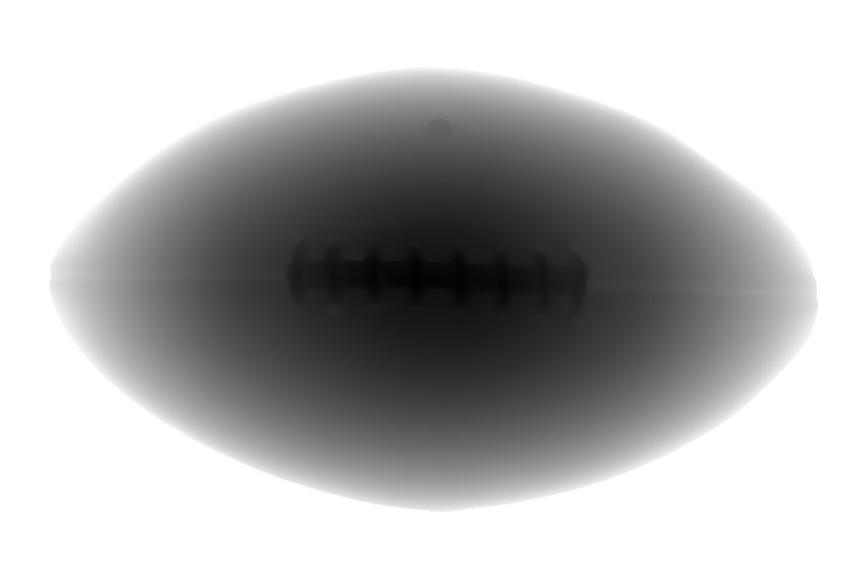

You could then export the 3D model as a pixel image:
which can then be edited in a pixel image editor so that it will import as desired.

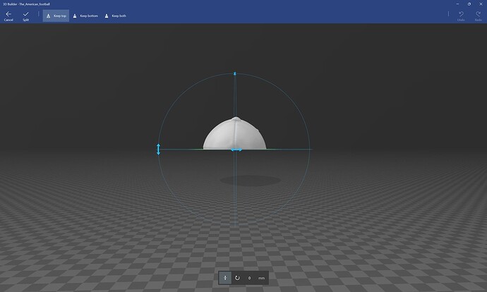

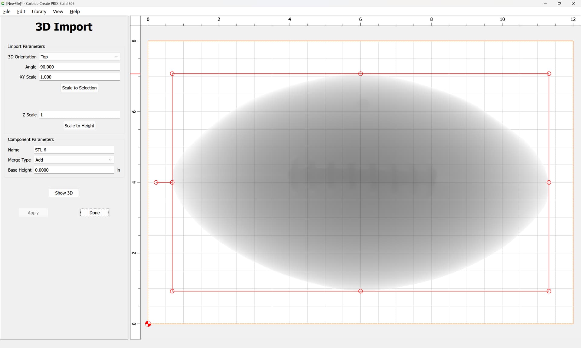

Or, one can go back to the 3D model and slice it:
which will then import as expected:
which can then have 3D toolpaths assigned.
Here is the pixel image:
which should import and allow creating 3D toolpaths.

yes i am attempting in carbide create pro!
