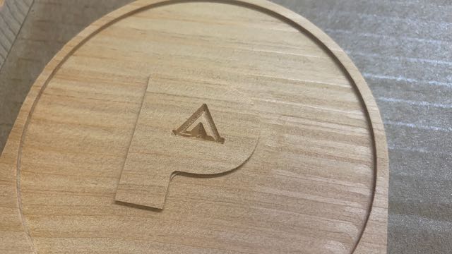

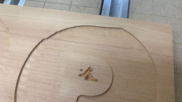

Machine has been thoroughly lubricated, but make a horrible sound when moving diagonally.
Could this be related to why it’s losing position? Should have looked like first pic, but made a lot of noise and cut really badly.
Really don’t like wasting time and materials.

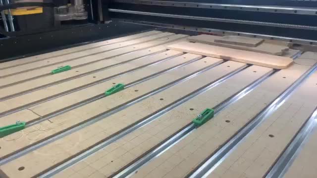

Nothing weird except the gantry felt like it shifted when changing bits, which has never happened before. Plus it started to make loud grinding sounds (which I didn’t hear at first since I wear hearing protection).

That could be a clue as to what’s wrong, the gantry should not shift. Check for loose hardware on everything that supports X and Y travel.
