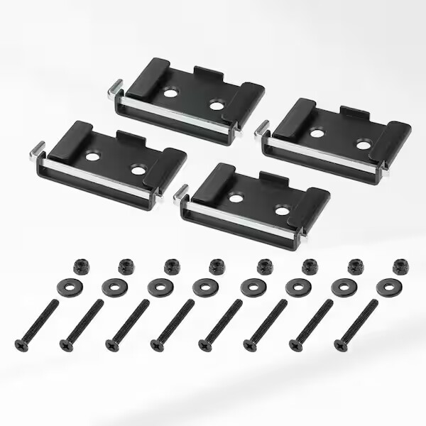

I have used these in the past. You can get brackets to remove the wheels and use the wheels on other equipment with the brackets. If you dont have the removable brackets they are a toe smasher.
Brackets
Yes. I have those now. They are the ones I described as too abrupt. It just seems a little violent letting the machine down on them. I would like a smoother action.

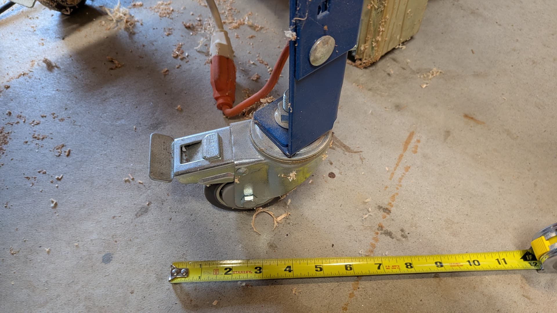

Even cooler if these could be mounted to the inside of the legs so that they don’t protrude. What is the depth of that bracket?
I have the Kreg 44 x 64 stand with those casters under my 5 Pro 4x2.
I find that sudden gantry stops and acceleration cause the casters to wobble. Shaking the stand uprights by hand, I can visually see the wobble.
Wondering if this is throwing accuracy off.

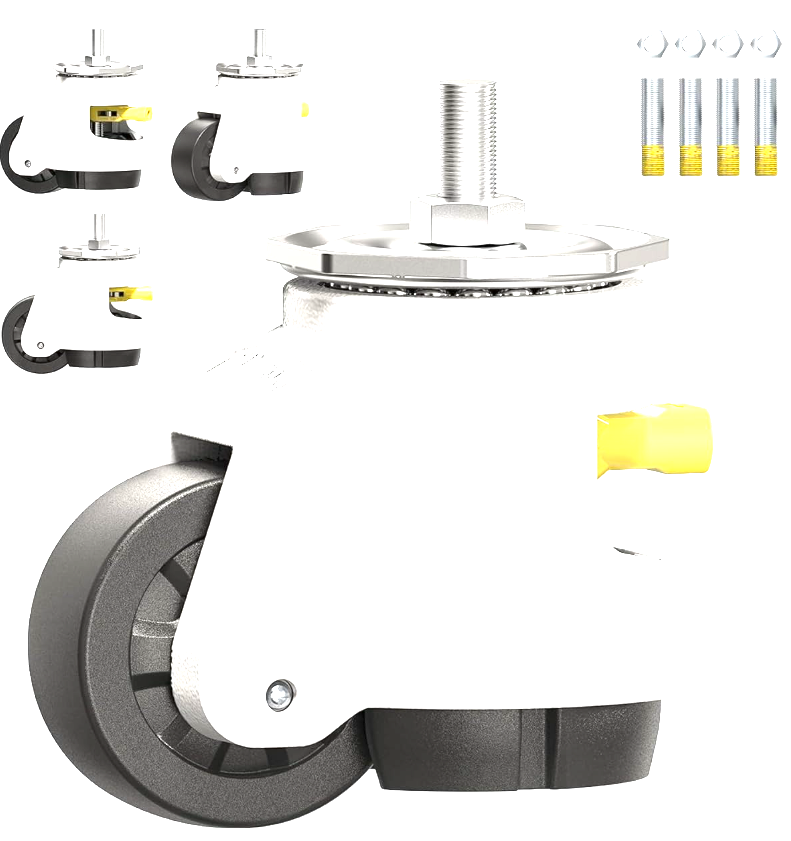

These are great leveling casters.
Yes, but as stated in my original post they add several inches to the height. The advantage is that they wouldn’t require any additional drilling on the legs though.
Not sure if anything exists that’s stable and does not add height. There would be no drilling with the rollers I linked as they would fit in the holes that already exist for the table feet that came with the legs.

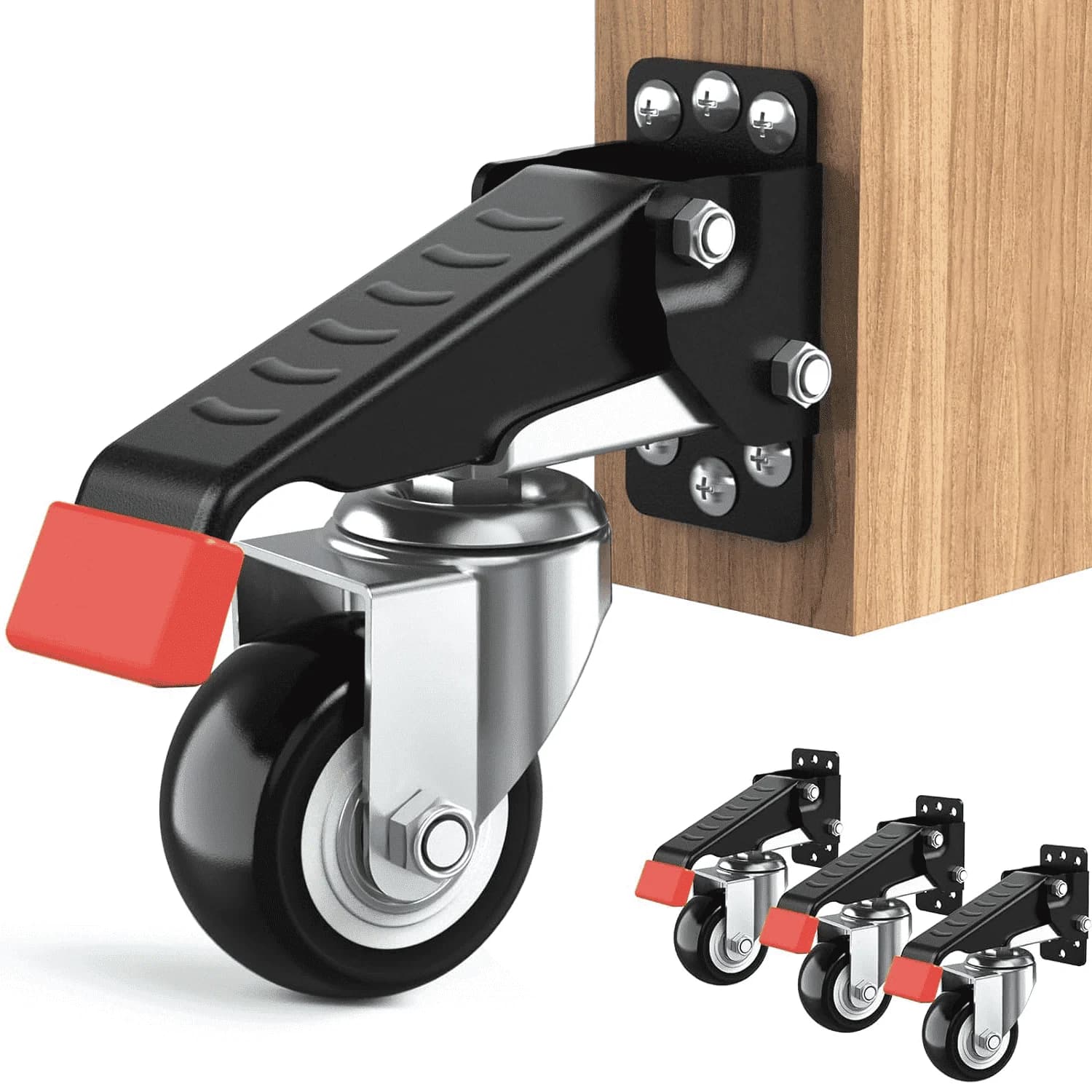

About the same price as those lever casters mentioned above - I have those on all of my assembly tables - and they are always tripping me.

I use those and just hold up the corner a bit to keep it from dropping too hard.

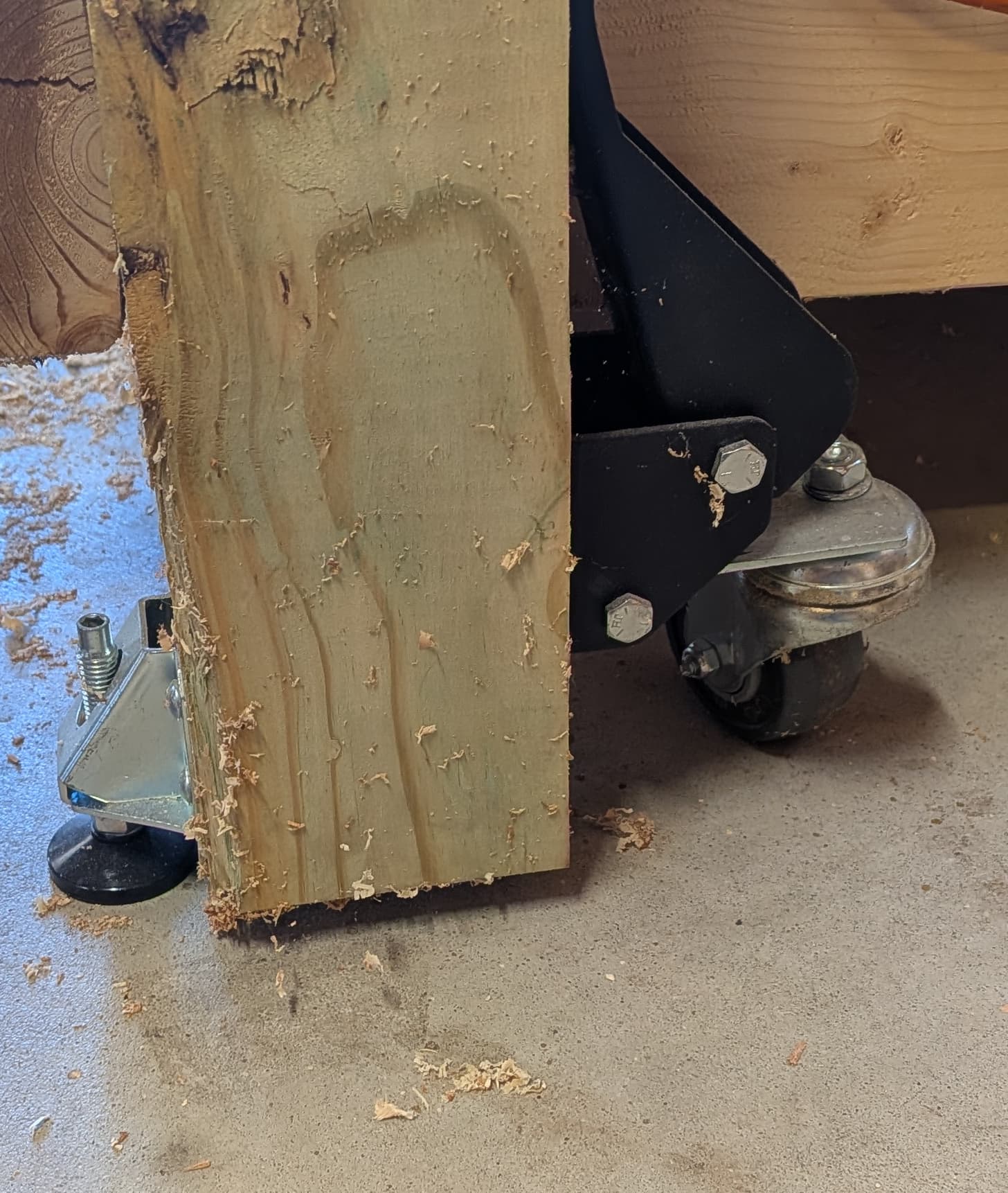

I use leveling feet to steady the table and 1"x 1/8 metal straps for diagonals to take the twist out of the movement.
I tucked the wheels inside and the levelers off the front and back’

Agree, these work great when I need to move my 60x65” table. Very stable with the machine running at higher feeds/speeds. Folks that have tables moving excessively need to use appropriate corner/cross bracing to prevent this.
Another advantage is the ability to level the table when moved.
