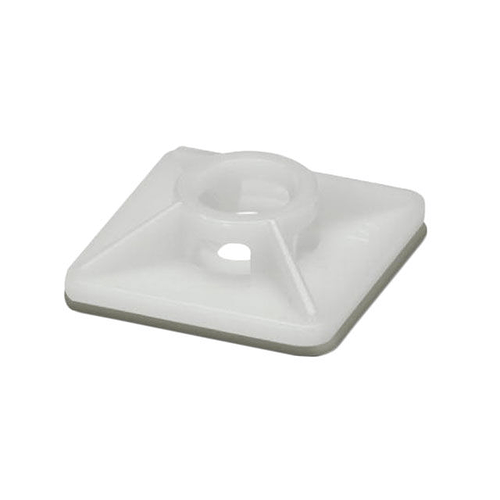

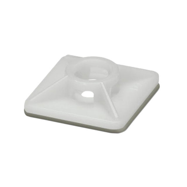

Most disconnects are static related. Once you eliminate static then check your usb connections. Sometimes the female connectors on the controller and/or the computer get sloppy after a lot of insertions. On the Shapeoko side get a wire tie stick on and tie the connector up so there is no strain on it.
