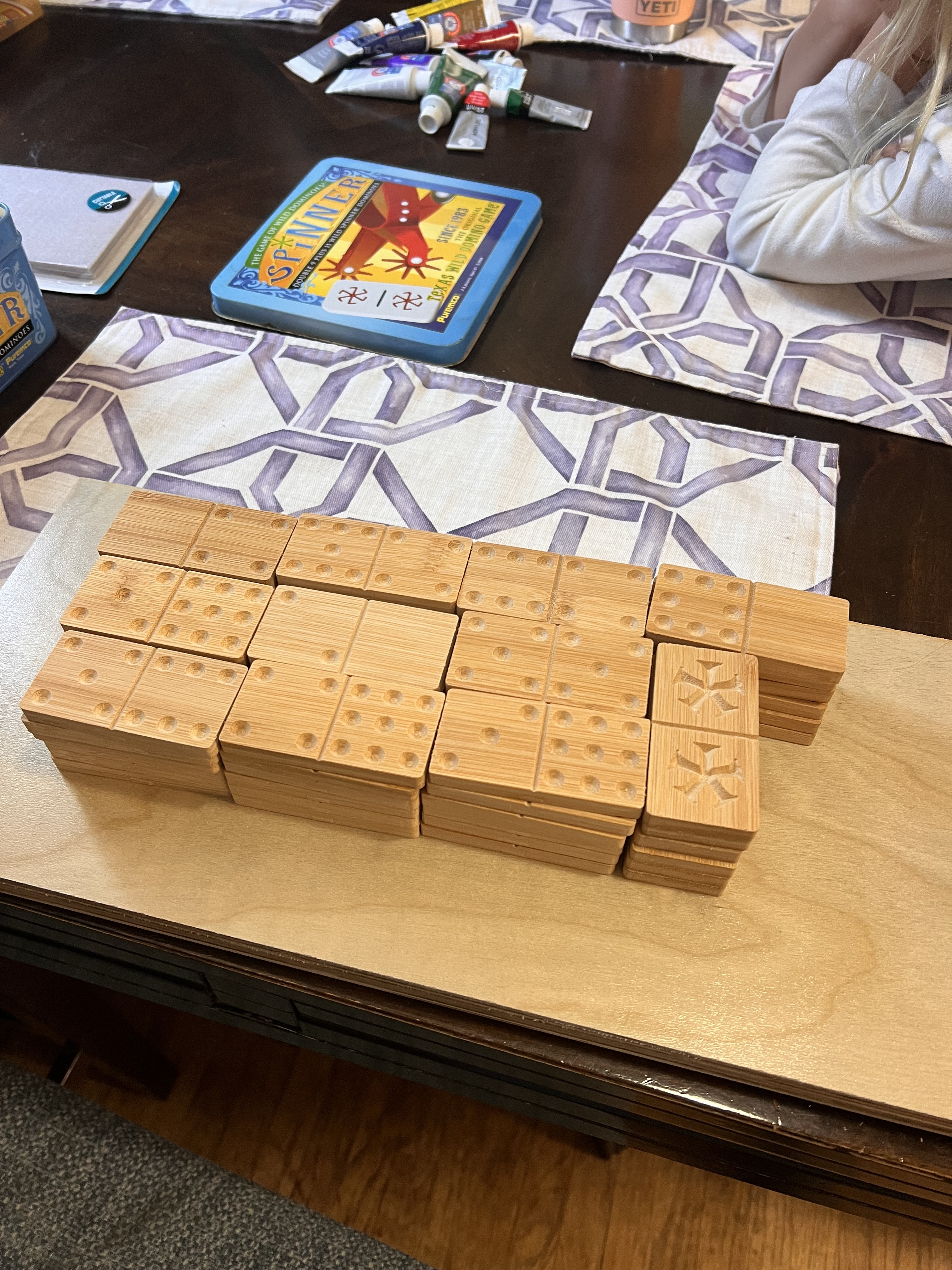

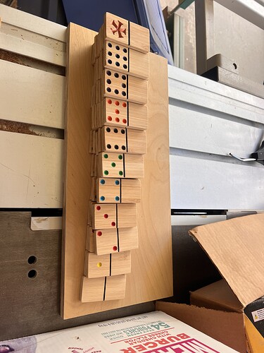

Made dominoes out of small bamboo cutting boards
1.25 cutting boards from the dollar tree made a set of dominos 1.5 x 3 double 9 with spinners

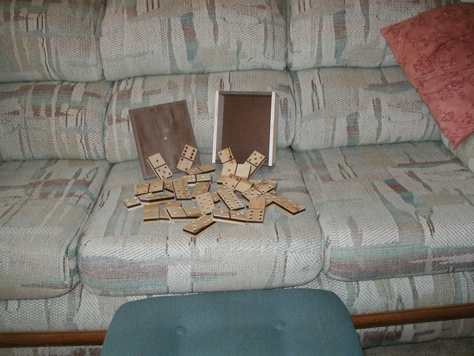

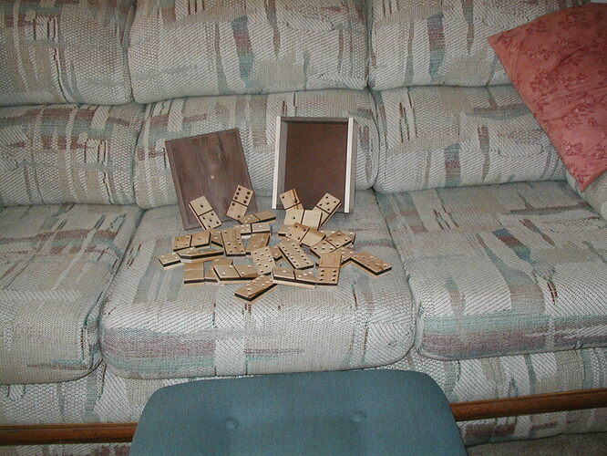

I made a set of those dimensions 15 years ago with traditional tools (tablesaw & drill press) for a retirement community. Now I am reaching the age where the extra size is understood and appreciated :slight_smile: They were made from two layers of maple and one of walnut.
And, yes, it does take up a bit of real estate.

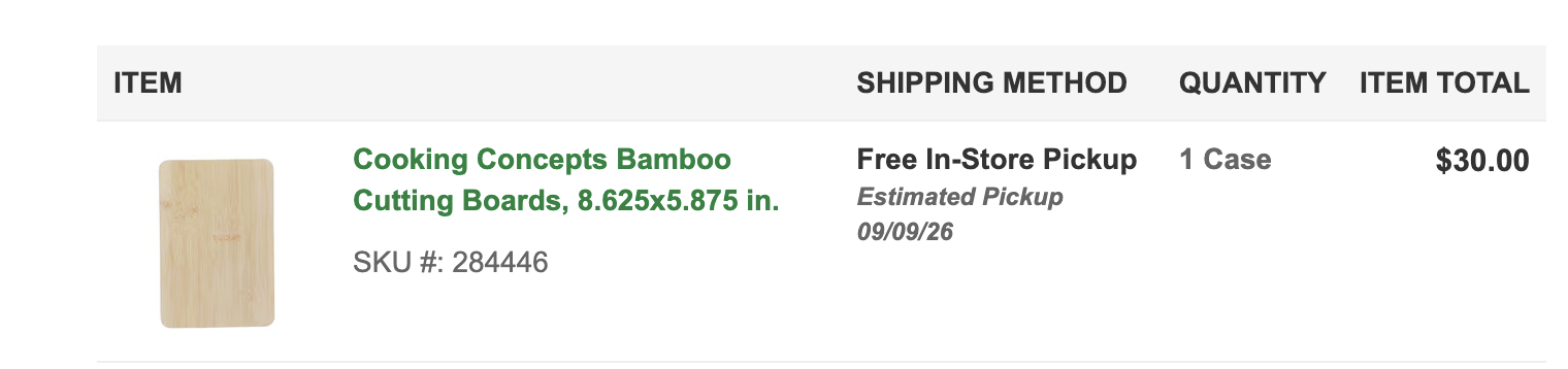

If anyone is interested, those bamboo cutting boards are still pretty cheap at Dollar Tree. $1.25 each, case of 24, $30.00

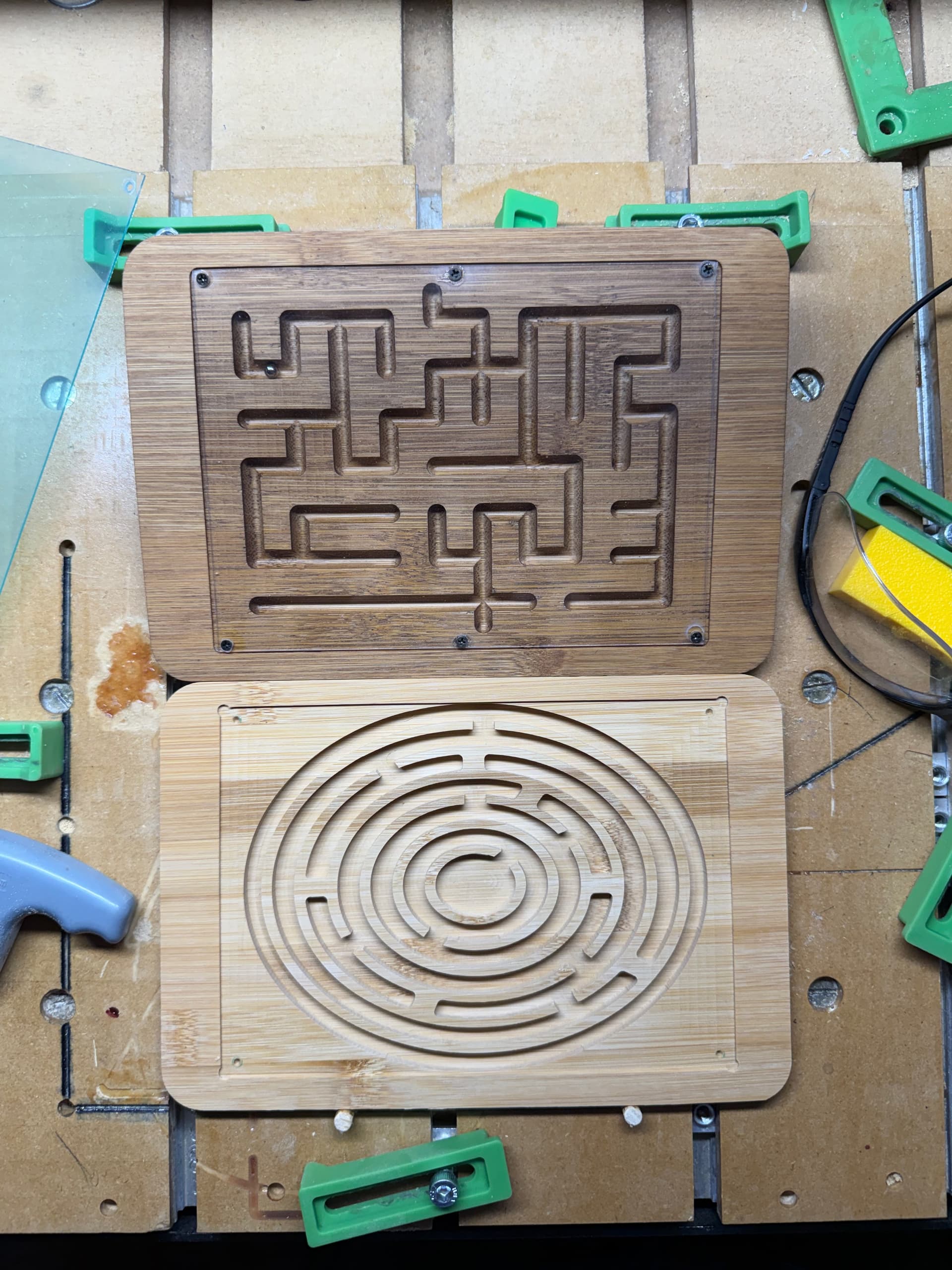

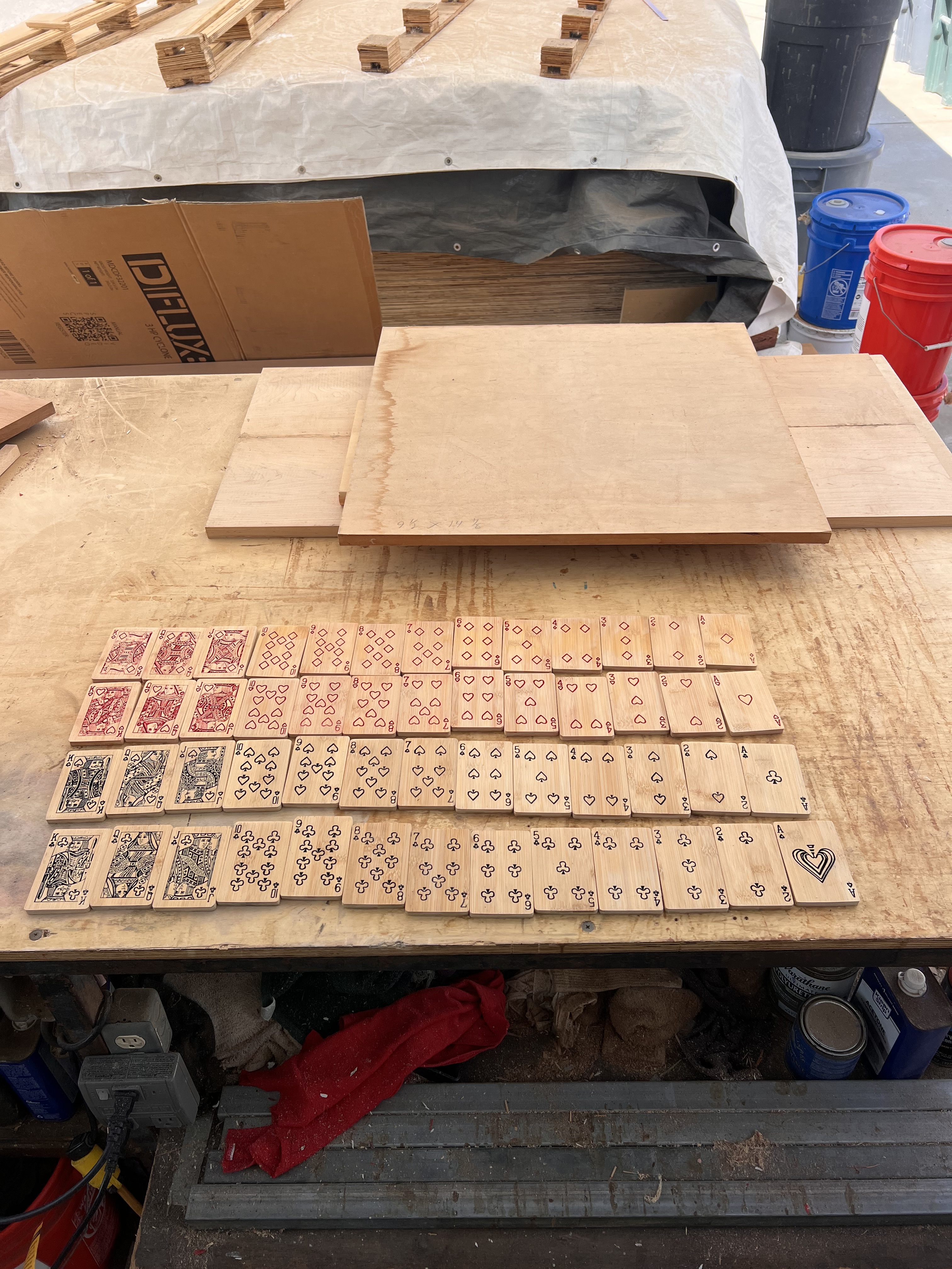

Thanks, @Ed.E and @Phillip.Harrell . Are they solidly-laminated or filled with random offcuts? I.e. could they be pocketed deeply, or just surface detail?
Mostly (in my experience) they are solid. Every so often there will be a void at the center where the two halves don’t quite match up.

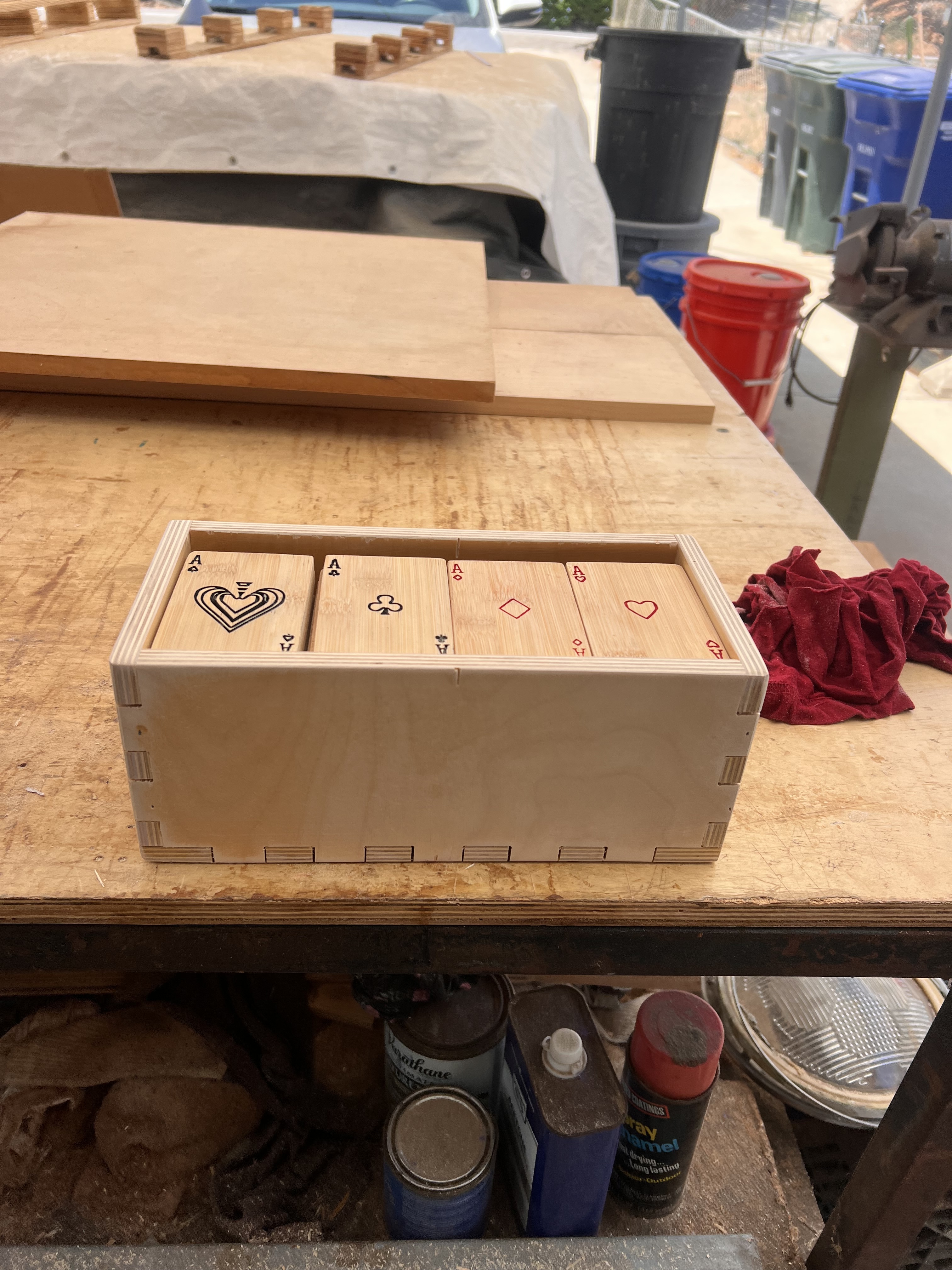

I have cut about 50 of these boards and all the ones I have cut down to .25 never had any voids even made a complete deck of cards for the grand kids
Processing: IMG_9028.jpeg…Processing: IMG_9032.jpeg…
Thank you, @WillAdams and @Phillip.Harrell.
I’m currently pocketing a bunch down to .240", no voids yet.
Wow, you’re most of the way through the board! :slight_smile: I went in to work yesterday morning to check on the progress of a 27-hour 3D print I started Friday afternoon, and stopped at three Dollar Trees on the way. Two had nada, and the third only had large bamboo cutting boards for $5. I bought one just because, but noticed it was only 5/16" thick, significantly thinner than the C3D project board/Nomad case side offcut which is 1/2" thick. When I got home I checked the Dollar Tree website and found yes, the small board is also only 5/16" thick.

The ones I’ve been getting are averaging .315" thick. It’s close but doable.
