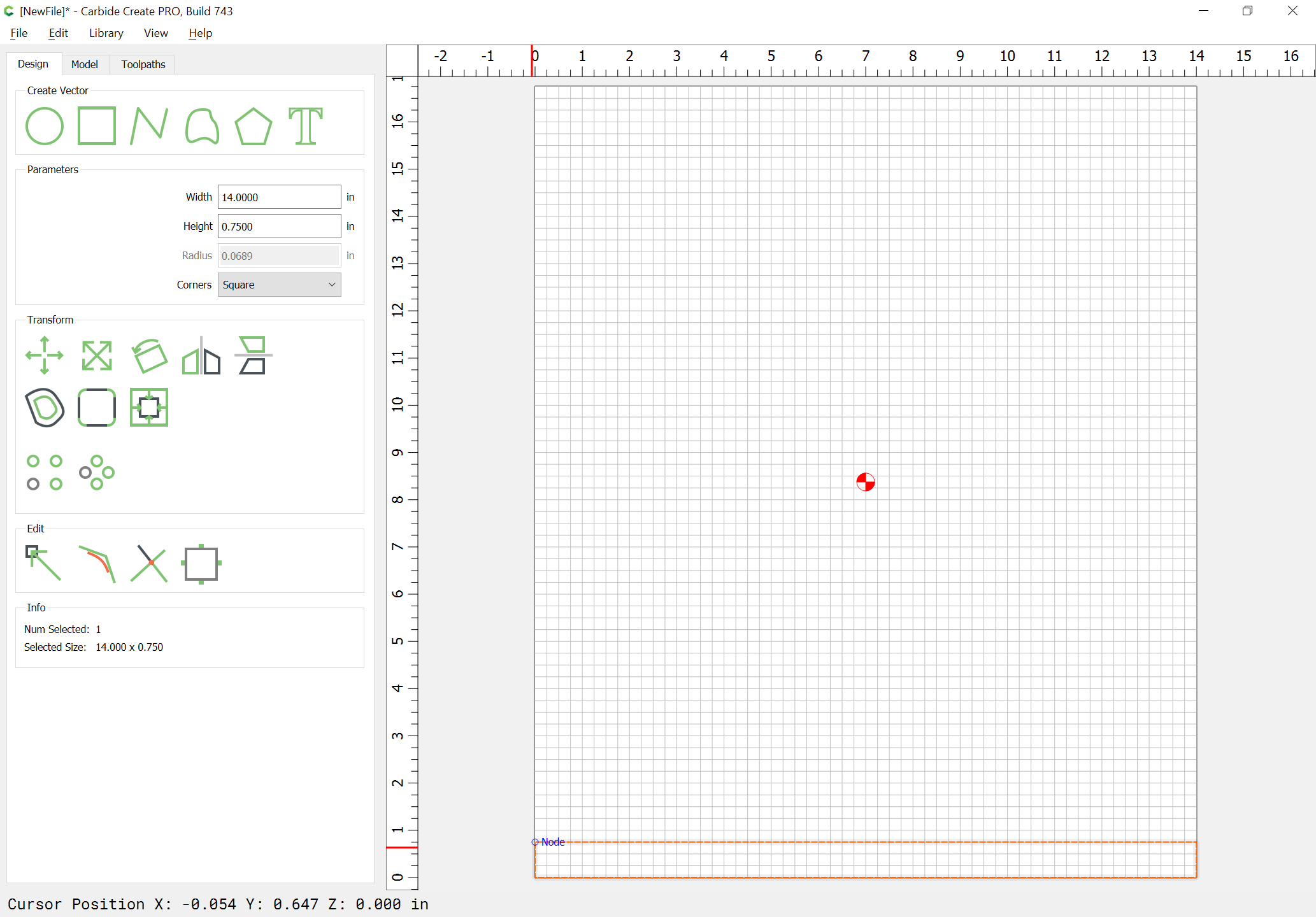

As always, we start by drawing things up in profile:
Then we explode things out to lay the boards flat:
Note that there are two options for the Drawer Face — it can either be a separate part mechanically fastened/glued, or it can be an integral part of the structure — the former should be obvious, so we will investigate the latter here.
Lay out a pair of boards:
sizing the Stock area so that we can focus on just the joinery.
Again, draw in the profile of the joint:
and draw in the V endmill which will be used — this needs to be significantly narrower than the stock thickness — we will use a 1/4" 90 degree V endmill:
Duplicating the V endmills, we can see how multiple cuts w/ the V endmill will be necessary to cut the V chamfer at the top/bottom of the boards:
Trying something a bit different here, we will have the initial cut with the V endmill be only 1/2 its height:
(this should simplify the toolpaths, and get us a bit more surface area for the joint)
Draw in a line as tall as the boards and position it at the tip of the uppermost V endmill proxy:
Align it against the stock:
Assign it to have a no offset contour as deep as:
Create another line along the two boards and assign it a no offset contour at the stock bottom:
Draw in the geometry for the rabbet for the drawer bottom:
and assign it a pocket toolpath to the desired depth:
Change the grid spacing to be an integral of the joinery — we will switch to metric and use 7mm, so 3.5mm — draw a rectangle which reaches from the end of the board to the upper V contour and is the desired height:
Position it centered at the upper right corner of the rabbet:
and use the Linear Array tool to make duplicates of it which define the joinery and extend beyond the top of the board:
OK
Delete the elements which extend too far:
Draw in a zero width rectangle which extends from the top to the bottom of the line in-between the two boards:
Set it to be the same width as the height of the rectangles used for the joinery:
and add that dimension to the height, and round the ends:
Duplicate this in place and Boolean Union (or use Trim Vectors) to combine each copy w/ one set of the joinery geometry:
Assign a toolpath to each which cuts as deeply as is necessary to clear to the bottom of the joint:
and one can adjust the bottom V endmill pass to start at the bottom of that pocket, since the square tooling will be used first, and the V endmill last:
Lastly we determine how to chamfer the top and bottom of the boards:
Halve the tool, and stack up as many duplicates as one wishes to make passes:
and then draw in a box which measures where one wants the chamfering passes to be made:
and scale the collection to that width:
Position it relative to the Layout:
Draw a line which reaches to the bottom of the rabbet from the bottom of the board:
and position it relative to the V endmill proxy horizontally:
and aligned against the bottom of the board:
and assign it a V toolpath which cuts as deeply as the endmill proxy is positioned:
Repeat for the other endmill proxies and we have a preview which pretty much looks like a joint:
Duplicate these at the proper length at the top of the board, then transfer all the geometry to the appropriate ends and you have a set of parts which when cut out will fit together to make drawer sides.
