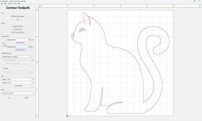

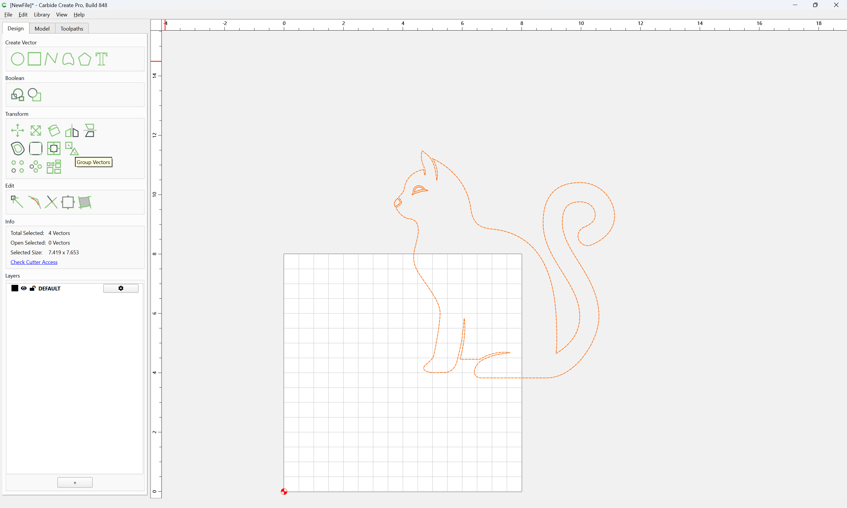

I can’t find a way to VCarve or end mill a simple line without making unnecessary passes in Carbide Create. Trying to add detail to some projects and struggling. Please advise.

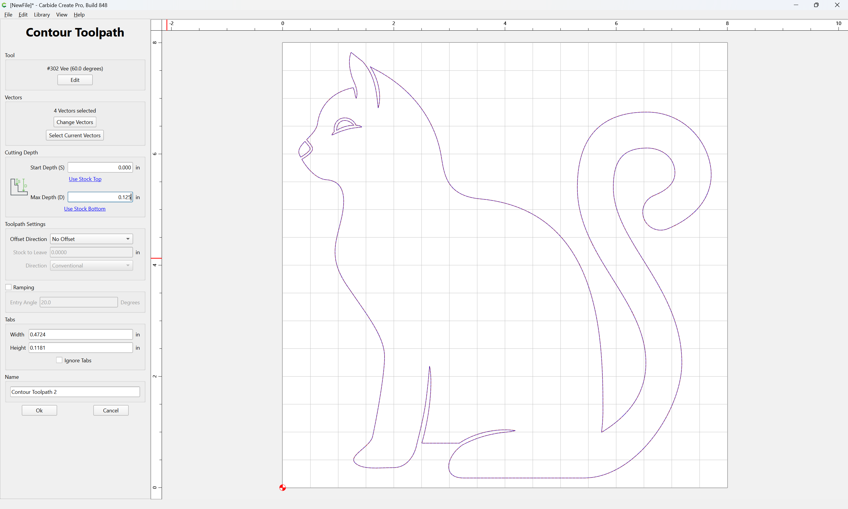

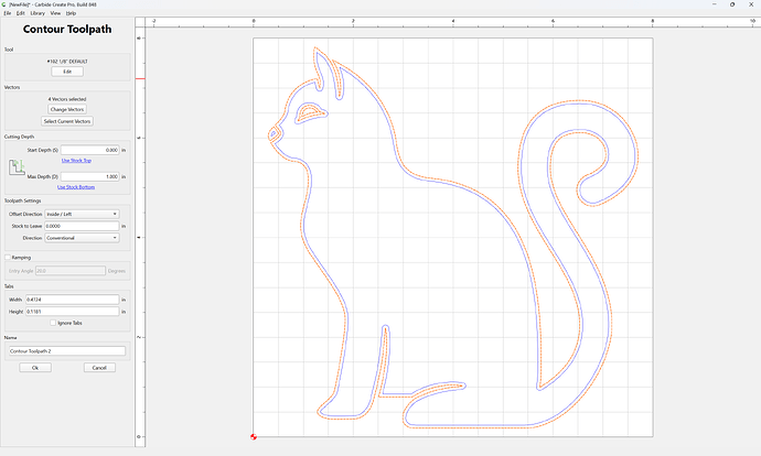

You can use the Contour Toolpath with No Offset to run the bit along either a closed/open vector line/curve/shape. Depending on the DOC & final depth settings, you can set it up to make a single or multiple passes.
Post your project file here, so we can see exactly what you are doing, and see how to accomplish what you want to do.

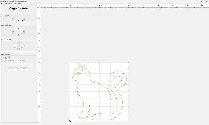

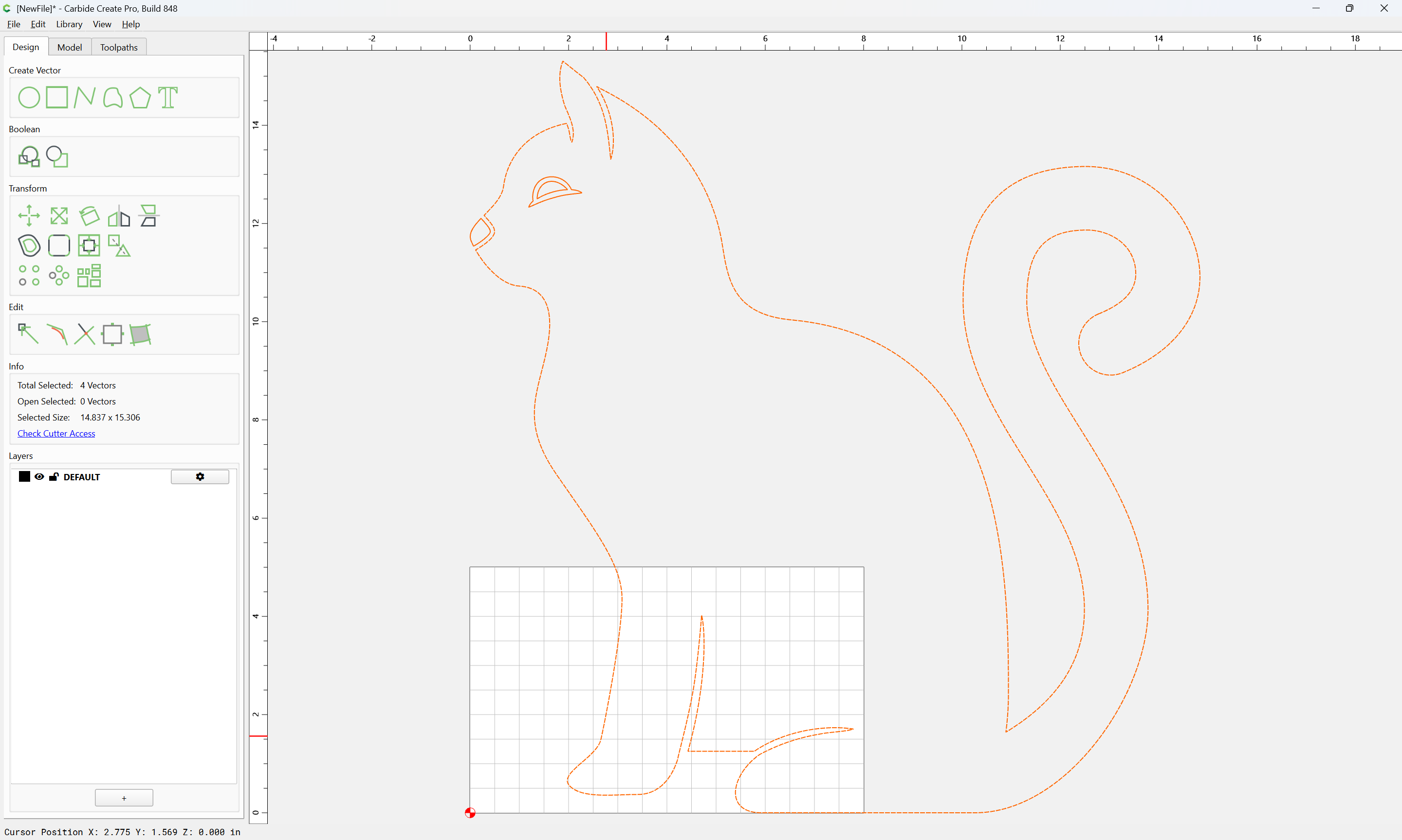

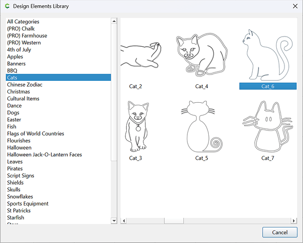

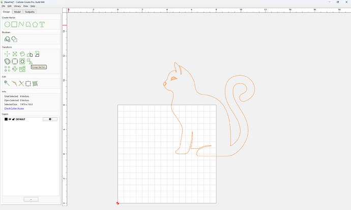

If you have a design:
Done

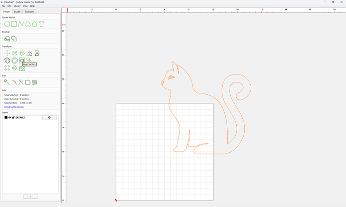

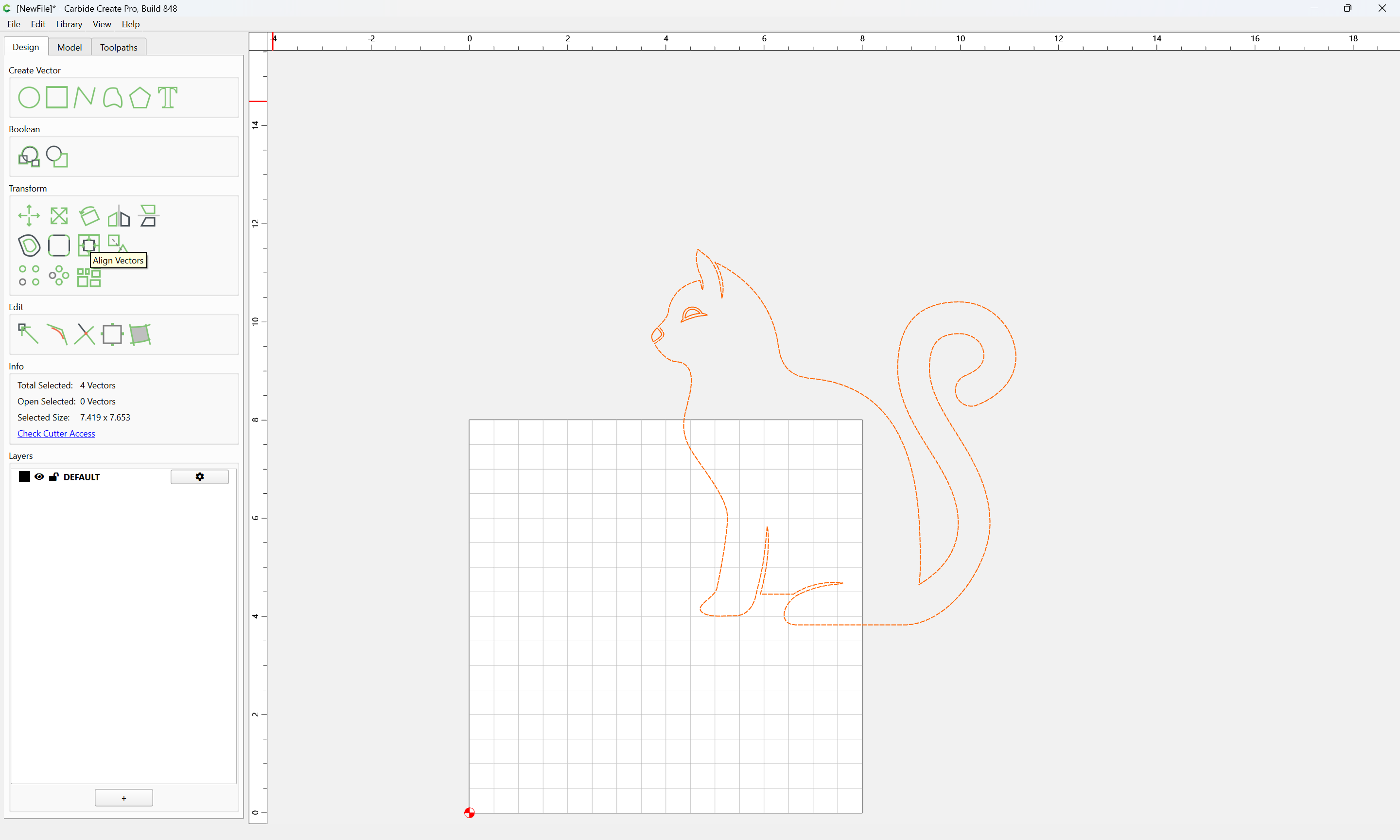

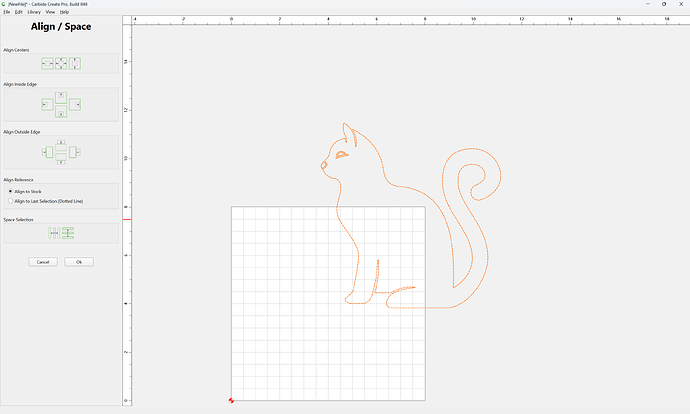

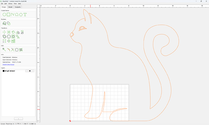

Group Vectors

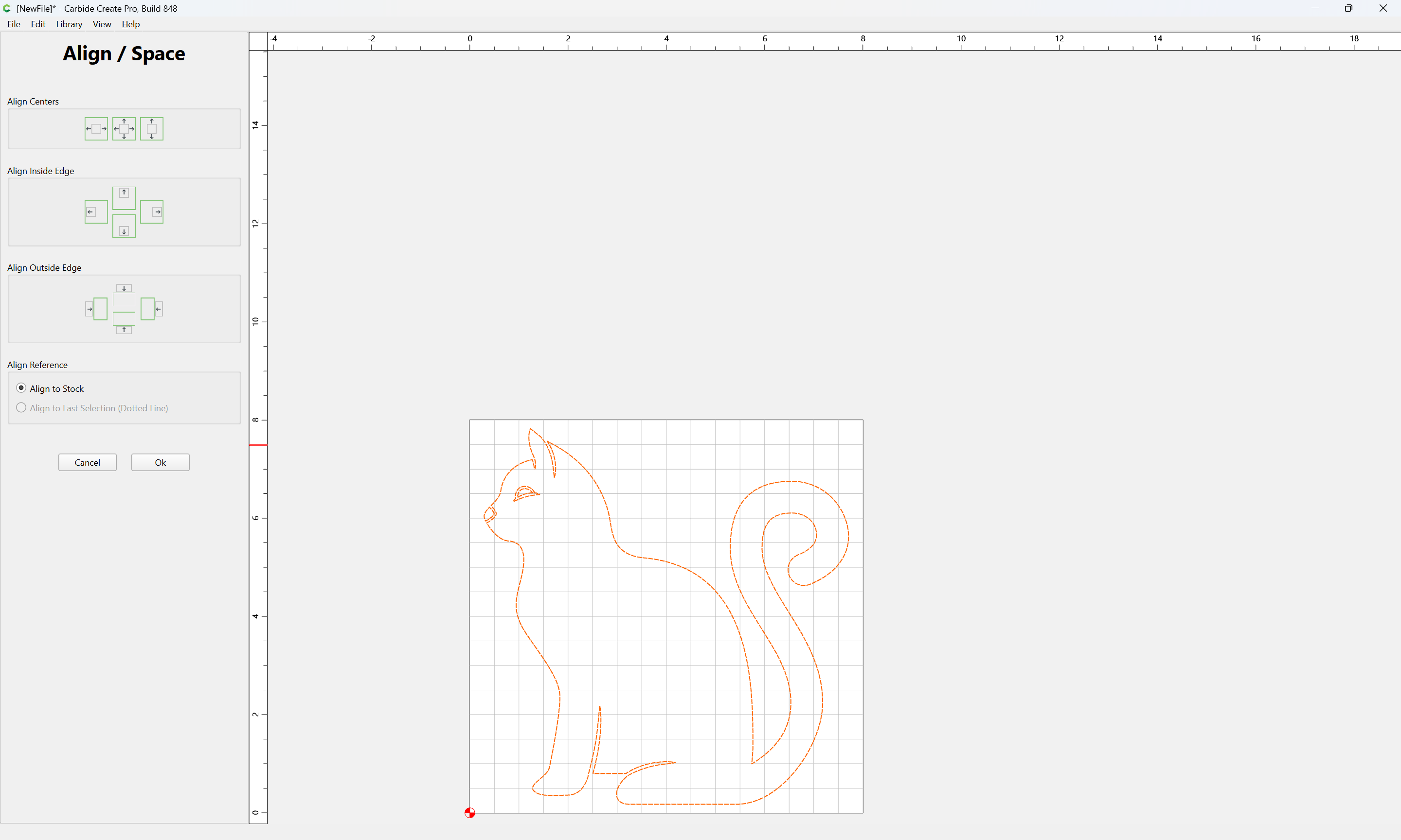

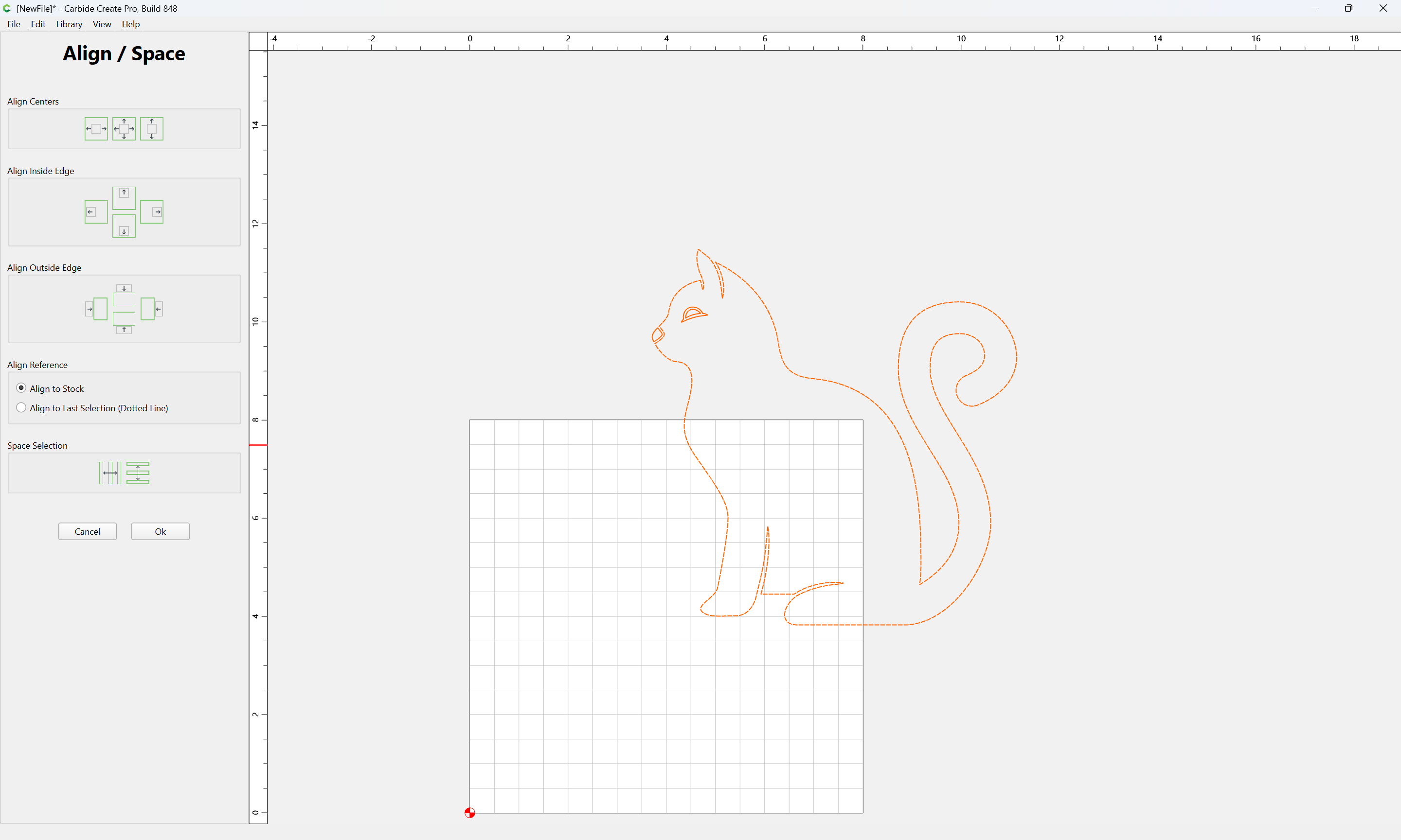

Align Vectors

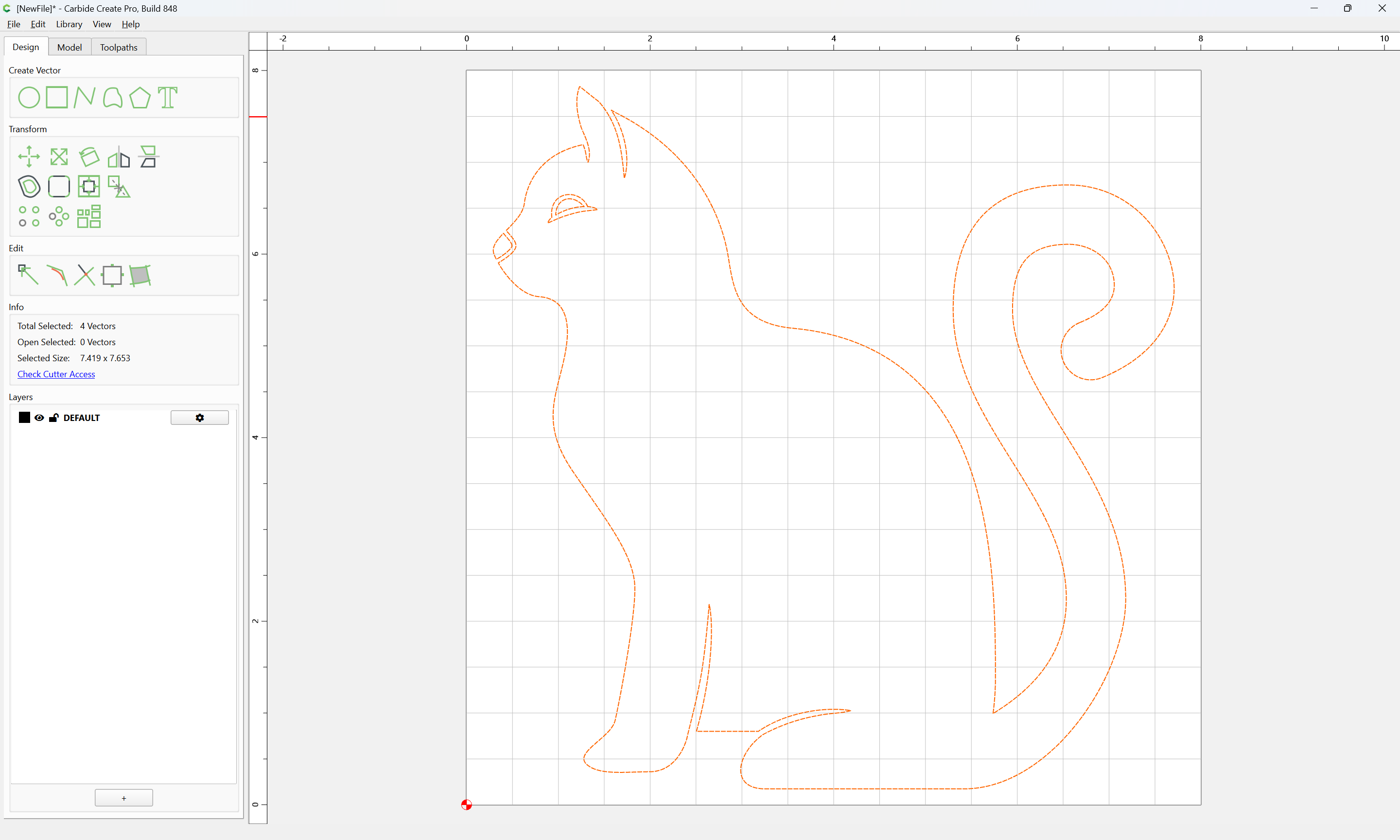

Align to center of Stock
Ok

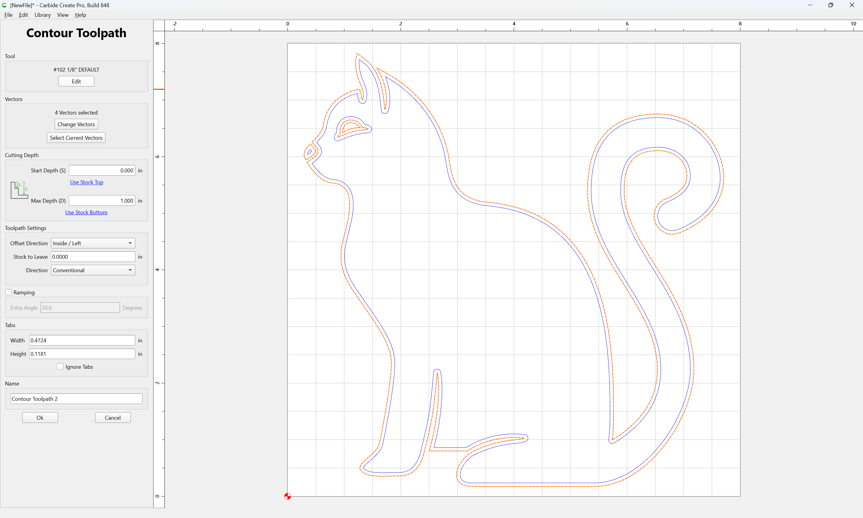

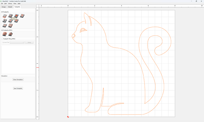

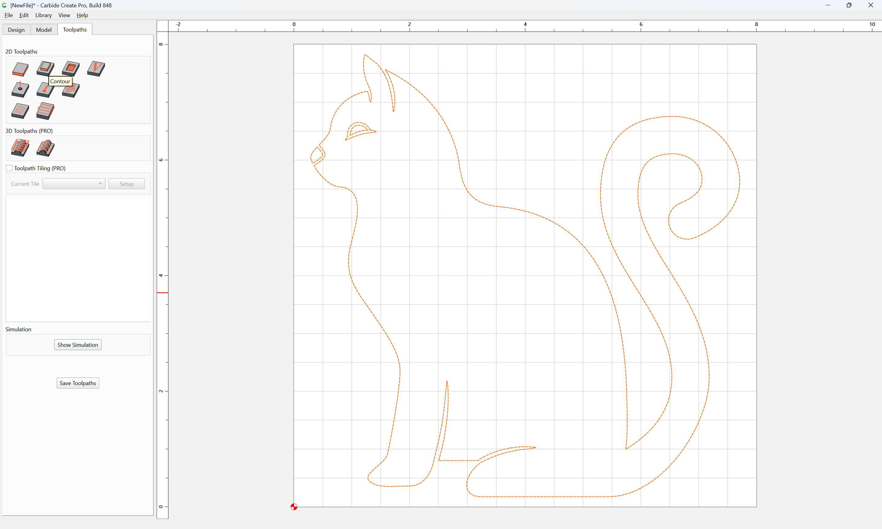

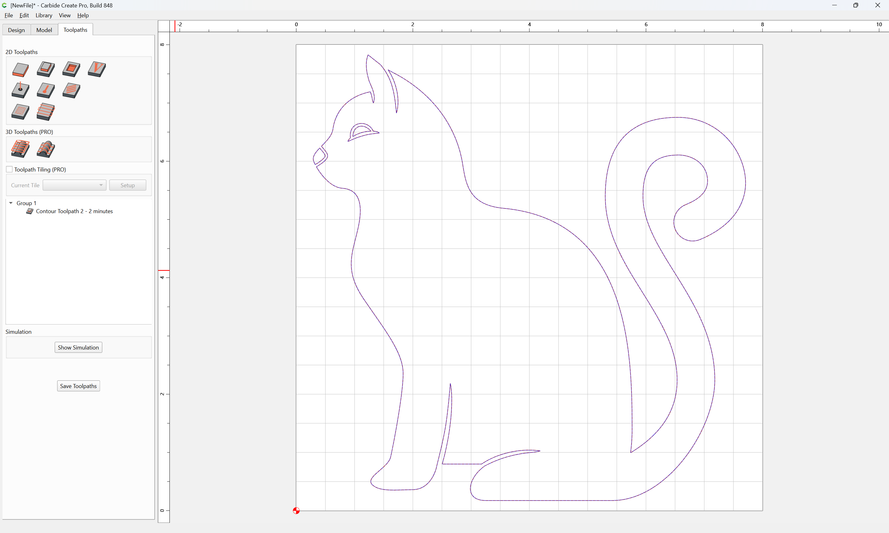

Go to Toolpaths
Contour
Use Current Selection
Adjust the settings:
Ok

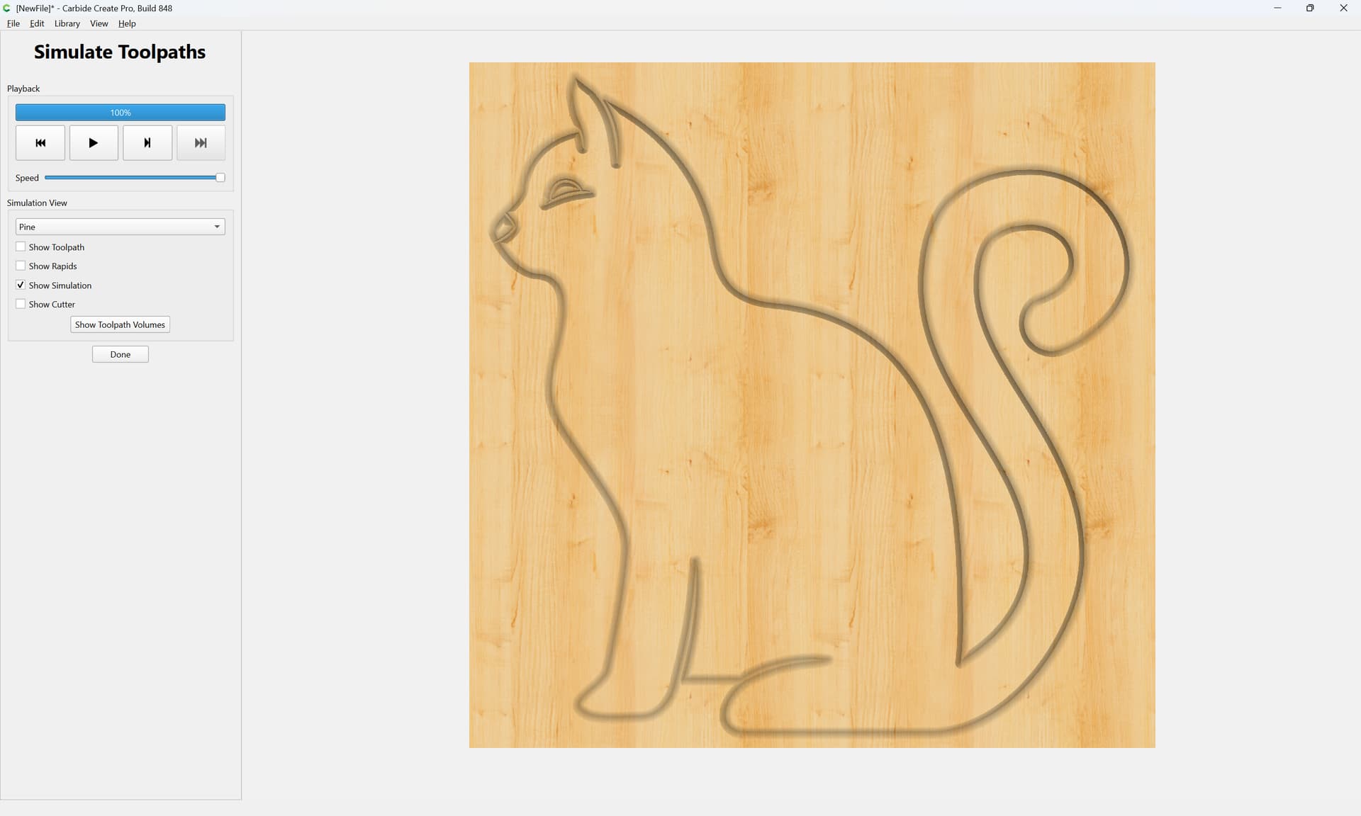

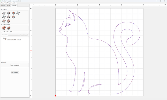

Show Simulation
If that’s not what you want, please upload a file and we will look into this w/ you.
