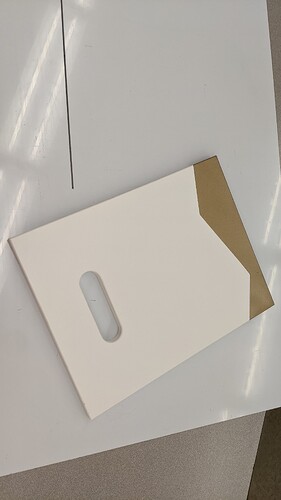

Everything I’ve seen here from @baricl or anyone else is expanded (foamed) PVC.
Here’s a pic I just took of a piece of 3/4" expanded PVC on top of solid PVC sheet.
A sign shop is using an expanded PVC called Komacel or Palight. Search your area for wholesale/trade sign suppliers. Grimco is national and may deliver locally.
