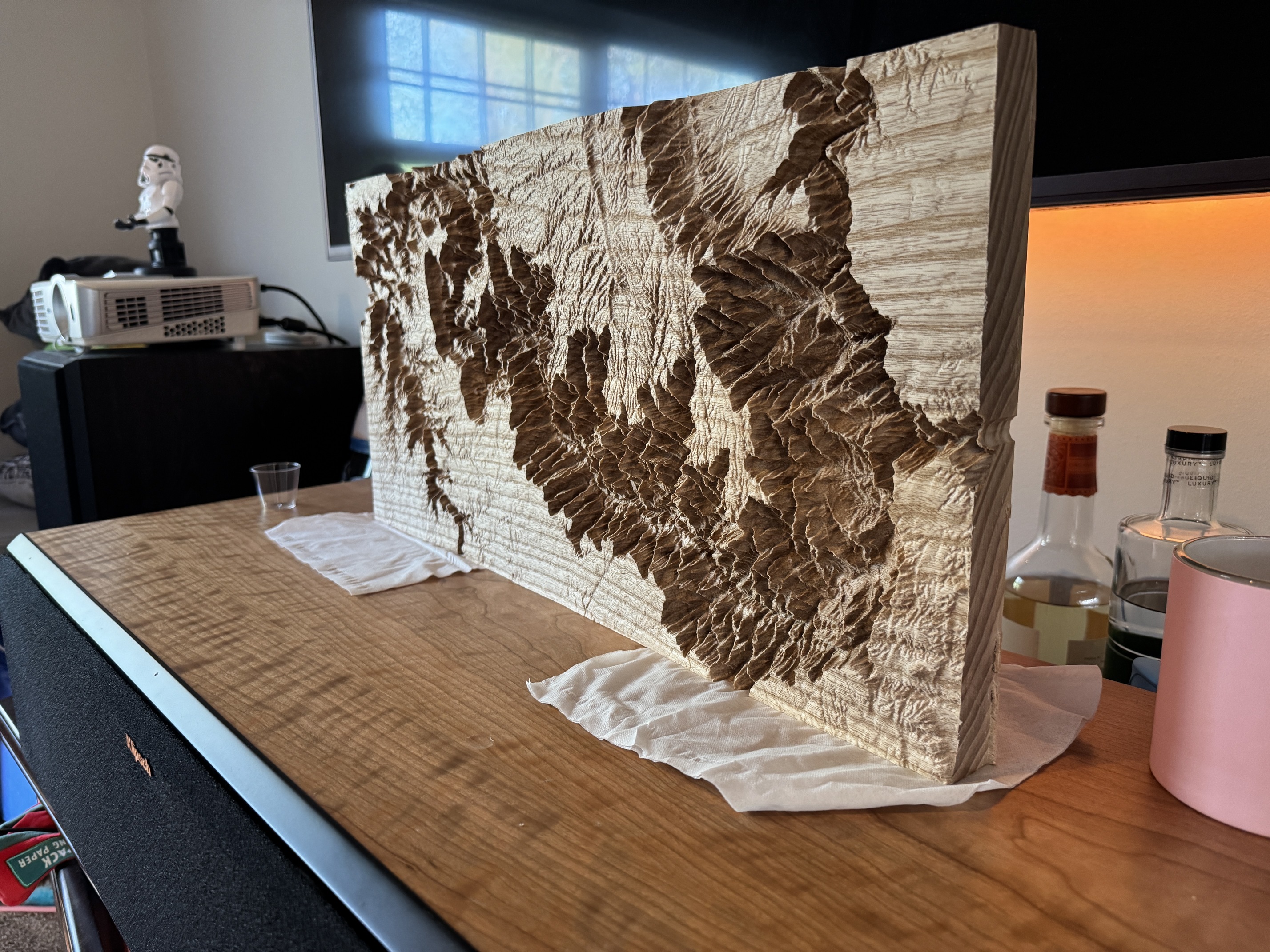

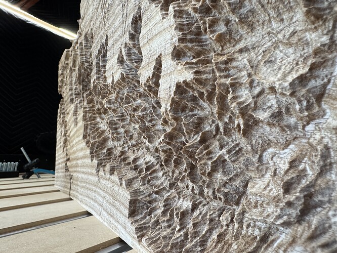

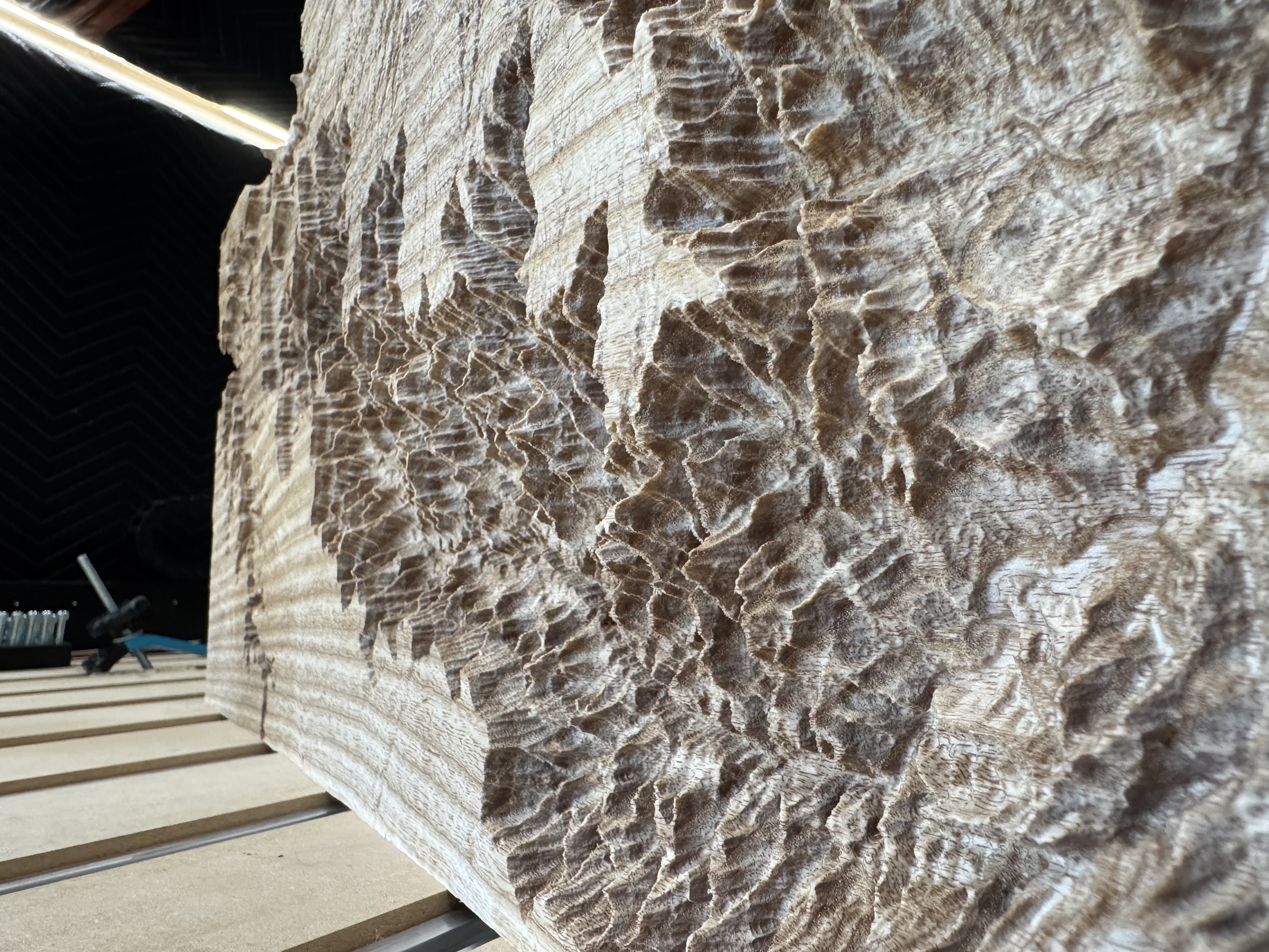

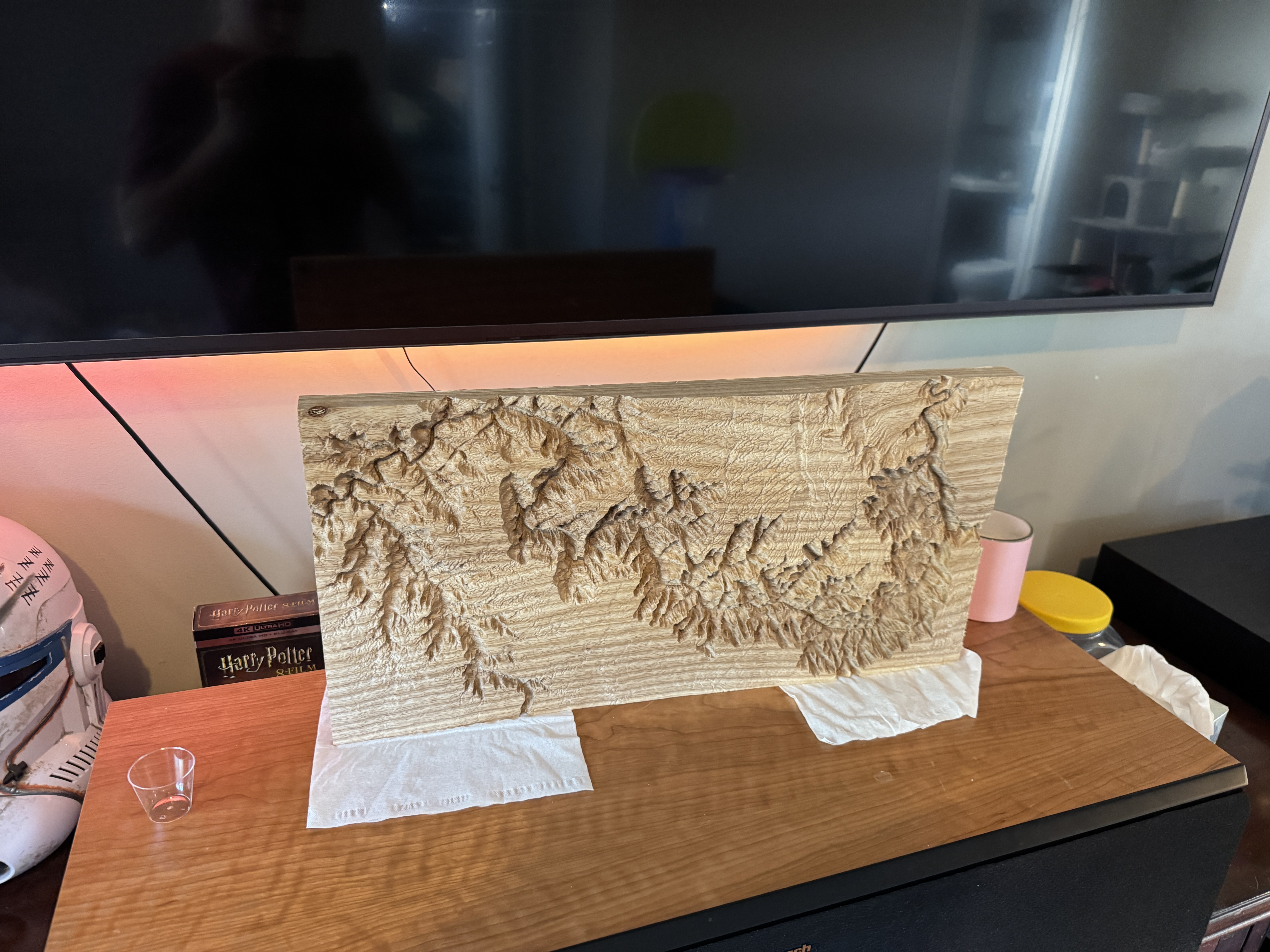

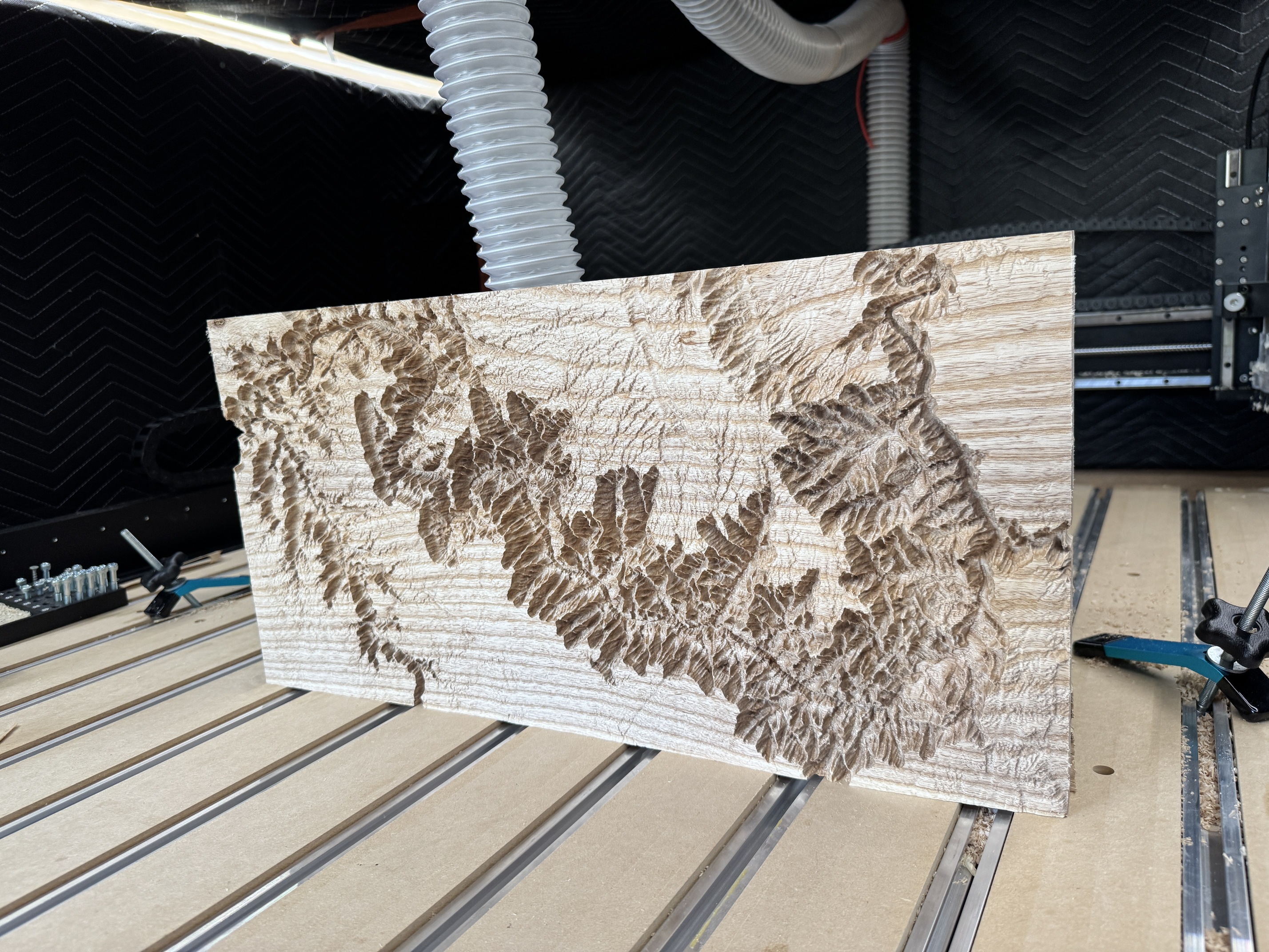

@PerchPerkins35, is that " banding" on the flatter portions of the terrain physical, or just a visual illusion due to the color of the woodgrain? (i.e. if you sprayed it with primer would it be flat?) That is an impressive piece in any case…
That “ banding” is the physical wood itself and ain’t from machining. I used a 1/16” diameter ball nose tapered endmill with a 0.005” stepover

I made a finishing toolpath for the Grand Canyon and fusion 360 says it takes 12 hours but shapeoko software says 16 hours. If I could get a large map like this down to a day for finishing then I would be in great shape,
Finishing is 0.005” stepover, 200 iPM, 1/16” diameter tapered ball nose endmill.

It is so weird–now knowing for a fact that the level areas are smooth, my brain still cannot stop interpreting the grain as shadows being cast by furrows… :man_shrugging:
