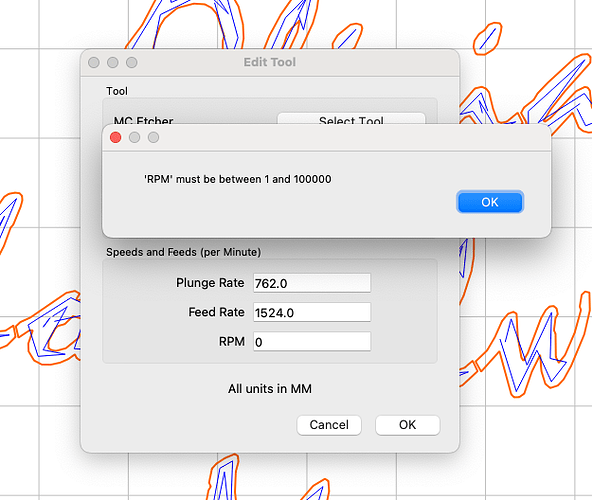

Hi All,
I was under the impression that with the new CC and CM builds, when you chose McEtcher as your tool, the 0 rpm setting is automatic but I still get this:
Do I still need to edit the gcode file?

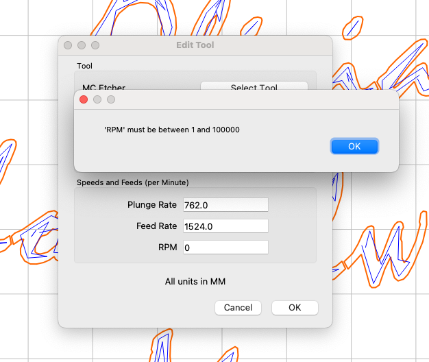

Hi All,

What happens if you MDI M03S1 on the machine?
The latest CC V7 build should allow an RPM of zero for the contour toolpaths, which are typically used for engraving. (CC Pro also has a dedicated Engraving toolpath with fill options)
When setting up the etcher you have to set the RPM at least to 1 but you don’t have to turn on the router. At least on older versions of CC. Maybe 7 is different
