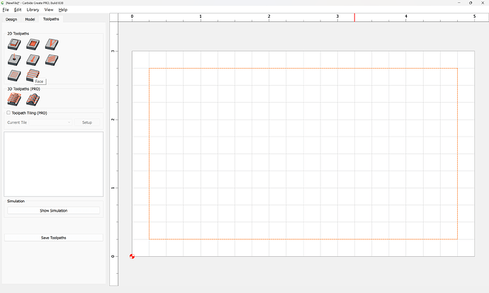

You can use the new Facing toolpath, or you can draw the toolpath yourself & use a contour with no offset to follow it. I like to start off the material so it’s all straight cuts.

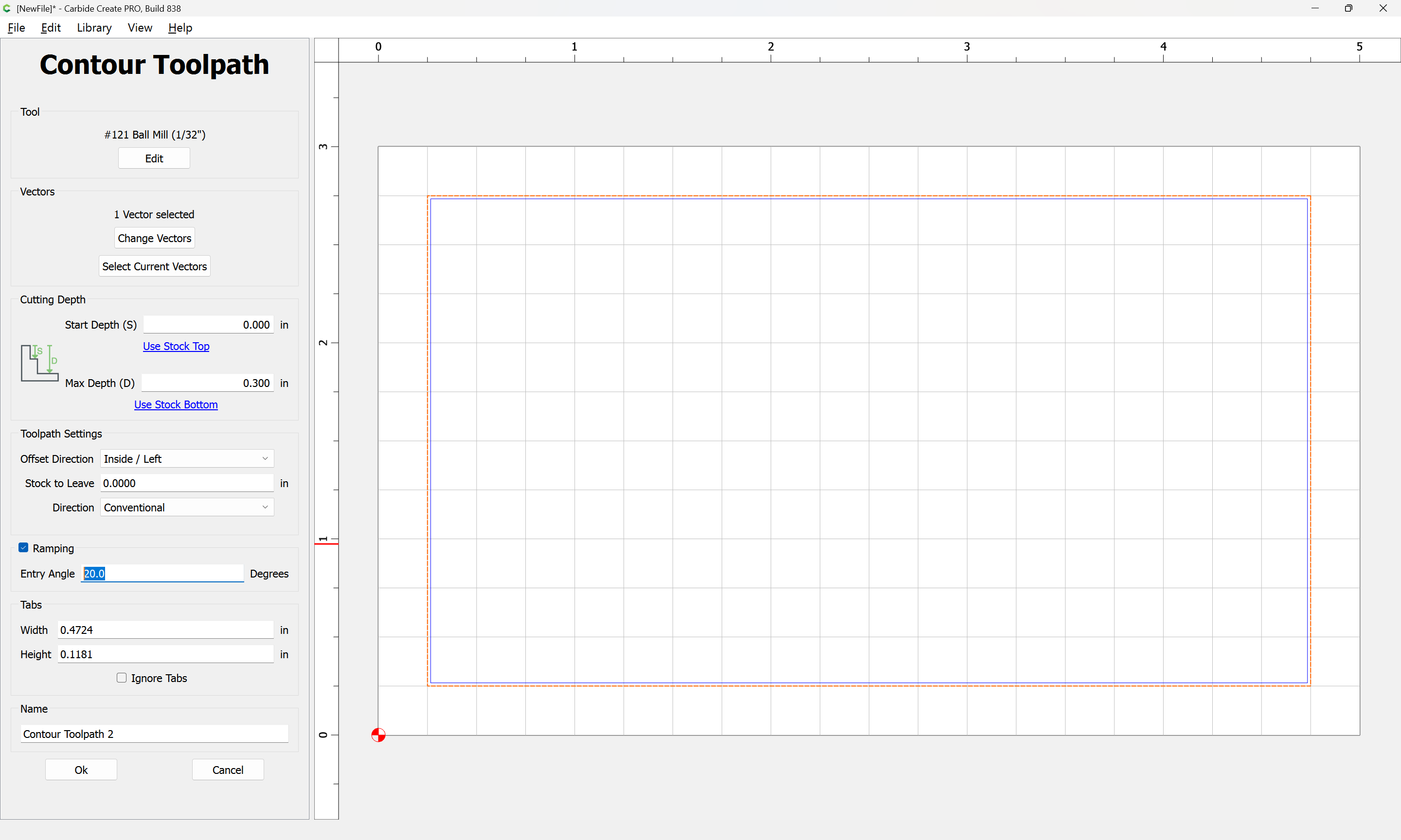

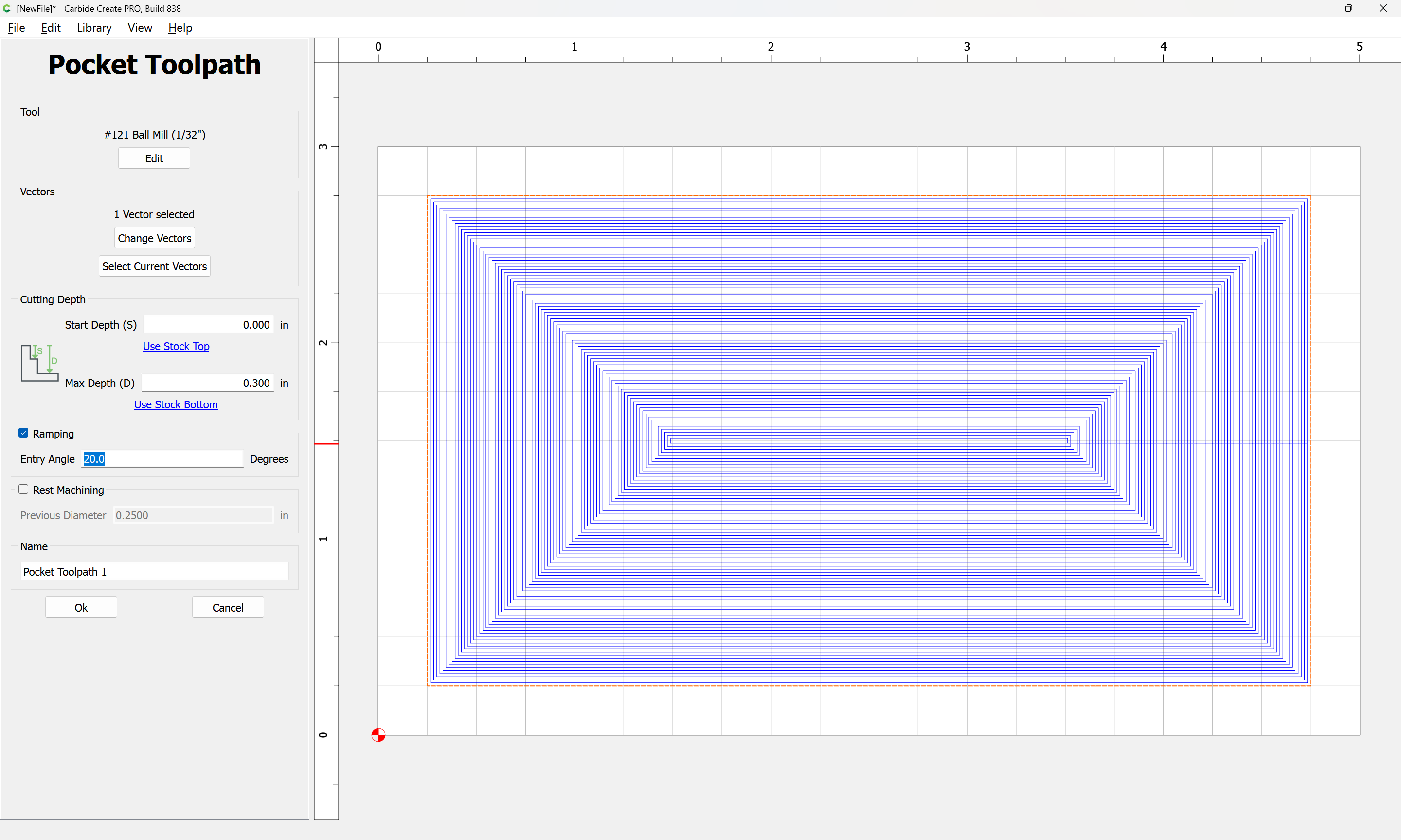

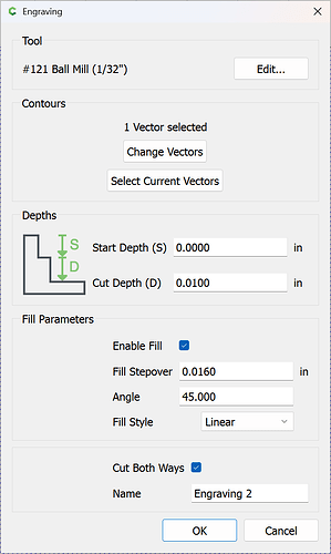

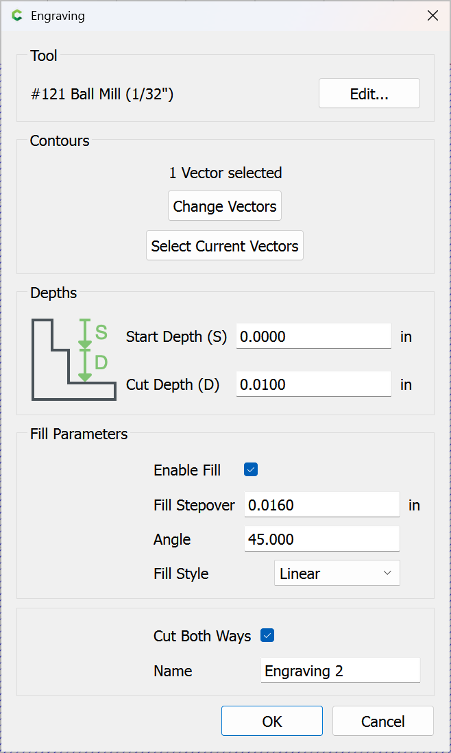

Is the Facing tool path part of Create Pro? I only have the free version and haven’t heard anything about the Facing tool path. I searched the Carbide Create Pro page and couldn’t find any info about it as a new feature. I’m wondering what other new features there are, that aren’t listed, that would make it worth paying for?
Yes, Facing is a Pro toolpath:
There is also Engraving:
and Stock to Leave/Direction control:
and for Contour and Pocket toolpaths there is Ramping:
in addition to 3D modeling and 3D toolpaths.
EDIT: also, Tiling is a Pro feature…
